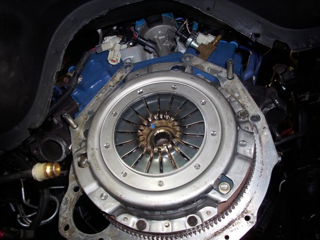

well last night i did like Kyle M. suggested and pulled the oil cap off and ran it, but it still leaks. i crawled under it with my UV light and could see where the oil was dripping off the left rear pan bolt and then hitting the starter and running off onto the floor. i looked up into the bellhousing through the insection hole but all i could see was a whirring clutch pack. im fearing it might be a broken main bolt, since it seems to leak on the left side of the seal the most. i want to drive it so bad its driving me crazy!

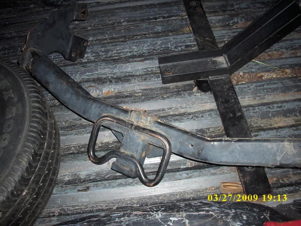

so i came into work today and was greeted by this awesome gift. one of our customers had been in on the weekend and he and i got to talking about rangers and i told him i was building one and then i showed him some pictures of how far i had gotten on it. then he told me how back in 94' he had bought the exact same truck and still had it but his son was driving it, since he had also just bought an 08 FX4 level II which he was eager to show to me. we talked for a while longer and then i got him his parts and he left smiling. this morning before i got to work i guess the guy showed up and dropped this off for me, its pretty much brand new and it looks like he jsut took it off and put it up in the rafters for storage.

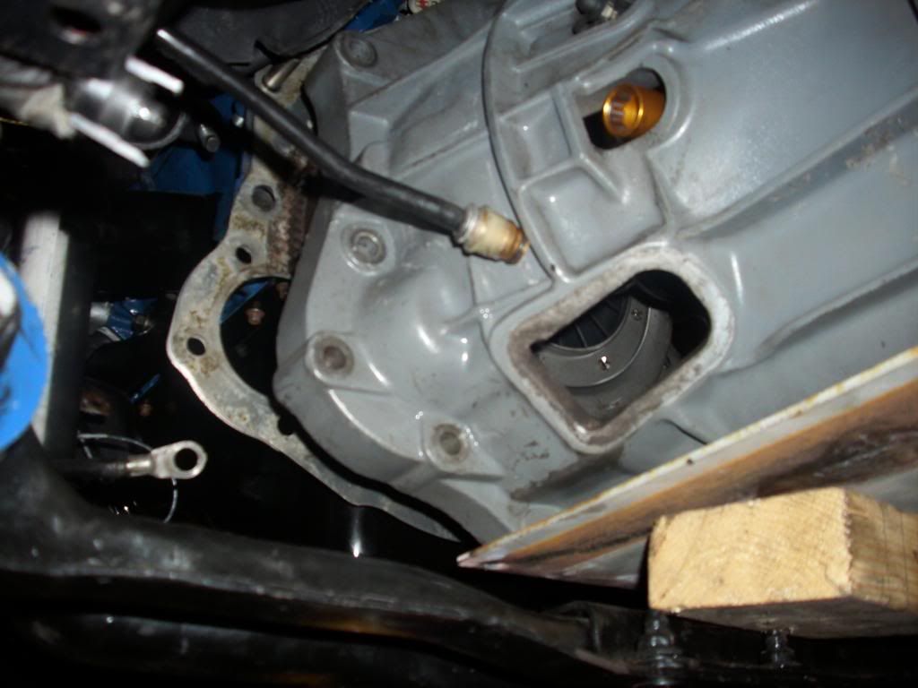

I found some extra time last night and finally got around to pullin my trans again and replacing my rear main seal for the 4th time. i also got my second battery tray brakcet painted and installed for good, now i just need a 59 series battery to fit in the tray properly. after i installed the seal using my homemade tool (which worked great as long as i tightened the bolts in steps equal to one another), i started cutting apart my transmission jack plate to redesign it so that hopefully i can install and remove this thing all by myself. the idea is to set the trans farther forward on the plate so that the trans and engine mate up before the wheels of my two floor jacks touch. heres some pics:

I bought two seals this time, one is the original single lip seal with the spring on the back side, and the other is a double lip PTFE seal which had no springs.

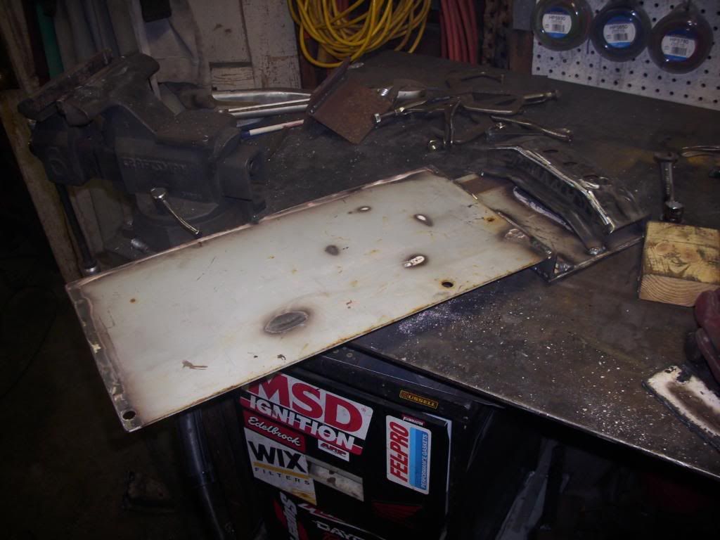

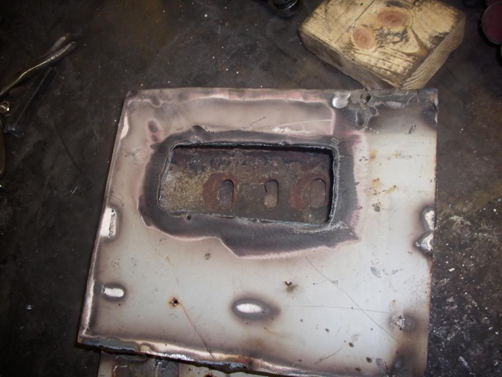

heres my trans plate, it just looks like a burnt piece of metal, but the next time i post pics it should be pretty functional.

i got my trans plate made last night as well as some brackets to hold my shovel in the rescue ranger. everything turned out well on the adapter plate except for my jack wheels are still touching before my engine and trans mate together, so im going to have to move my cup back a couple of more inches.

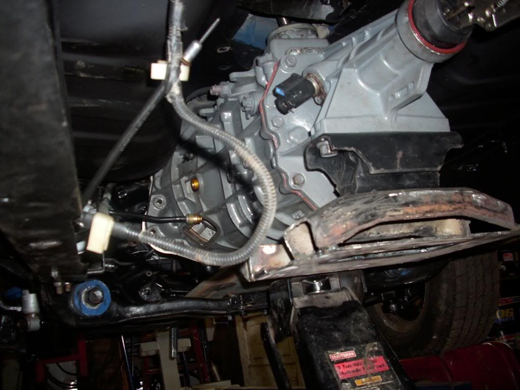

on tuesday i put the transmission back in all by myself! i got so fed up with my floor jack wheels touching each other and keeping things from going together that i pulled out the engine hoist and chained up my motor so that i could remove the jack from under the oil pan. after doing that my transmision adapter plate made easy work of an otherwise tough task. despite my small personal victory with the trans, when it was all said and done, its still leaking! its not coming from the seal though, which leads me to believe that its leaking through the pan gasket. to be more specific, i think that its leaking between the main cap and the block and the oil is being forced through the pan gasket at the rear bolt. im going to go through the motions and pull this sucker out again on my next day off. ok, enough chit chat, its time for more pics!
