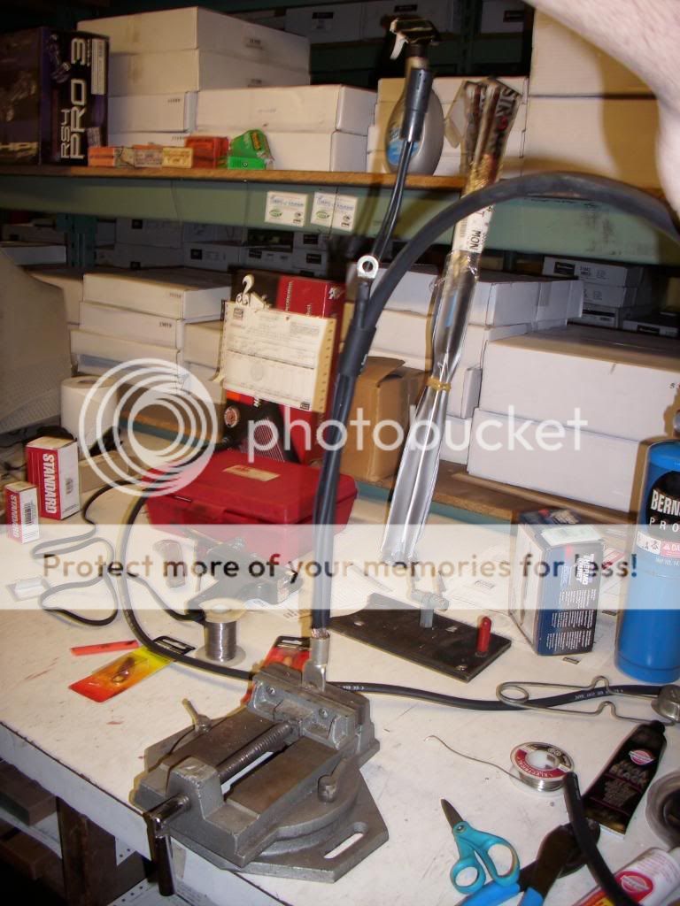

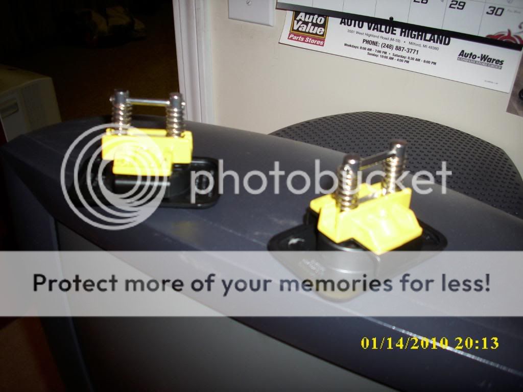

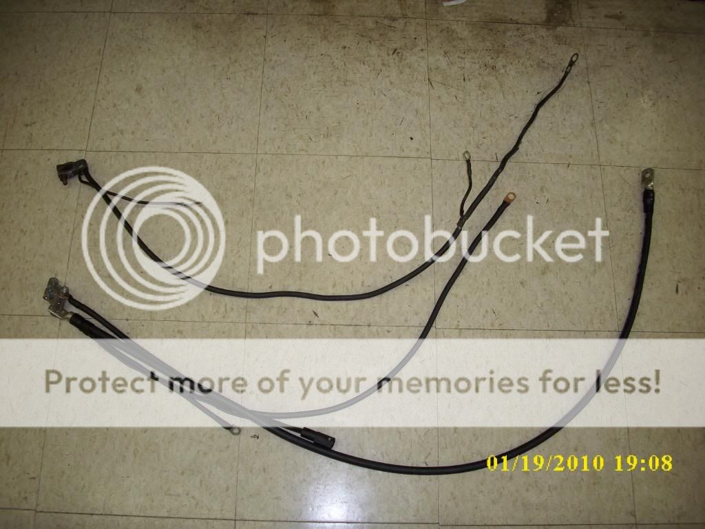

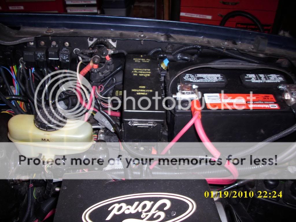

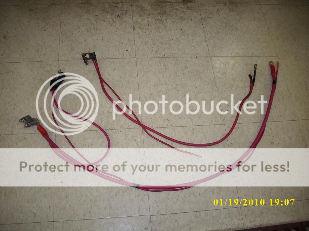

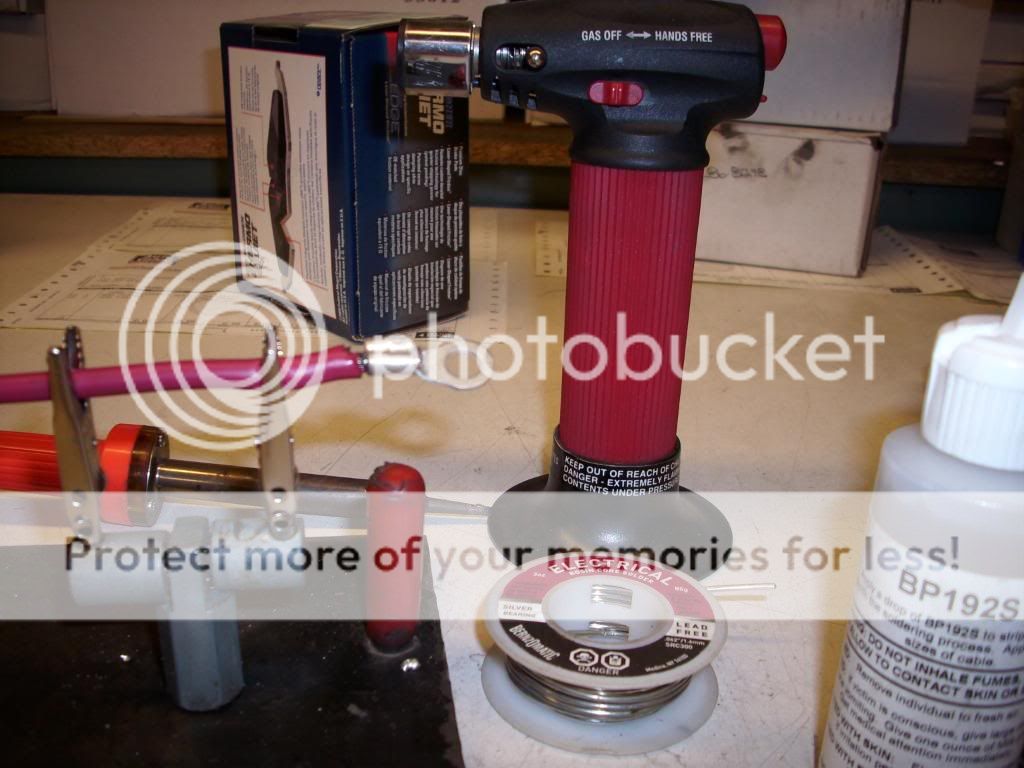

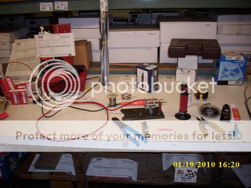

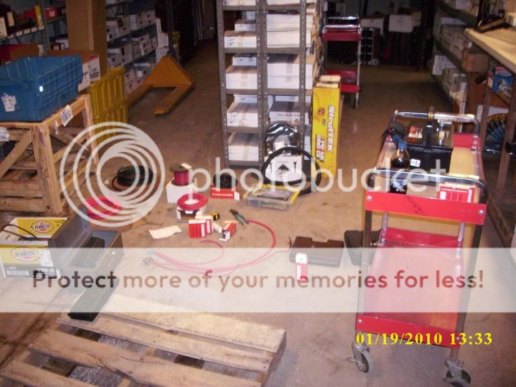

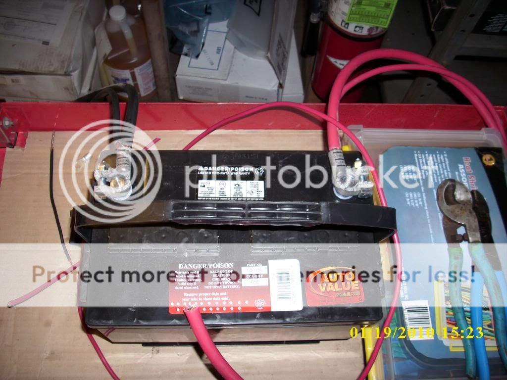

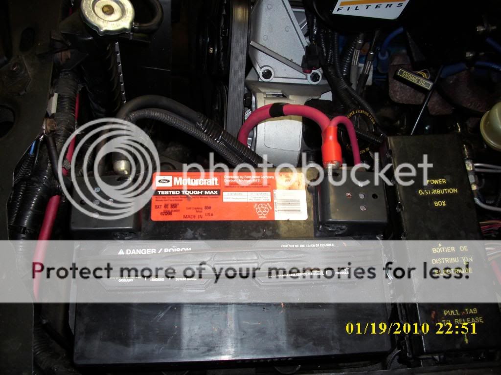

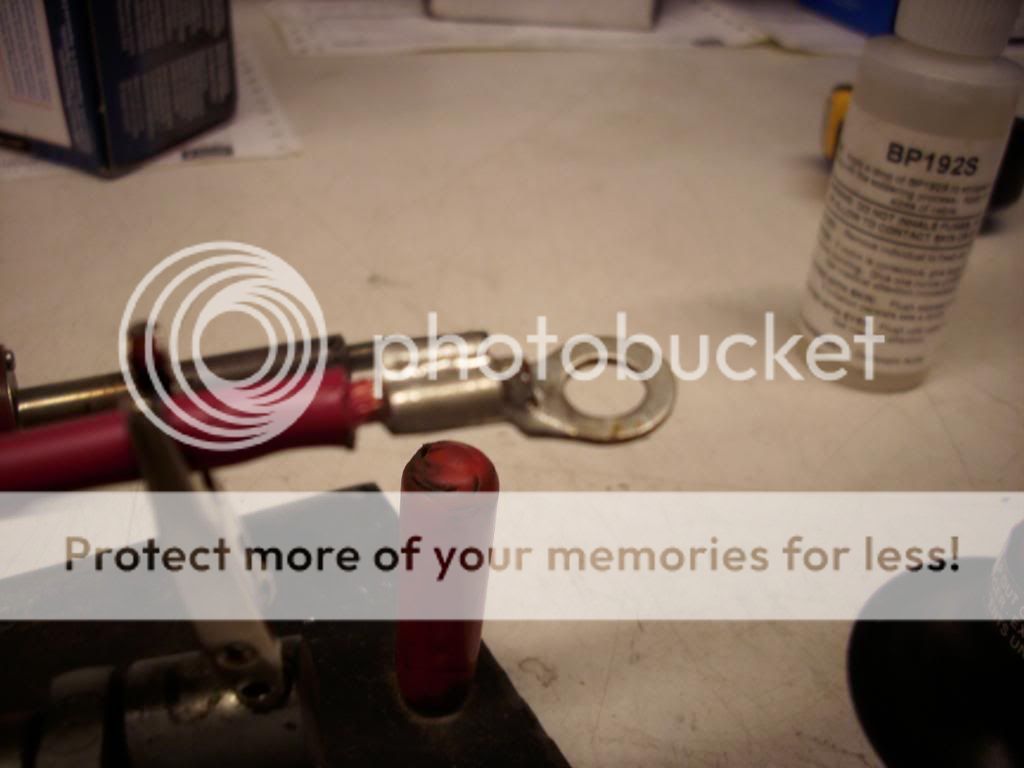

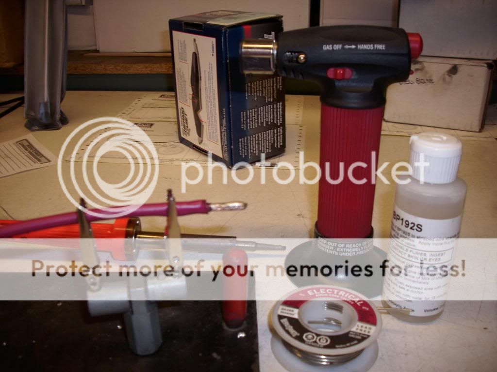

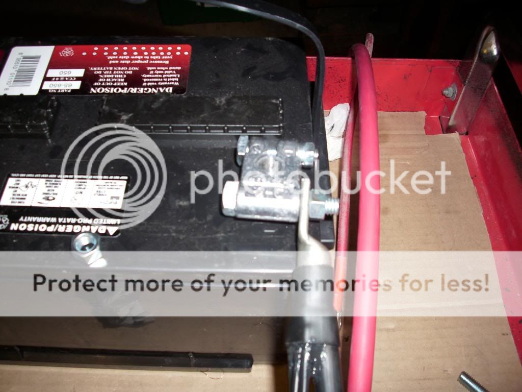

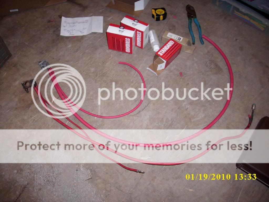

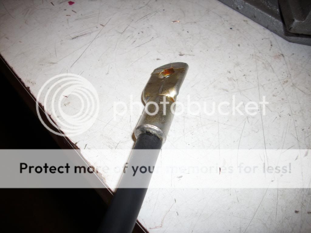

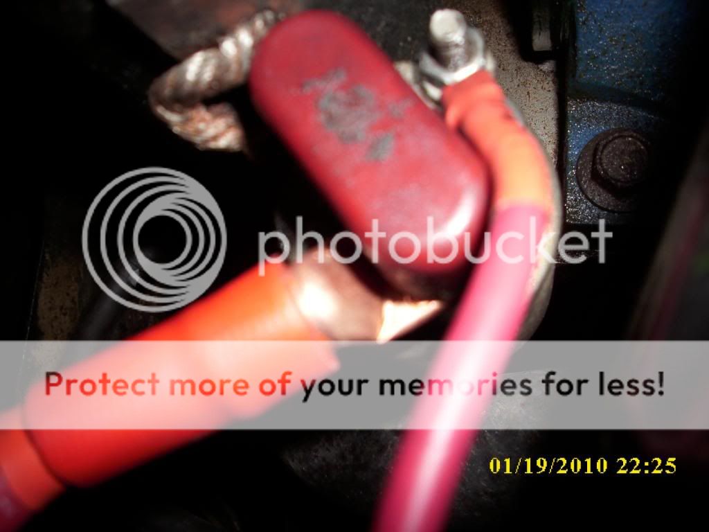

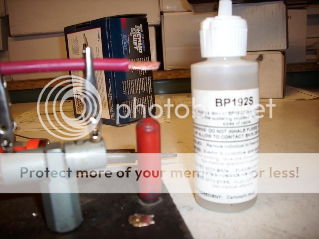

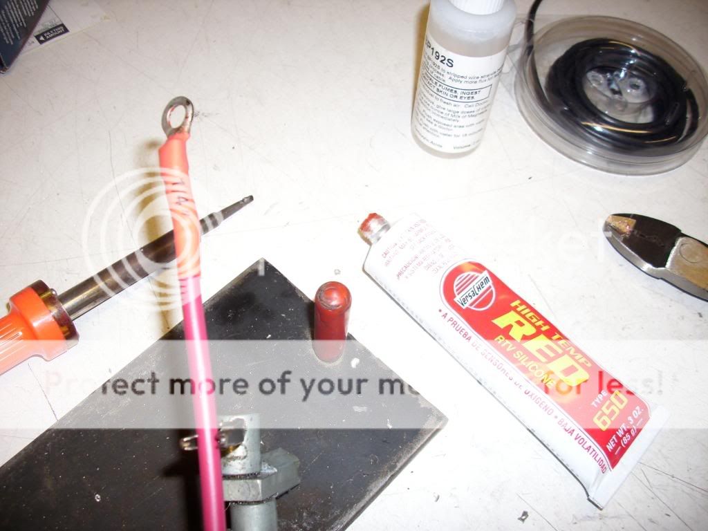

i got the cables made up yesterday, i definitely got my fair shair of soldering practice in for the year. when i made the new cables i doubled the size (Gauge) of each wire, so the 4GA. became 2GA., the 8GA. became 4GA, and the 10GA. became 6GA. i was originally going to use solder on battery terminals, but when i went to pre assemble the ground side there was just too much cable to fit into the terminal, so i went a different route and used military grade terminals and soldered eyelets to the ends of the cables. i figured this way i can easily add more accesories to the battery later, such as a winch or amplifier for my stereo. Ok, on to the pics!

when it was all said and done i ended up spending 9 hours building and installing (some bull shitting and lunch time was included) and i spent $65.09 on materials to build both cables!

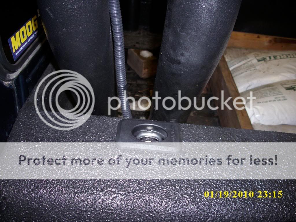

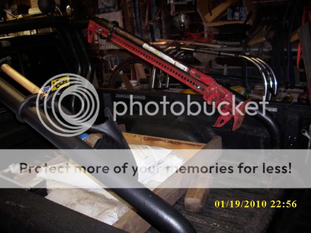

I also installed the front bed pocket bull rings, which required removal of the roll bar, but with my prior planning (using the bed bolts to secure it) it came apart quickly and easily.
ForOffRoadDriving's 94 Ranger Build
having the bed liner gooped in the pockets made this a rather big pain in the ass, but after the first one finally went in i had gotten the hang of how to wiggle and twist it and the second on was a breeze.

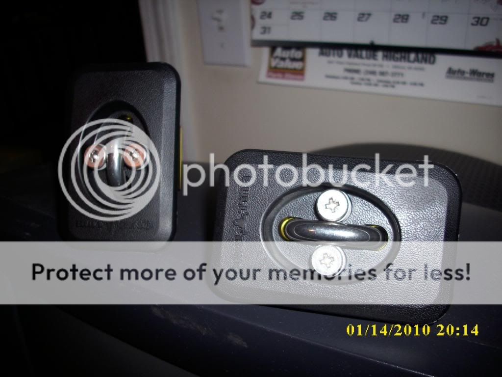

i got another set of the bull rings for the front bed pockets today, but i need to remove the bolts on my roll bar and lift it up about 6" so i can wiggle them into the holes.

Where did you get those bull rings from and how much where they????
oh okay and thank you very much and you really have a nice truck !!!!!

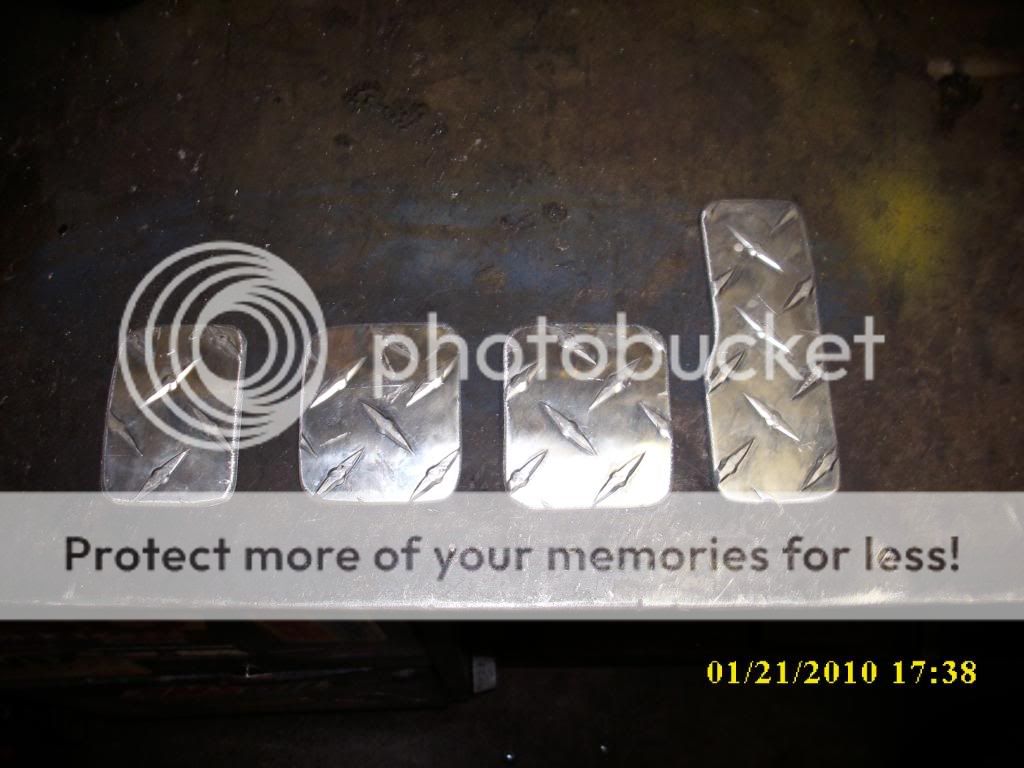

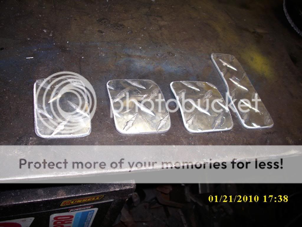

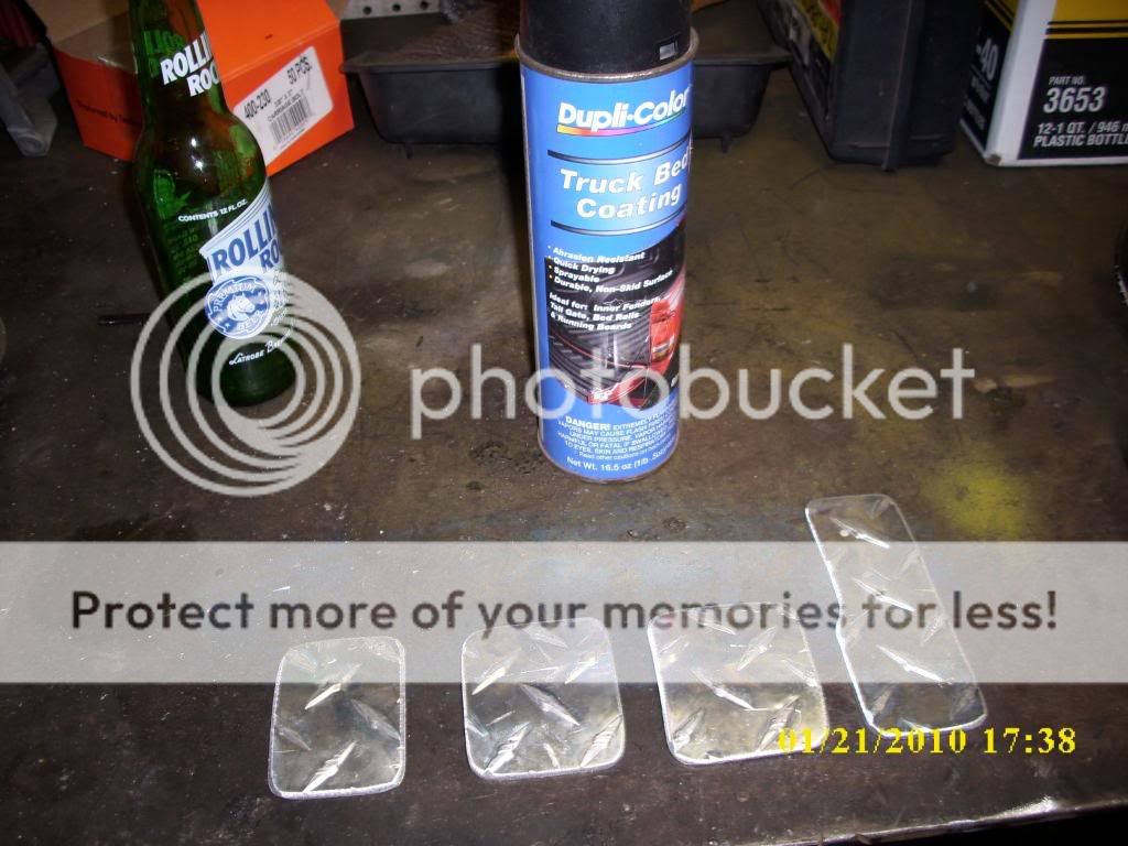

thanks for the compliment dooms day, i did make a small amount of progress on an otherwise lazy day off. i smoothed out the diamond plate pedal pieces and also contoured them to fit well. i plan on painting them with duplicolor spray on bed liner to keep them grippy in wet conditions.

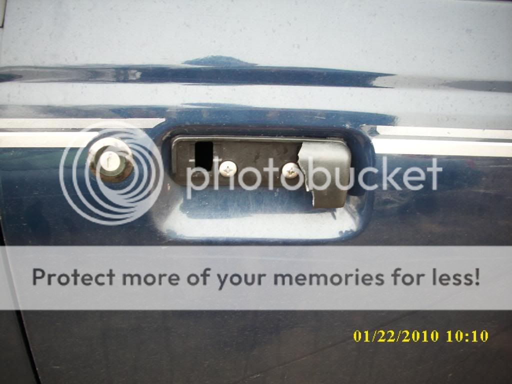

i stayed over at terras last night and when i got home i noticed that my passenger side door handle had been busted off! someone wanted in my truck and was dumb enough to think that iff you pull hard enough on a locked door you can get in.....WRONG! now i have to get a new handle and spend my time putting it in while trying to figure out how to use my dual battery set up to shock then next F***ker that wants to try to get into my truck.

I'd just replace the door handle and not worry about it. There's easier ways into a ranger than the door hole trick. I can actually get my ranger open and started in under a minute without the key, and it's in perfect mechanical condition. Mods fear not, I have no intention of posting these methods on the open forums. Best thing you can do is keep any reason for them to break in out of sight.
i got new OE ford door handles coming in on monday, theyre $30 a piece (compared to the cheap $3 taiwanese ones i had put on previously) and ill be able to get them on monday, so i should have more pics then. i think they were either jealous of my truck and wanted to break it or they wanted the empty box of camels on the floor? ****ing kids!

if youre talking about the lock itself that you put the key in i believe its like a tool box lock (if youve ever seen the back side of one), its just got a little U shaped clip on the back side that holds it in place. ill explain it as if youve never taken the door panel off so i dont skip a step. in oder to access it you need to roll the window all the way up, then pull the plastic back on the window crank and use a T20 torx to remove the screw that holds it on, then remove the 2 screws in the bottom of the door panel, the 1 in the arm rest, and the 1 in the plastic trim around the interior handle. use a panel popper or large flat blade and work your way around the door to pull the 'christmas-trees' loose, then lift up on the panel and it will come off. there will be plastic covering the door so you can either try to peel it off gently or tear it off and throw it away (ive done both and recommend being gentle and re glueing it afterwards). you should now be able to access the back side of the lock, unless the rods from the latch are in the way, then youll need a T27 to take the 3 bolts out of the latch from the jamb side of the door. this will let you push the latch mechanism out of the way and the rest should be an easy swap out. hope this helps you out a bit.

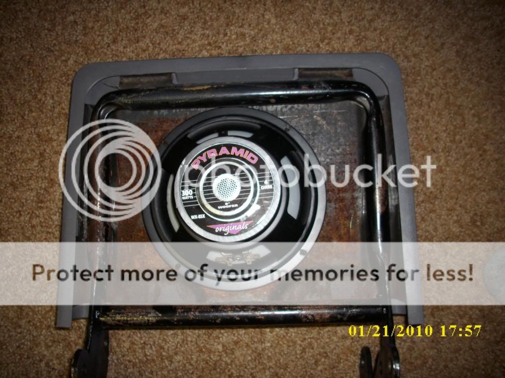

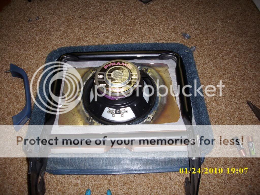

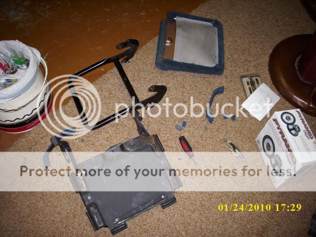

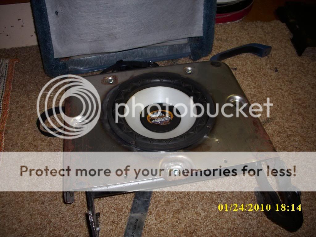

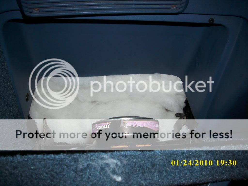

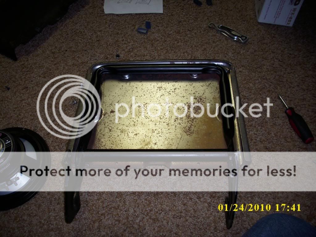

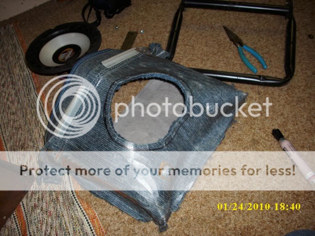

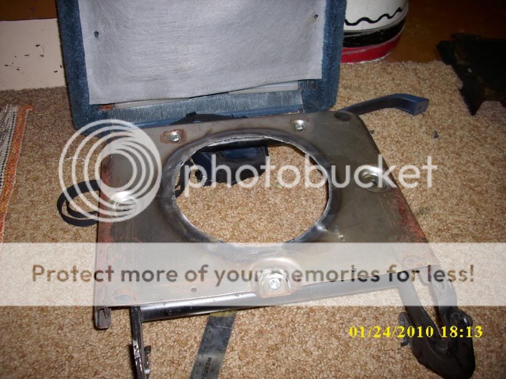

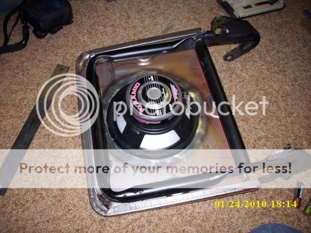

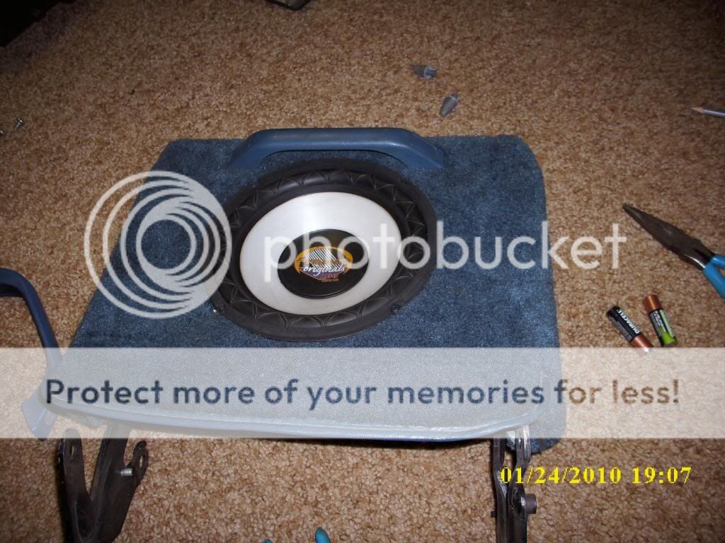

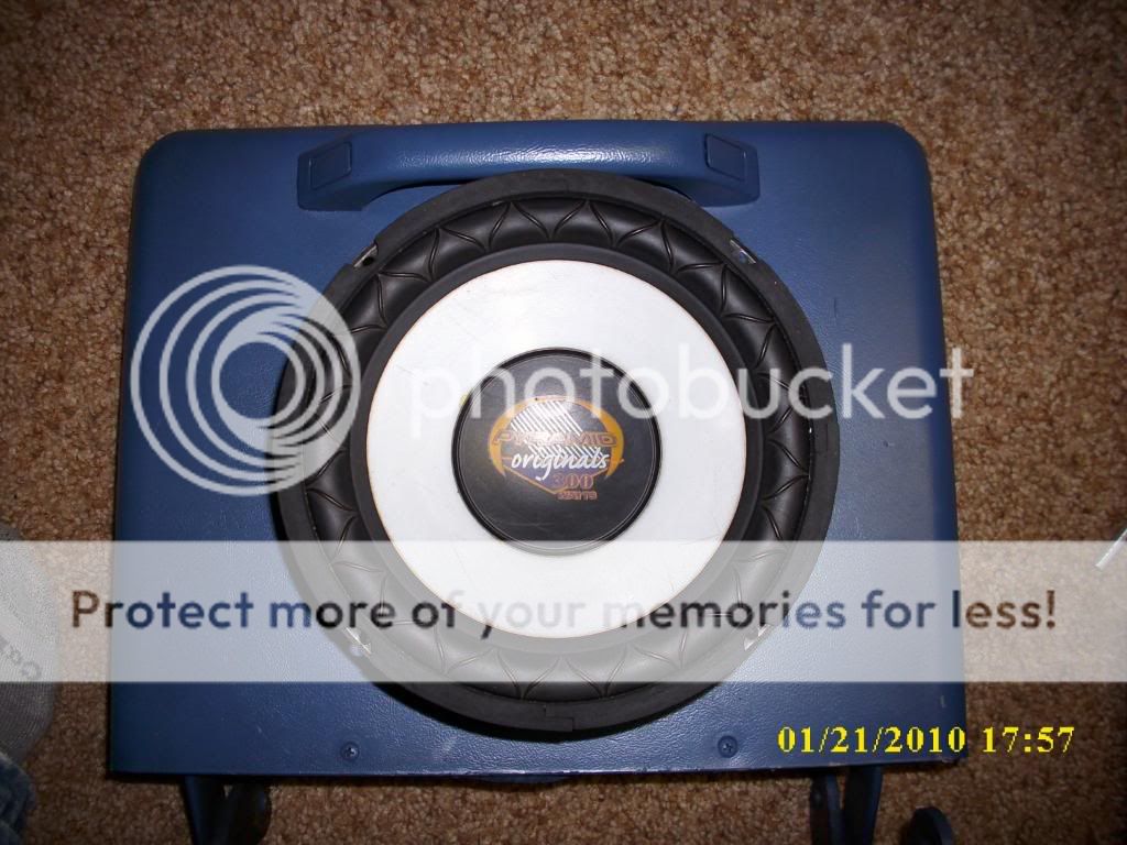

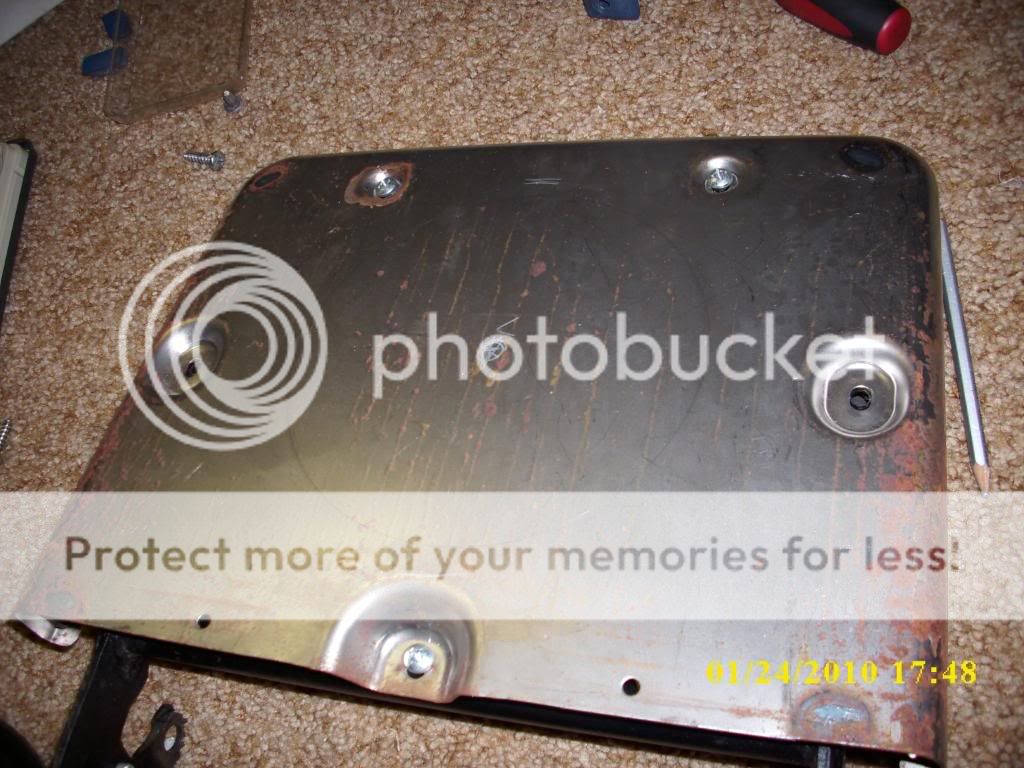

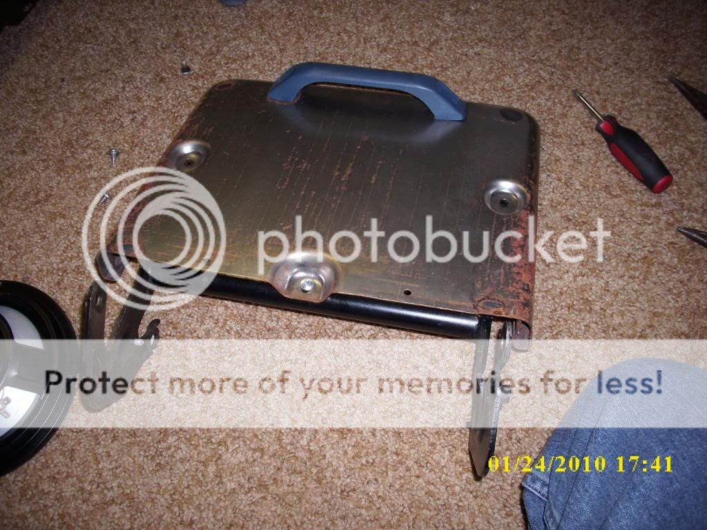

i got a good bit of motivation last night after talking to my coworker about the sub woofer idea, and i ended up getting the jump seat hole cut out (i borrowed his rotozip, but ended up using the cutting torch after i found out the rotozip just wasnt up to the job) and then cut the fabric out and got the sub mounted into the panel and bolted back into the truck. i havent made an enclosure for it yet but i still need to get the amp wiring kit and check out the audio forums for ideas on where to mount the amp. on to the pictures:

he also gave me some speaker box stuffing to try out, so once i get the amp hooked up ill know whether i want to add more stuffing or take it all out and build an enclosure.
