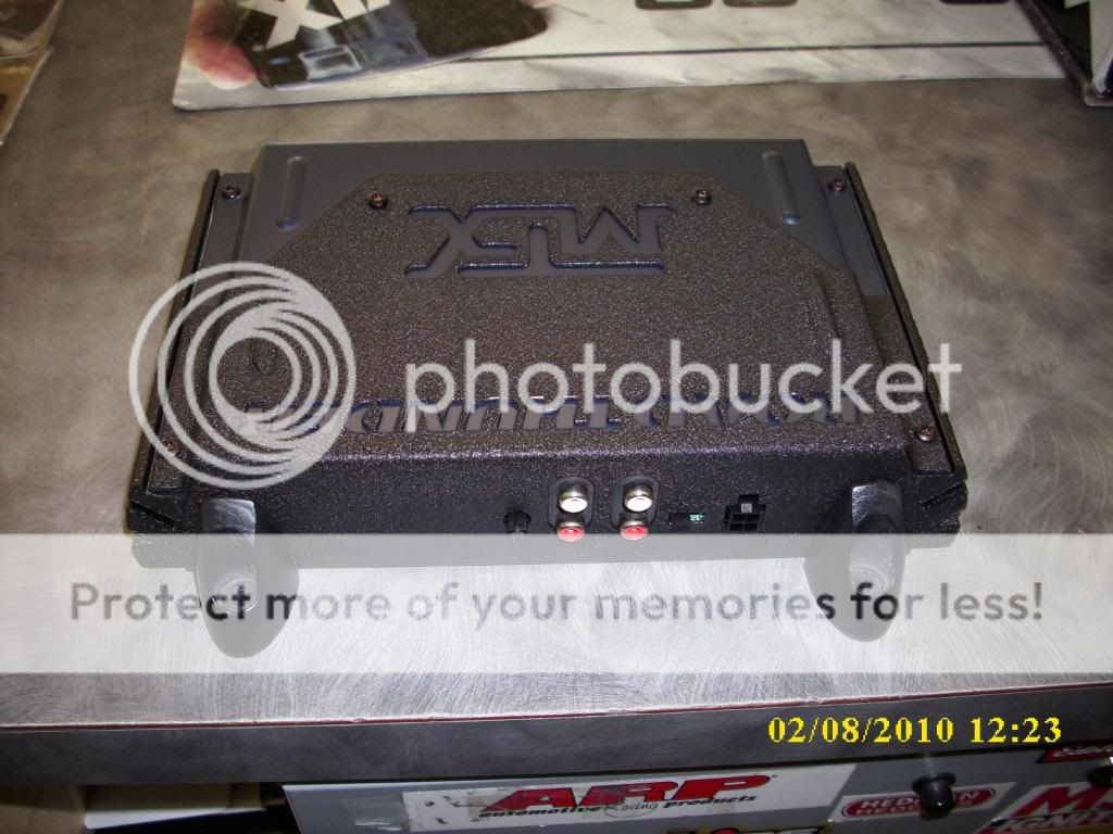

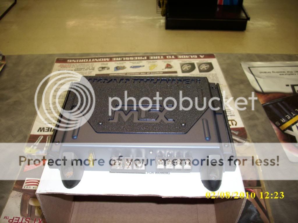

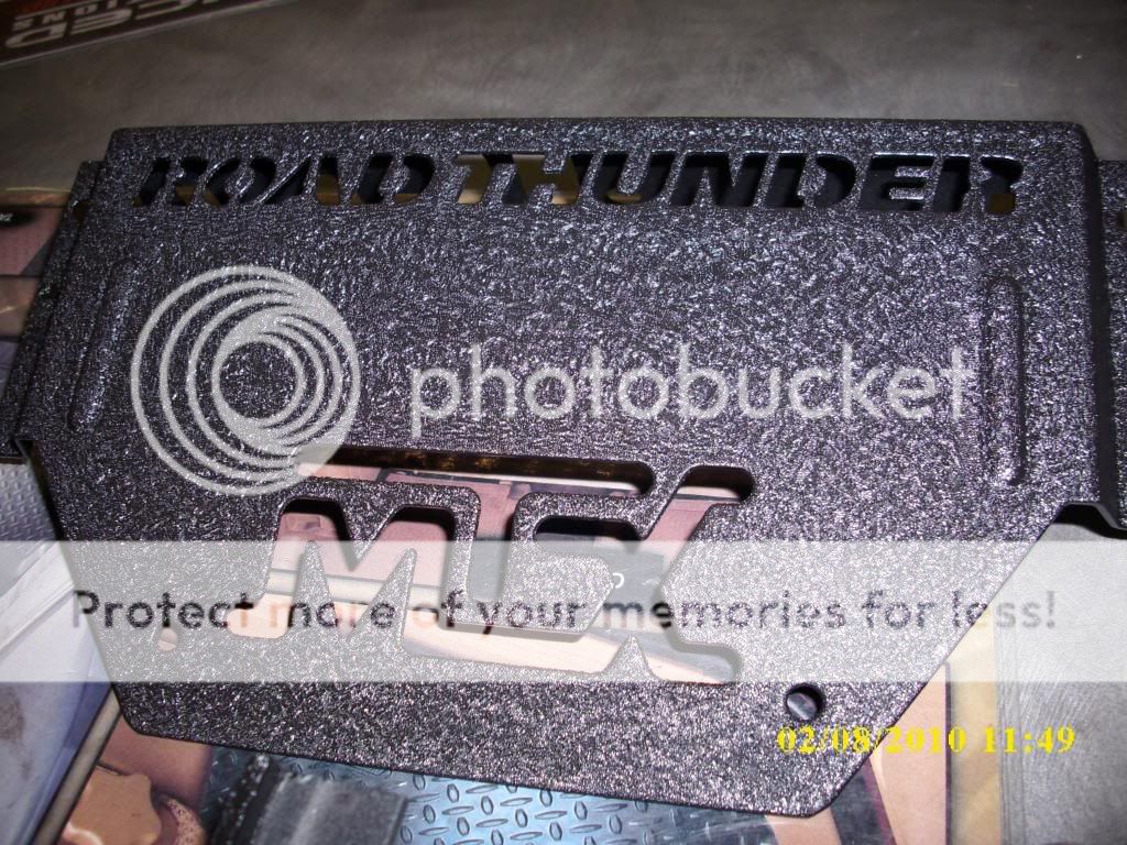

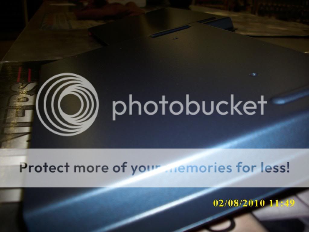

i did manage to add a little bit of camoflage to my amps. hopefully this will help them blend in better with the interior and keep wandering eyes at bay.

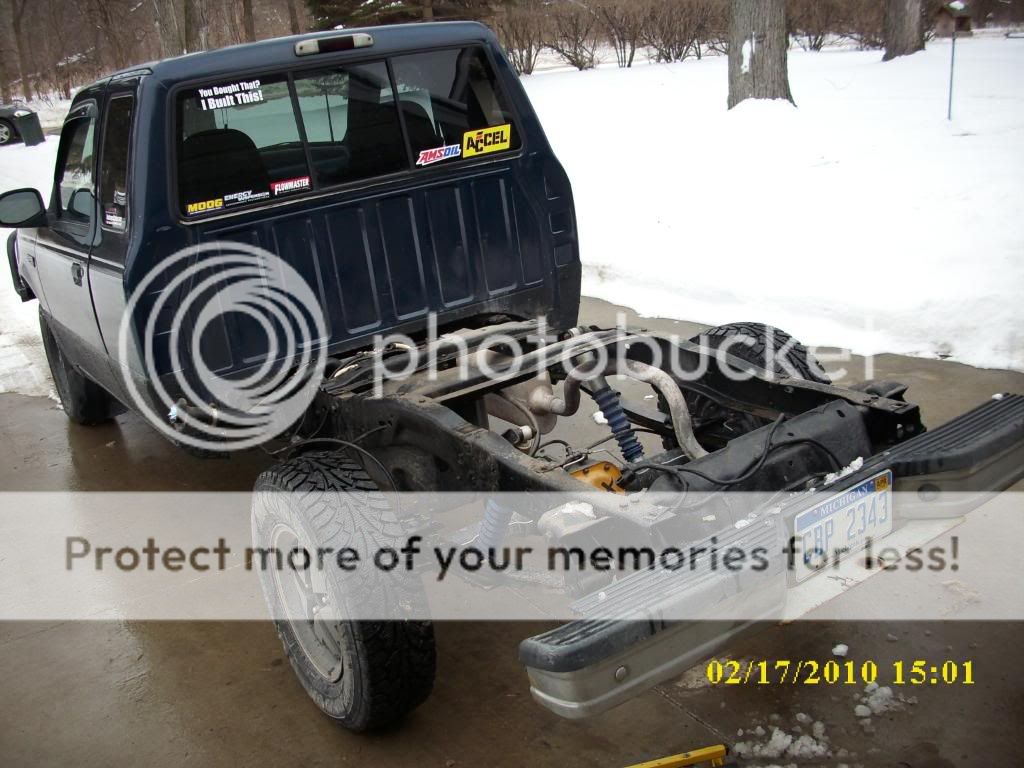

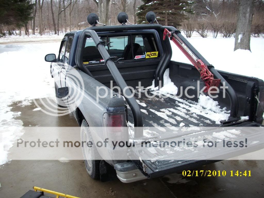

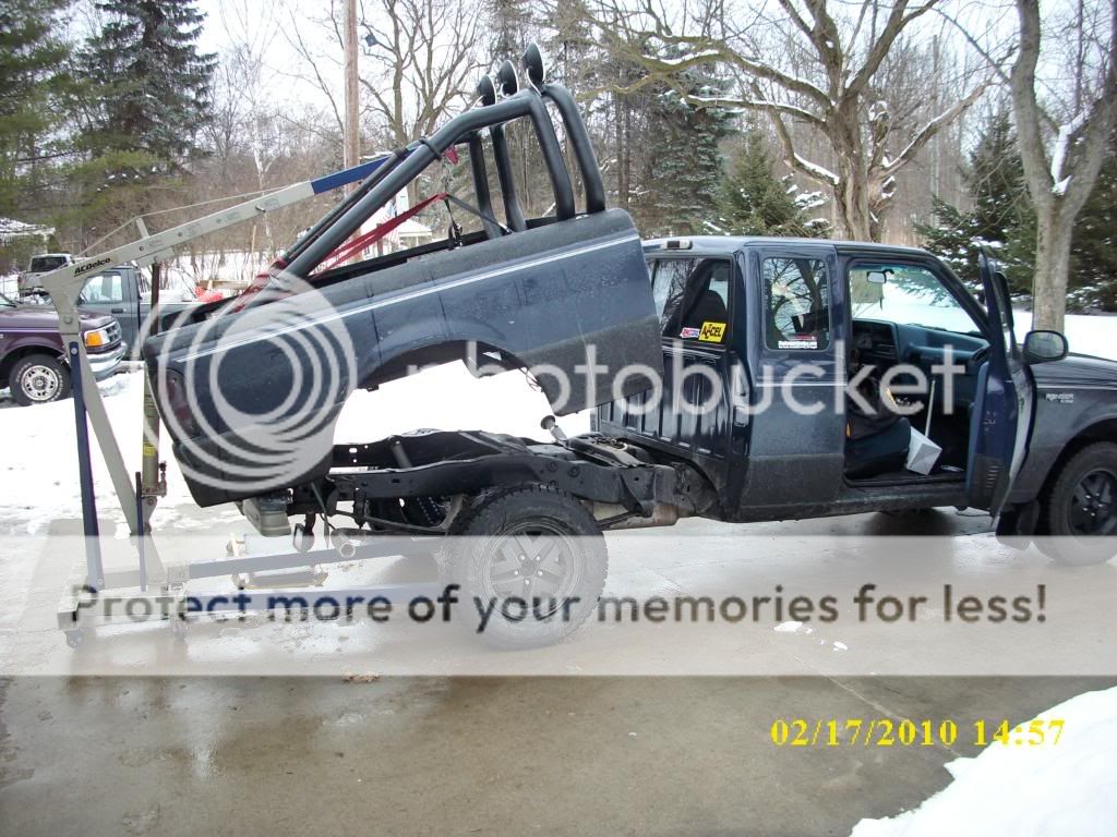

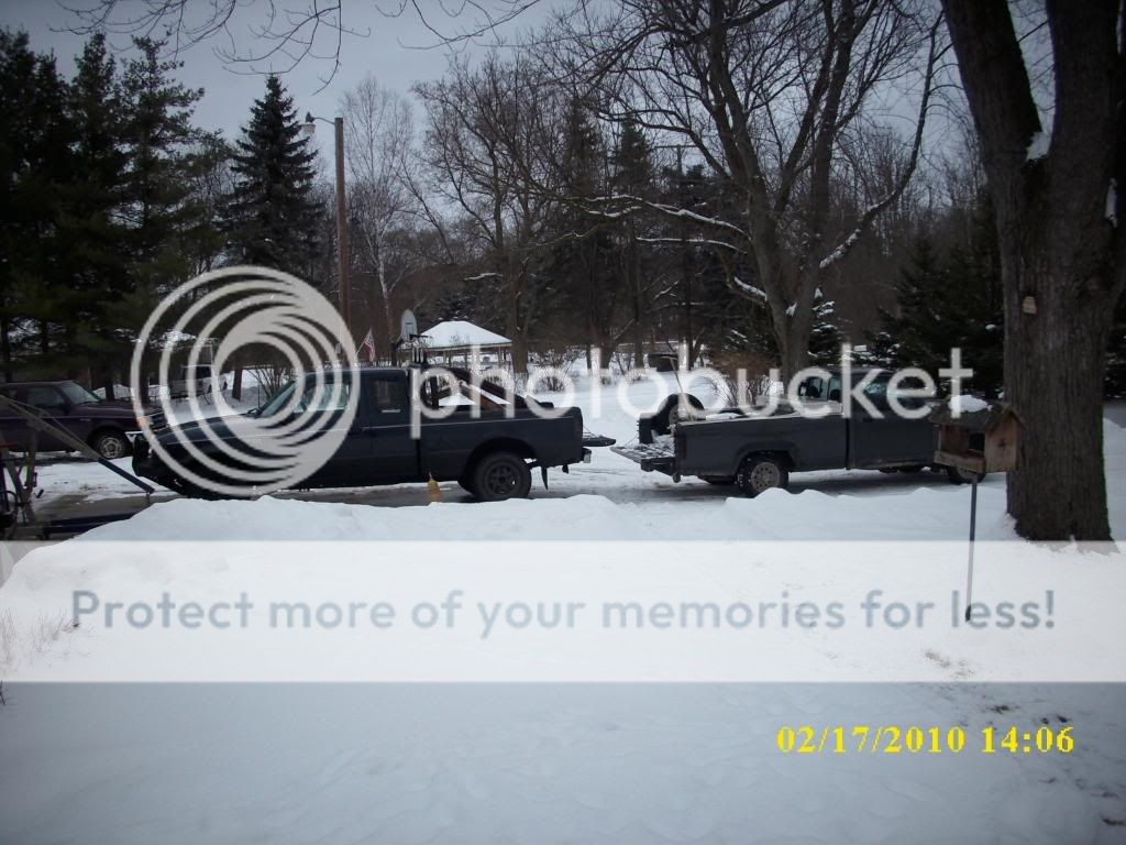

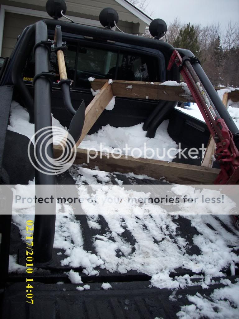

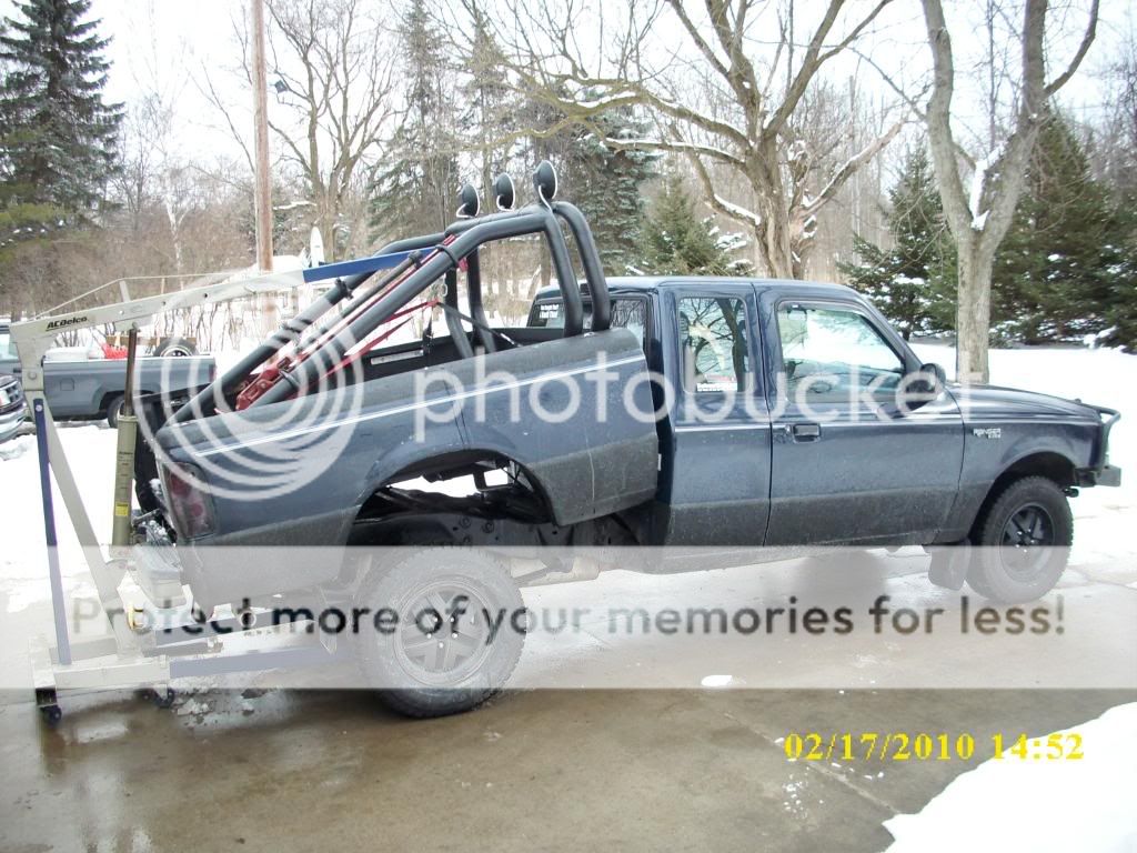

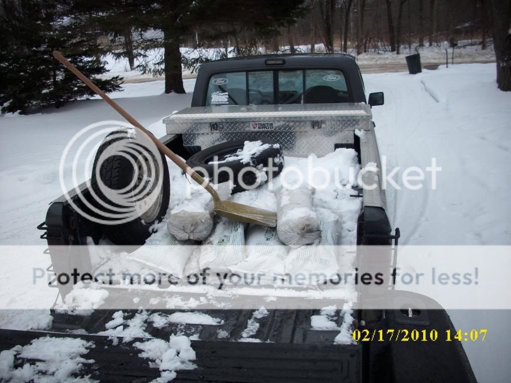

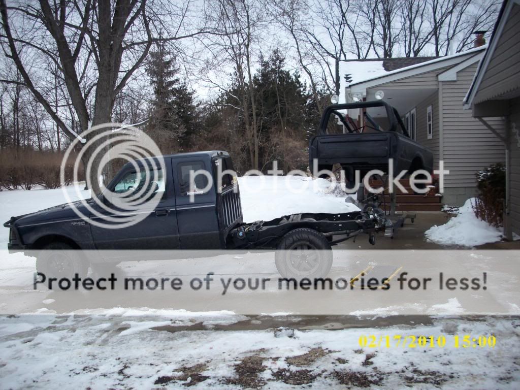

i finally had the motivation and the time today to take care of that fuel gauge issue i was having. it turned out to be the sending unit as i had suspected, and now everything seems to be back to normal. i took pictures of the bed removal process to show you how my one man operation went down (and so next time i have to do this ill know which straps to use and where to put them).
first i had to unload the bags of sand and all the snow from my bed

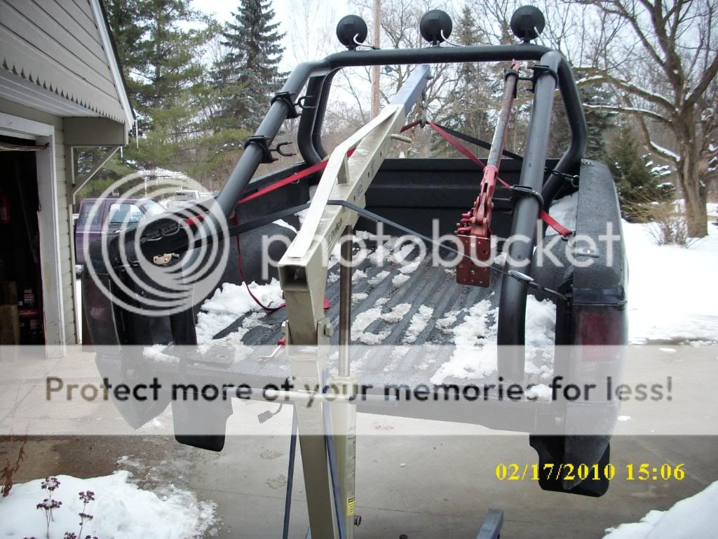

then it was time to get the straps out and hook up the engine hoist

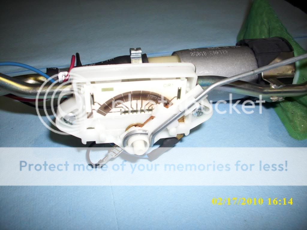

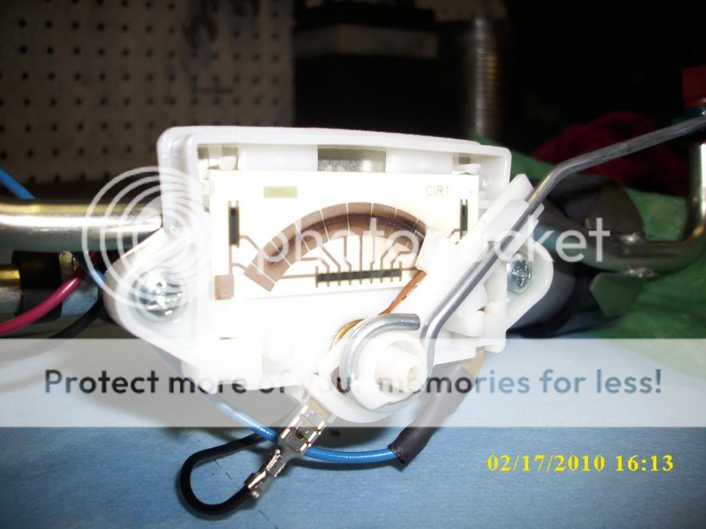

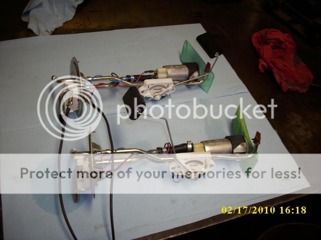

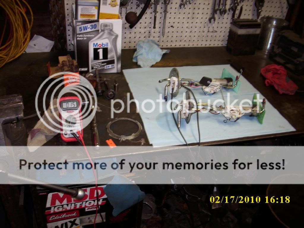

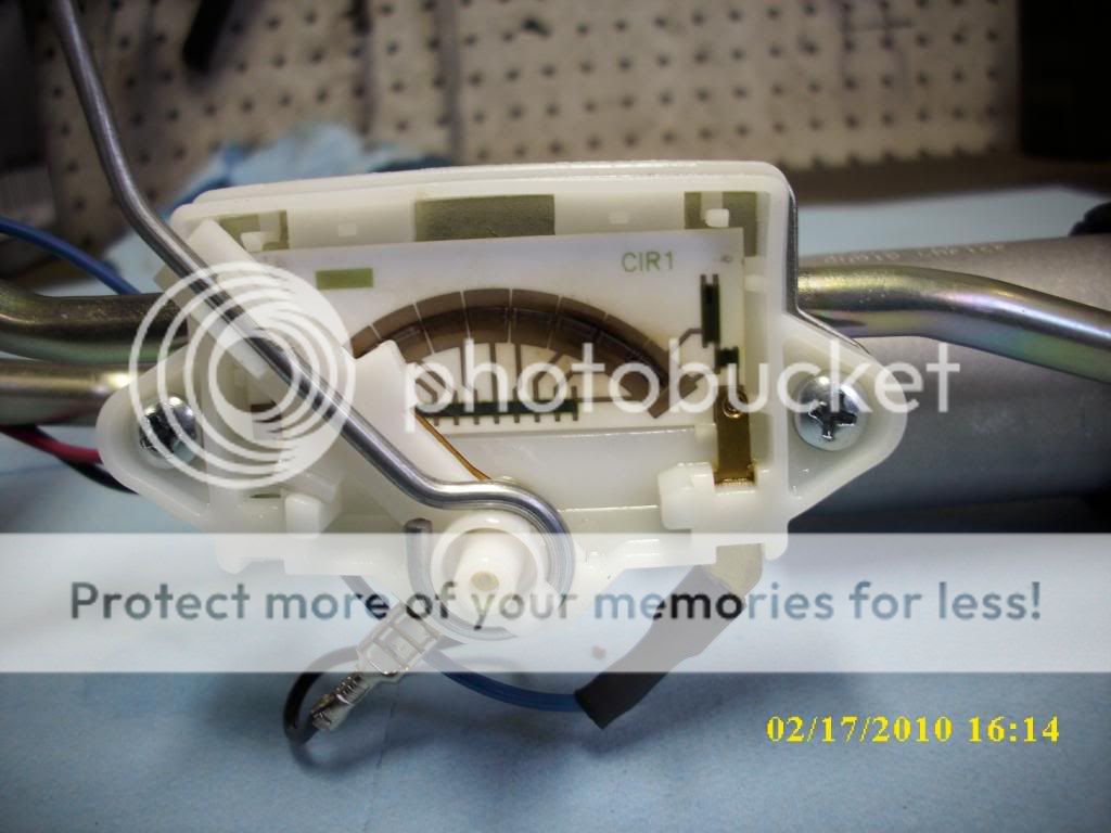

heres what i found after i pulled the pump and sender, a nice brownish tint to the circuit board of the sender

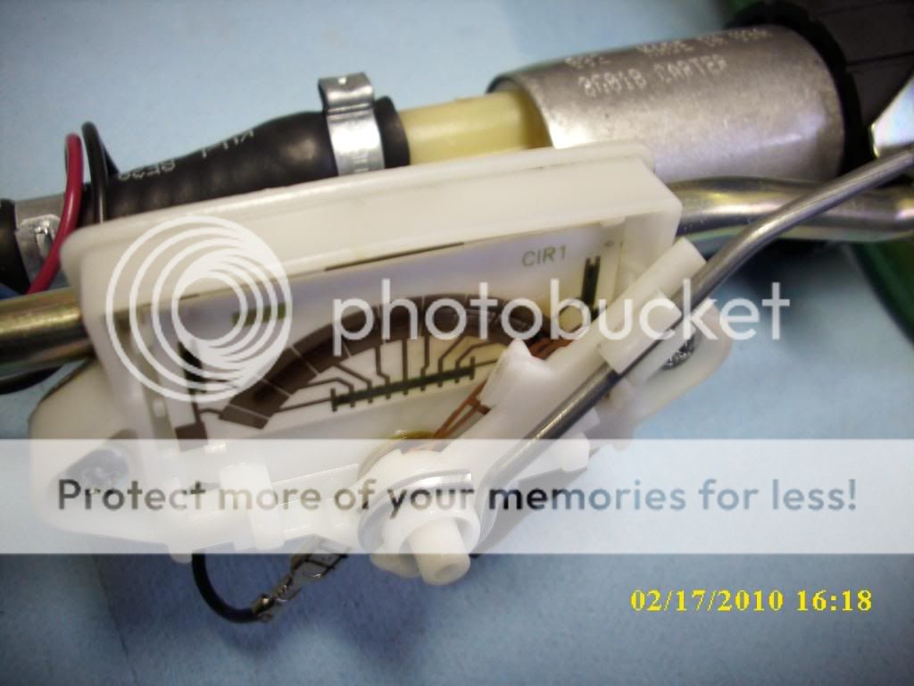

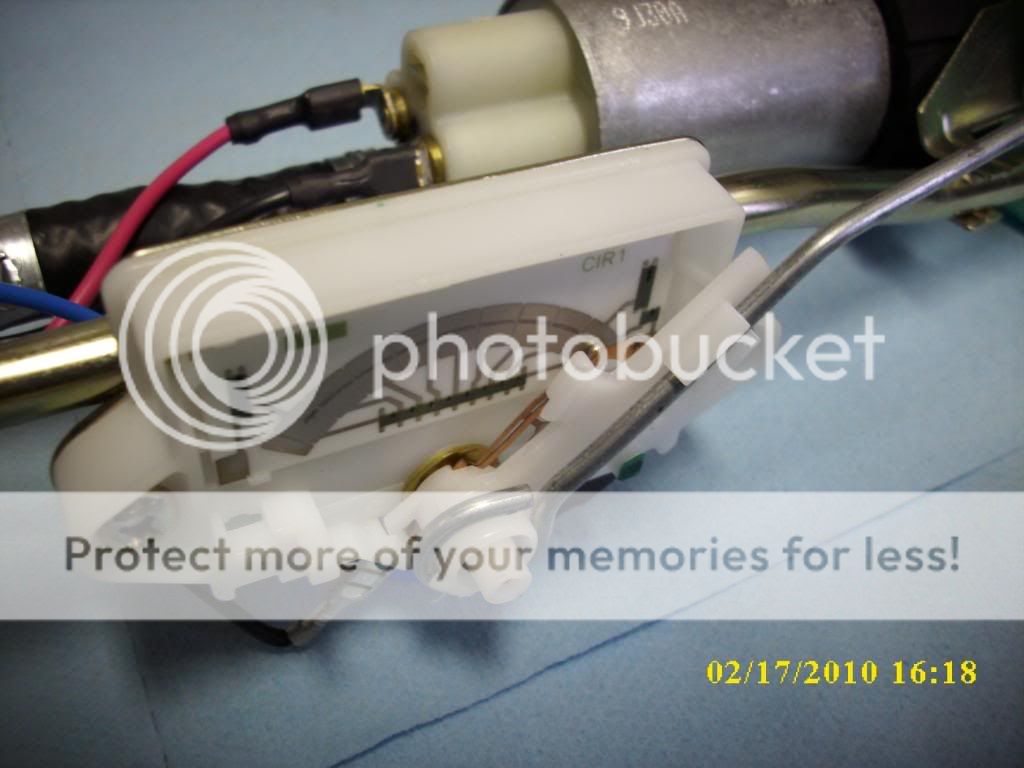

im checking the resistance through the full range of motion and noticed that the values on the old unit reached 500 at full and 16 empty, while the new unit read 165 full and 16 empty.

heres a comparison picture, you can see that the contact on the old pump turned black while the contact on the new one is nice clean copper.

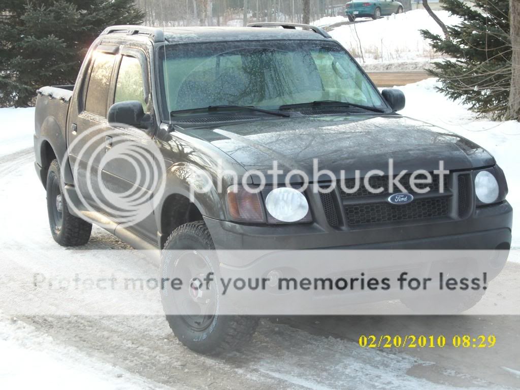

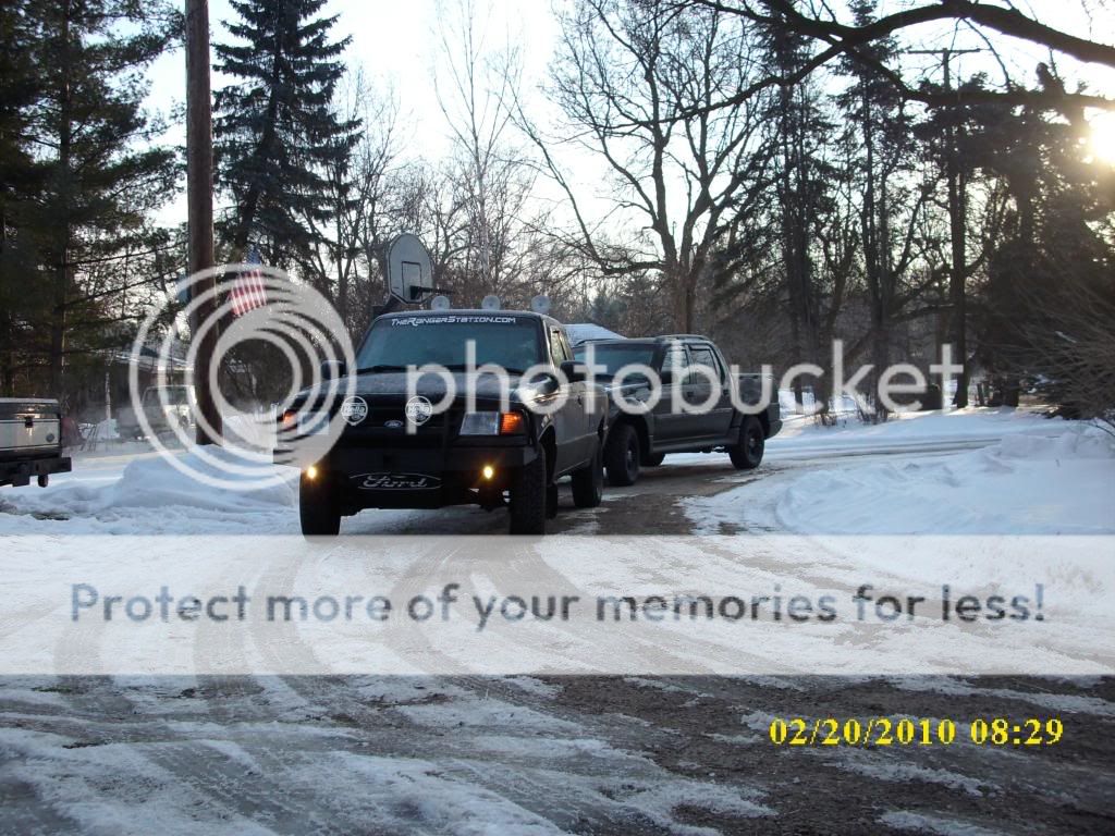

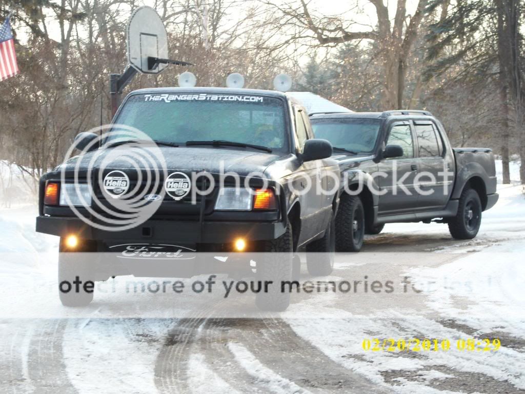

took some pictures of my truck this morning (and terra's sport trac) while i was waiting for it to get up to temp before i left for work, kind of random but yeah........
