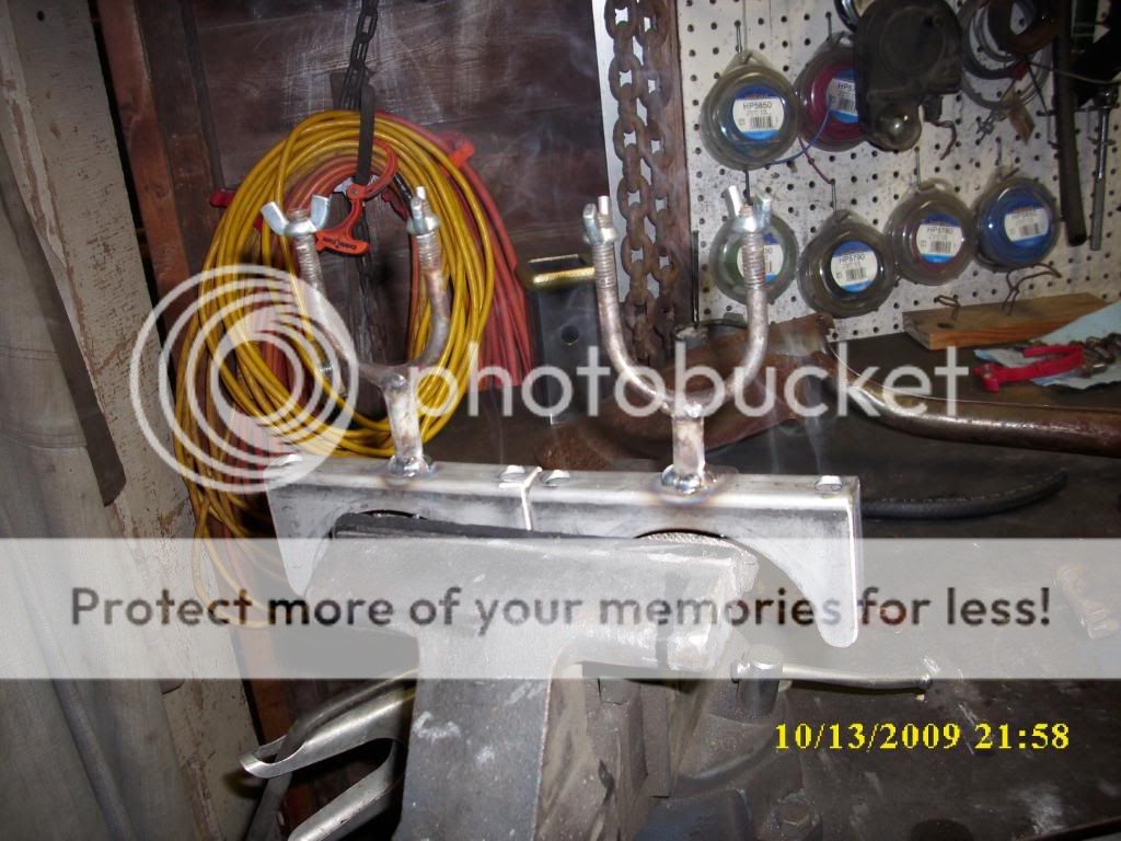

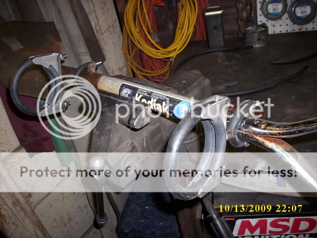

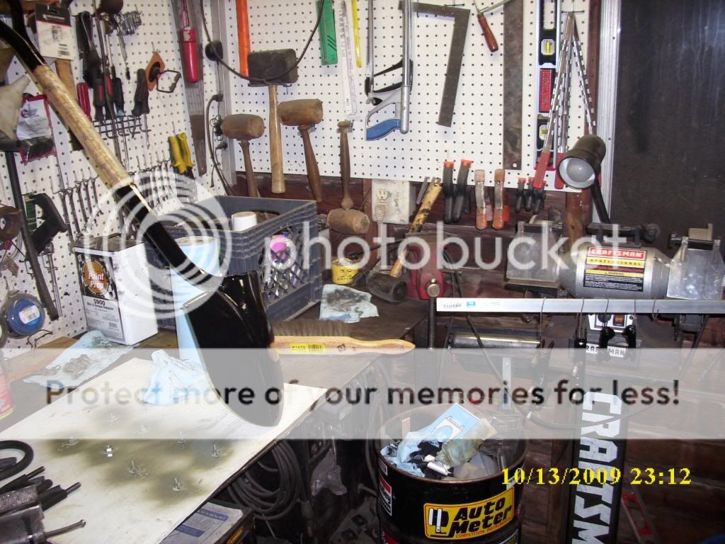

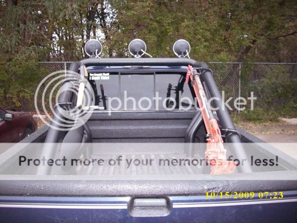

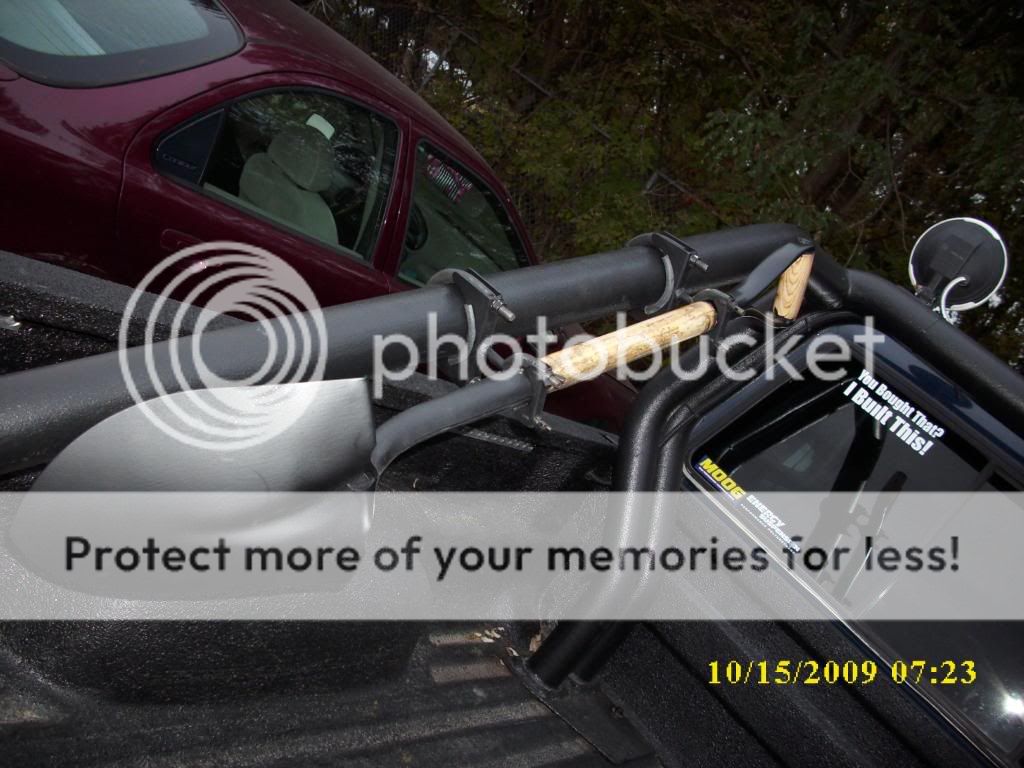

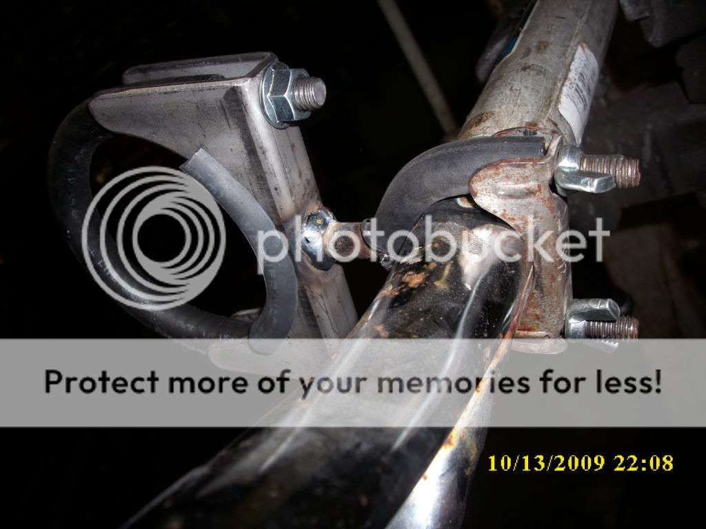

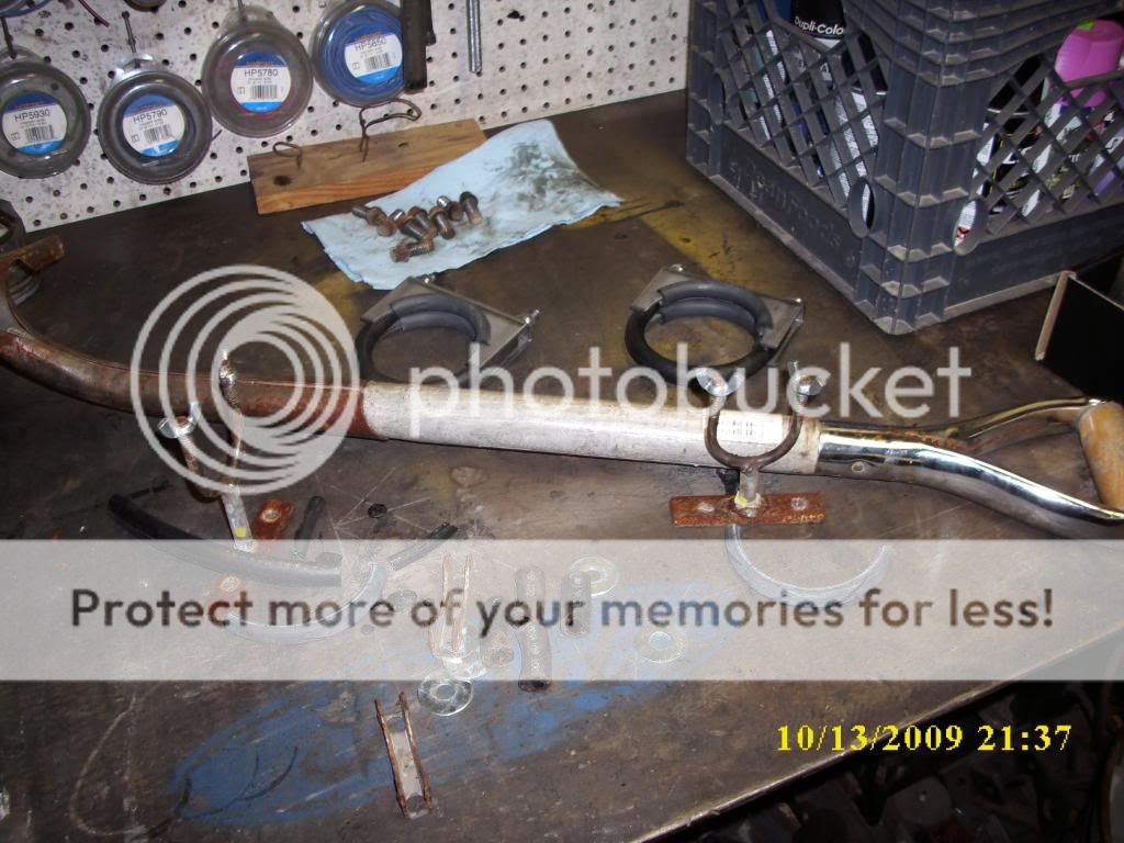

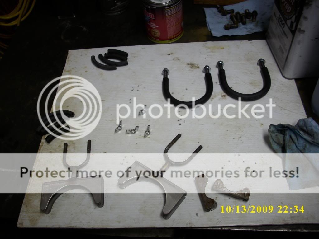

i used 3-1/2 muffler clamps to hold the jack to the roll bar, and i welded 3" long 1/2" bolts onto the clamps. i then loosely clamped the bolt in the vise and set a washer on it until it was to the point where the threads stoped and then i tightened the vise. by doing this the washer is now square with the bolt so that when i tighten the wing nut by hand it wont have as much of a tendency to vibrate loose since everything is square. i made mounts for my shovel that i have in the rescue ranger which i plan to soon adapt to fit on the other down tube of the roll bar.

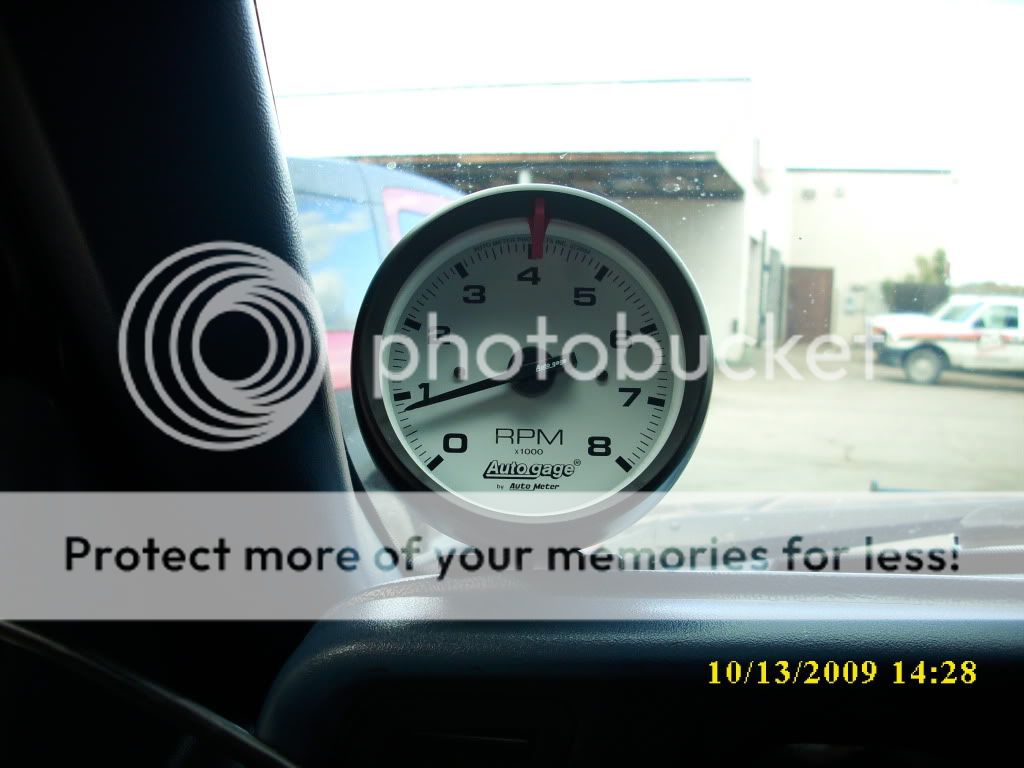

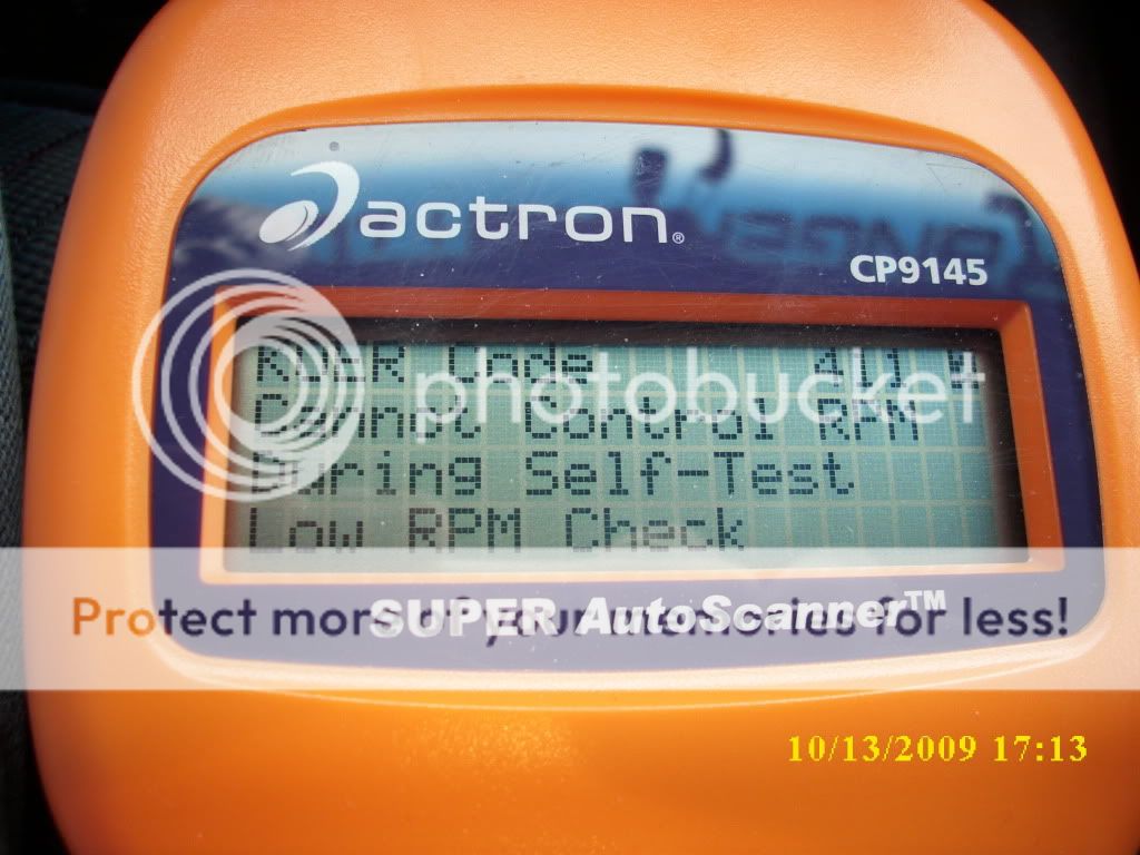

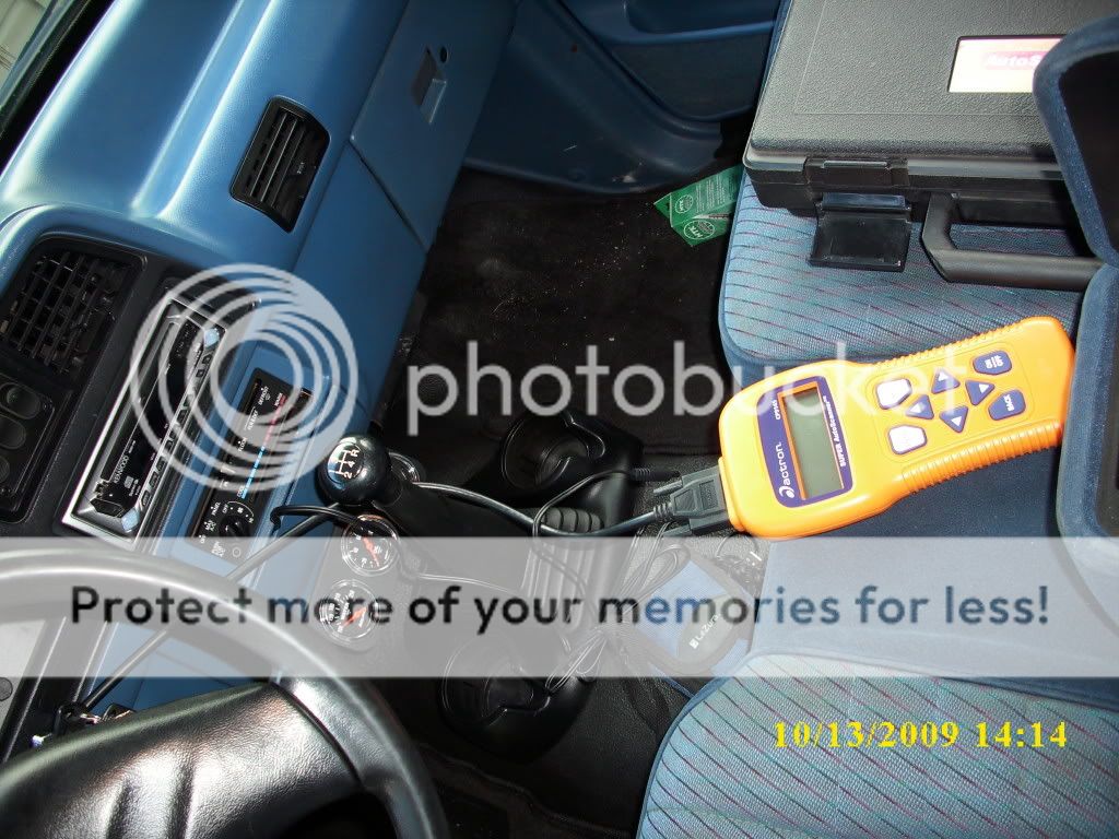

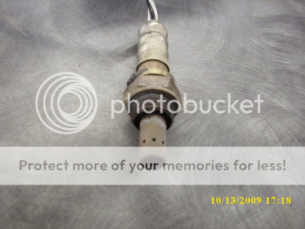

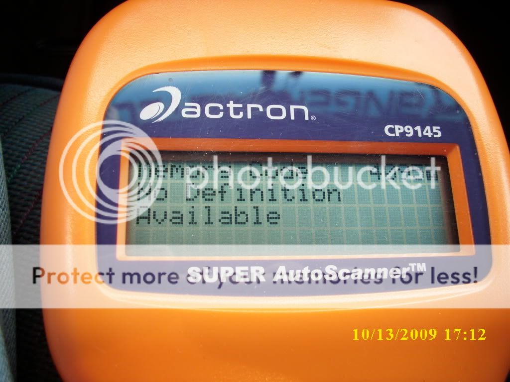

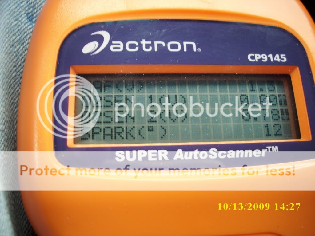

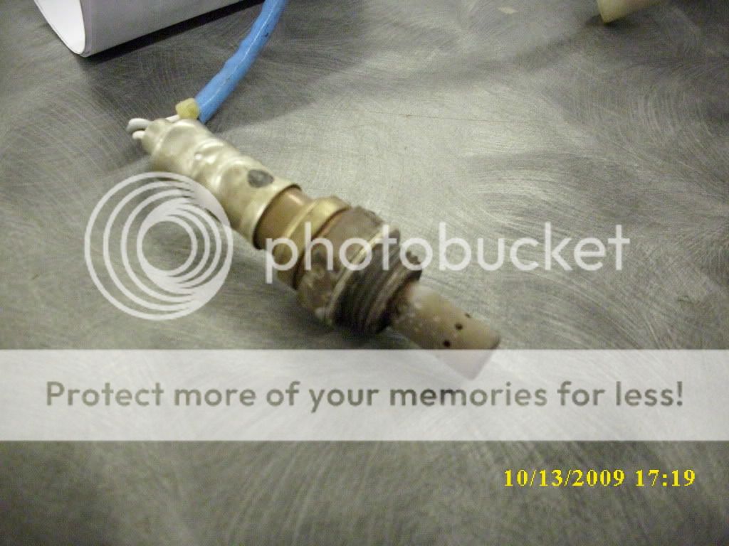

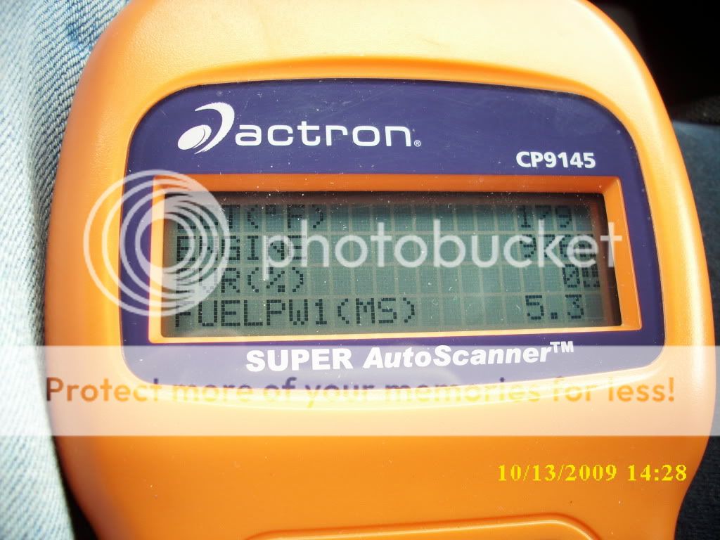

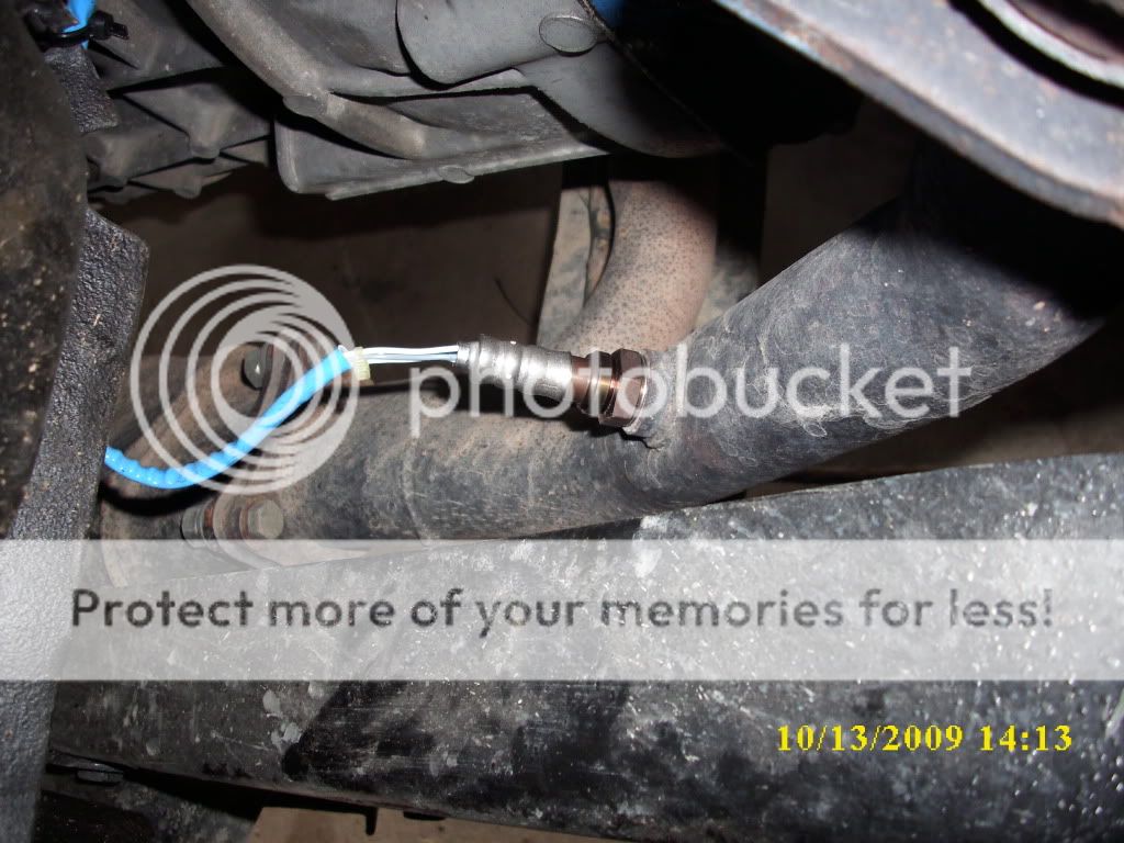

heres what i found after todays tests, the bank 1 o2 sensor is showing no voltage, so i replaced it with another new one (old one only had 1,000 miles on it) and its still showing no voltage. the engine rpm read out on the scanner doesnt match whats on my autometer tach (about a 500-700 rpm difference, but with the slower refresh rate of the scanner its hard to tell exactly) and theres a few more things i still have to find the definition of the abbreviation to understand better. heres some pics for the hell of it
heres the old 02 sensor
and heres the 2 codes that my truck is throwing

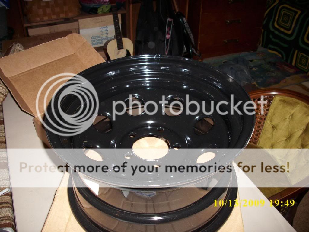

heres some pics fresh from my new photobucket account. i ordered my spare wheel from summit on monday night and it was at my door wednesday afternoon, now if i only had the $ for a new set of tires for the truck!
