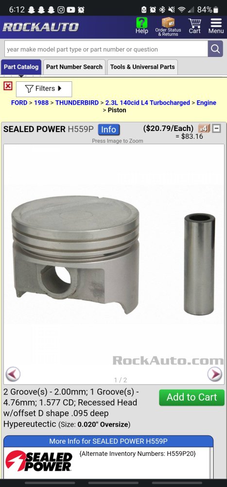

Found these on rock Auto, I see they say 20 thousandths oversized, I would have to bore the block for these to work, correct?
Probably, you'd have to get in there and measure the bores. If it hasn't been bored already and measures out with decent tolerances you'd be better off just finding stock size pistons. If you DO need to bore it out.. it's generally reccomended to bore as little as possible to make it happy.. Unless the bores are completely smoked than 10 thou would likely do it and would be a better plan.
But then you gotta ask yourself... is all that work worth cast pistons? What's the weakest link in one of those motors that's had an n/a-t swap done on it? Pistons? Rods? Crank? If the crank and rods are stronger than the pistons by a healthy amount (which isn't uncommon).. then I definitely wouldn't be happy having that much work done without upgrading to the forged slugs.
If you want to run more than 5psi to start, with room to turn it up when your feeling froggy... dishing out the money on forged pistons would probably be advantageous.
Thanks, the rods and crank can handle 350whp no issue, and I don't even want to go that high, I already have a my racecar, this is my daily. However I do want to run more than 5psi if I want (because we all know how addictive boost is). I have to tear the motor down, take measurements, and see if it need to go to the machine shop anyway. If all is good, I will try harder to find stock size pistons. If it needs to go to the machine shop anyway, I guess I'll bore it out. I appreciate the input!
