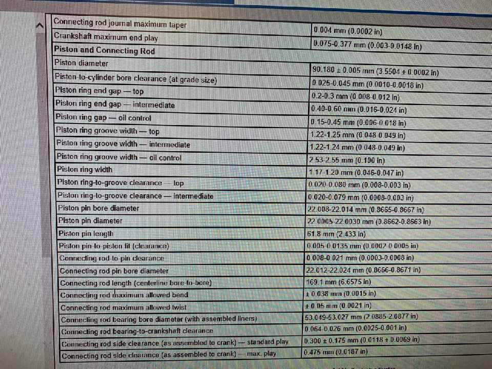

Need some input on rings and wrist pins.
Current wrist pin is 0.866". The majority of 302 connecting rods are 0.912 or 0.927...
Thoughts and opinions on which would be the better pick? Or a size I did not list?
Piston specs are attached for reference.
@alwaysFlOoReD, @deathbypsi, @bobbywalter, @19Walt93, @DCinDC, (long shot) @AllanD, (and why not...) @Will
Also, need to hear from one of the 4.0 guys soon if he's going to do a production drawing for 4.0 pistons... Is there no interest in a forged piston for the 4.0l? Seems odd for the engine everyone claims is "better...:"
Also any thoughts on rings would be helpful. Trinity rings are expensive AF, and come in a set for eight pistons, so seems a waste to use them. Draftsman is willing to redraw ring spacing and grooves to take whatever rings we choose.
Was thinking about having them designed to take a Chevy 4.2l ring, or a 2.9 ring....
Goal is to be able to fit these with a moly file-to-fit style ring for bore size, so looking for options before I just flip open the Mahle catalog and point and pick lol.

- Rings...what happened to gapless rings? Are they not good long term?
- How about adding the small ports along the top perimeter of the piston. Drilled down to help pressure reach the back side of the top ring?
Does that allow a ring with less initial tension so less friction except on power stroke?
If you're using 302 rods probably the least expensive way to change the pin size would be to put bushings in the rods and have full floating pins. You'd need grooves in the pistons to retain spiro locks or some other method to keep the pins in place. You must love those little engines to go through all that work and expense.
