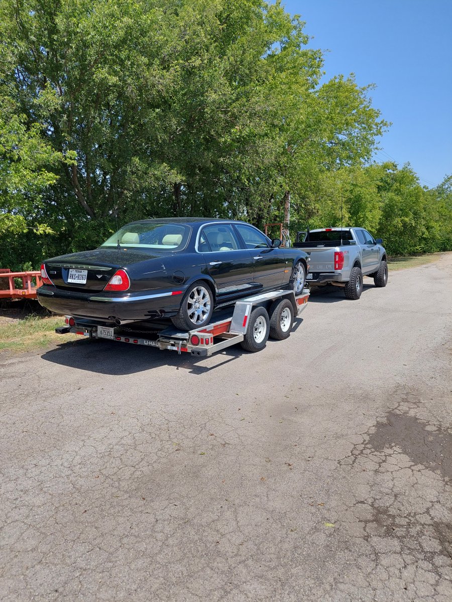

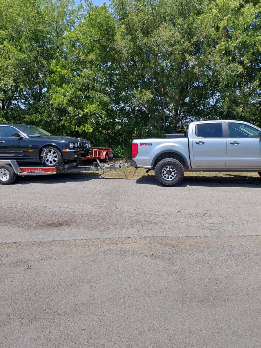

As far as performance goes with larger tires, I'm running 295's (33.5") with a 3.5-inch lift on my 2021 Ranger. I've driven it cross country and climbed hills and ledges with it, and it has performed great. I've yet to feel like it was lacking in power. Hell, I've towed my Jaguar on a Uhaul trailer with it after the lift and 295 tires and it had plenty of power.
