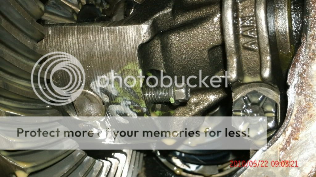

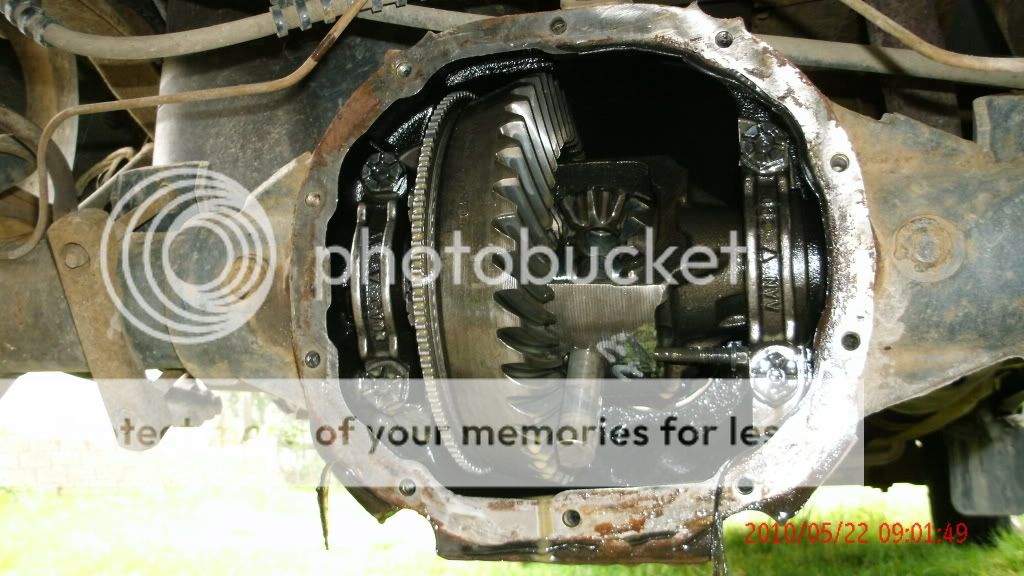

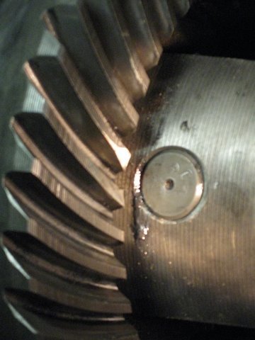

I installed a lockrite in my 7.5" 4.10 axle a couple years ago I had the same problems as you did but I was able to get the lock bolt out if I recall correctly I rotated the carrier so the lock bolt was under/behind the main bearing caps and was able to slide it right out and install a new one. To get the pinion shaft out I took my die grinder with a stone about 1" in diameter and took the corners off of the teeth in front of the pinon shaft, check both ends of the shaft the teeth in front of one of them should need less grinding to get it out. That is probably how most mechanics would get the shaft out, it is also how most guys on this site recommend removing the shaft just make sure you get ALL the grit/shavings out when you are done. if you install the locker make sure you use the solid pinion shaft that comes with the locker not the notched one that is in the axle now. the pic I attached shows the teeth I took the corners off of.

I have been trying to remove the Pinion Shaft for two days now. I just came across your guys' posts; I am really stoked right now. I never thought of this solution because I thought damaging the teeth would effect the performance of my ring gear. I appreciate the help guys.
Not a problem.
The material you're taking off never comes in contact with the pinion gear teeth, so it's not an issue.

Have you had any problem with this since then? i am thinking about doing the same thing.
My 4.56's are shaved and I've had no problems what-so-ever.
I did this with the 5.13s on my 8.8 back in '04 (35,000 miles & numerous wheeling trips ago). No issues with it at all.
