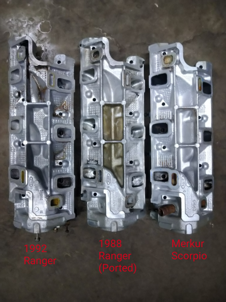

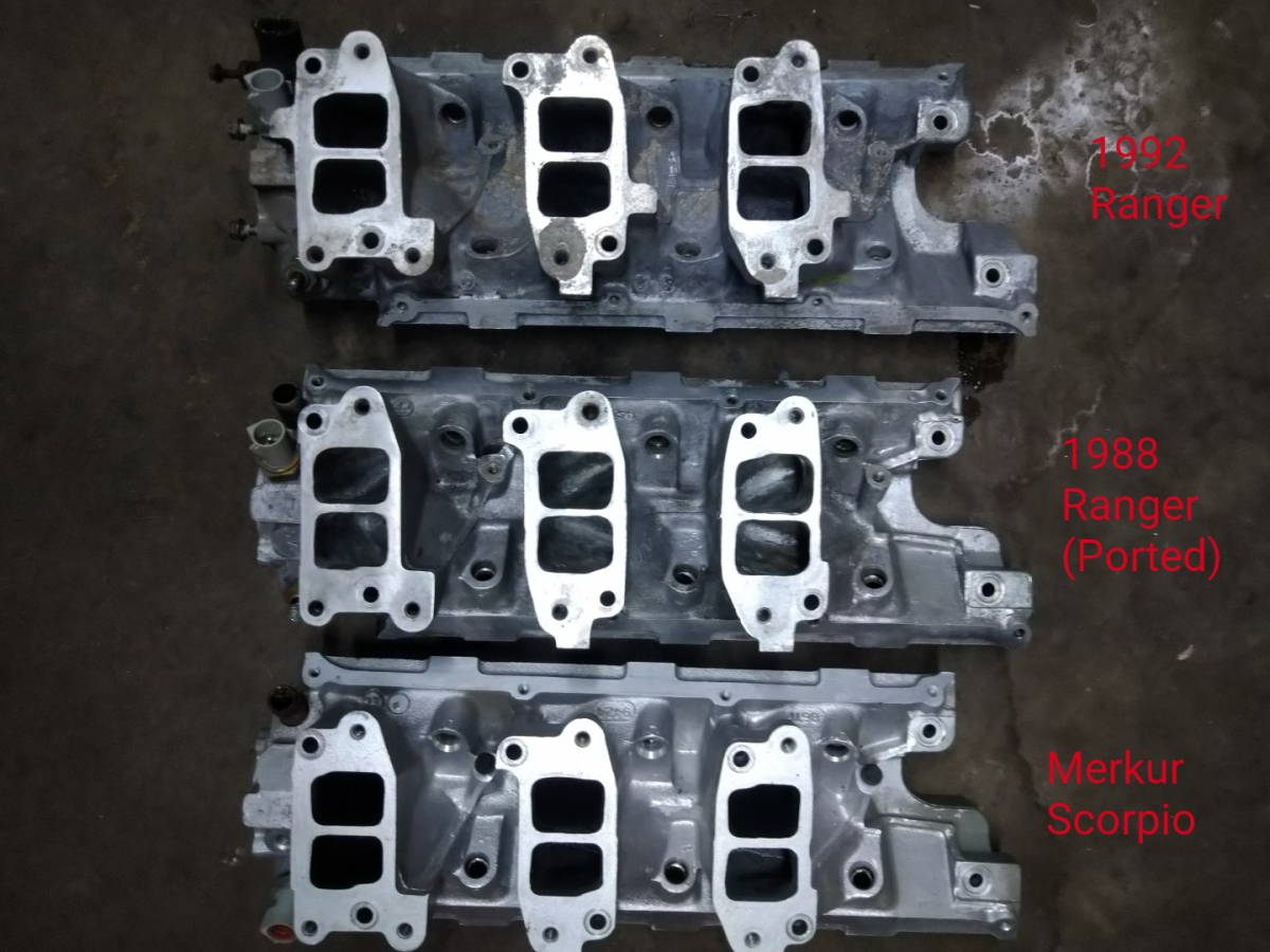

Not much difference between that and the stock efi lower intake. If you had a lathe and a mill you could make the stock efi intake work.
Any of the 3 above. Get some aluminum round stock, turn it down and drive it in the injector holes with some epoxy. Get some 1 inch thick aluminum stock however wide you need, and make 3 adapters to adapt those carbs to the manifold.
