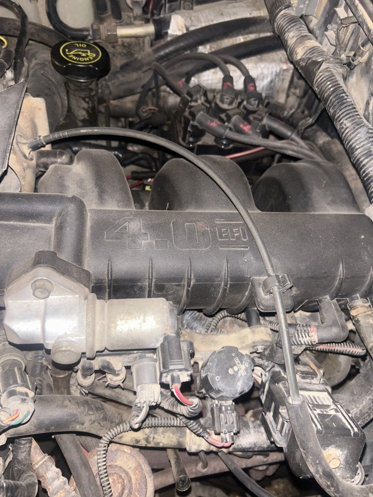

Yes I’ve went over my VIN code. Put it into shop key pro. And it reads 1995 ford ranger XLT Super cab manual 4x4. Which is what I have and on the upper intake it reads 4.0

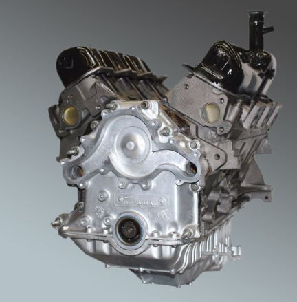

95 4.0 OHV notice the cylinder heads, only has 1 timing chain

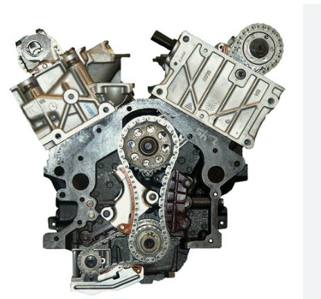

2001 4.0 SOHC, again, notice the cylinder heads, has multiple timing chains, the front has 3

You have a OHV engine, only 1 timing chain
The 4.0 SOHC engine (with multiple timing chains) was first used in 97 in the Explorer and then 2001 for the Ranger.
If you have some kind of slapping noise in the back of your engine, it's not a timing chain.
