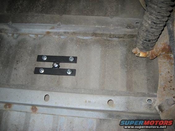

Well, here's my spare tire mount:
Underside mount, 5/8" nut welded to 1" wide flat stock.

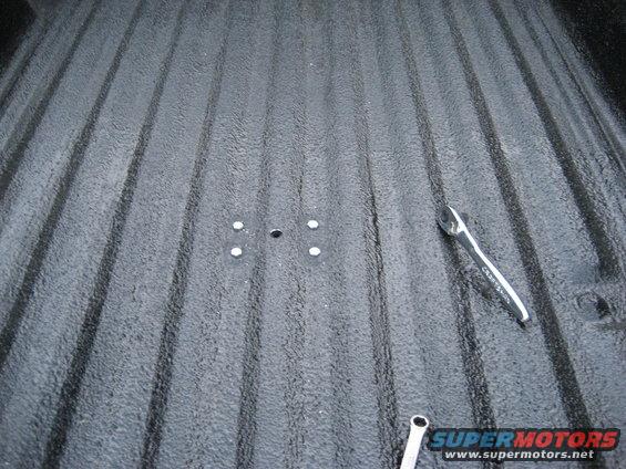

Topside of bed with no tire, only bolt heads take up space in bed.

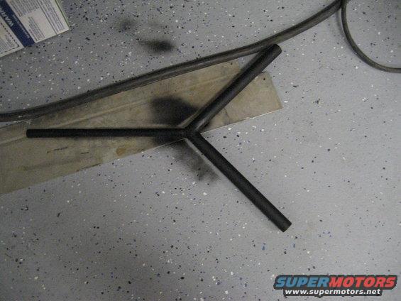

Holddown bar. 5/8" threaded rod (on left) with 1/2" ID black plumbing pipe cut at angle and welded to rod with fresh coat of flat black paint (don't worry, I wiped up the overspray). Rod is about 11" long and pipe is about 9" long

I might get some plastic to coat the area where the holddown makes contact with the wheel so it doesn't damage my aluminum wheel when I get it on there.
Make a really big washer out of some flat steel and put that in between the Y section and the wheel.
That's not a bad idea, thanks for the suggestion. Although, I would probably buy one instead, I don't have a lot of faith in my ability to cut something out that's supposed to be round. :D
