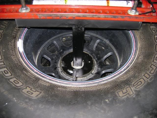

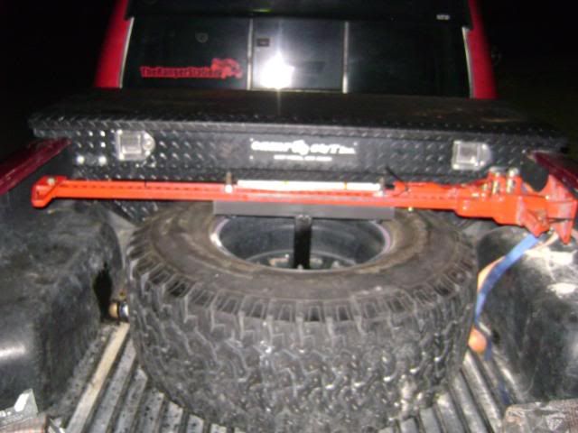

Here's what I've been using for the last year or so, the design could be reworked a little but it's been wheeled and bounced around enough that I know it isn't going to break on me. It is a 3/4" threaded rod welded to a plate that I bolted through the bed. Then welded a nut inside of the T part so it threads onto the rod.
