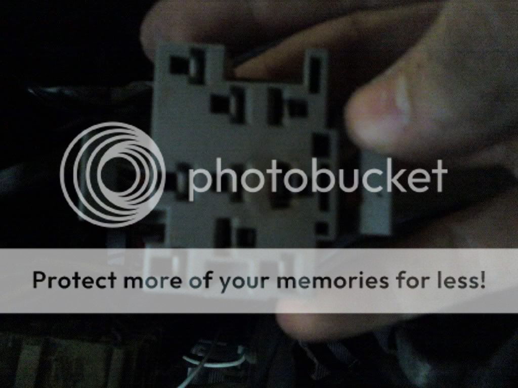

So I tore in to the dash (I hate repairing 1st gen dashes) and it is the main power to the light switch. It is the tan wire (not green) at pin b2 on the connecter. I checked the fuse and it was blown. It was a 15 amp fuse that blew so I replaced it with a 5 amp. The connecter was also melted (see 1st pic). I plugged it all back together with a new headlight switch and 5 amp fuse and the same thing happened. When it flashes I can feel the new light switch "click" and it gets hot after a while.

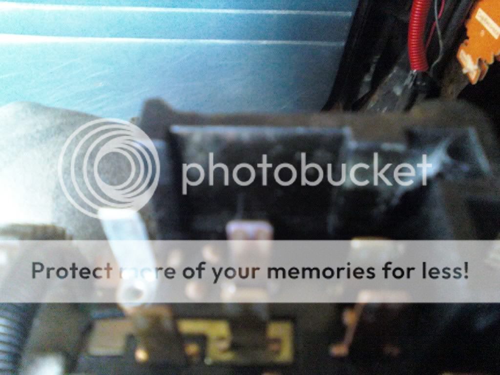

The old light switch was burnt on pin b2 (see 2nd pic).

The light switch does have an internal breaker; I suspect that's the "click" that you're hearing. It sounds to me like you have a lot resistance in the circuit, or, a short. A direct short should just blow the fuse; the CB kicking instead leans more toward a very bad connection (i.e.- high resistance).
If it were me, the first thing I'd fix would be toasted light switch connector. I'm thinking you have a crappy wire-to-terminal connection in that connector. Then, go down through the lighting wires in the harnesses, looking for bad wires or a short.

A bad connection causing high resistance anywhere after the switch can throw its breaker. Heat caused the burnt terminals and melted connector, right?; it's an increased current draw which kicks the breaker, but not enough of a dead short to blow the fuse. Scary, huh?
I don't know for sure where you can find new replacement wiring pigtails. Ford used to offer them, maybe still; and perhaps lmctruck has that particular one. I did the boneyard thing for mine, and just slipped out the good terminals, spliced in the couple of needed replacement terminals, and then put all of the wires back into the new good plastic connector body.
