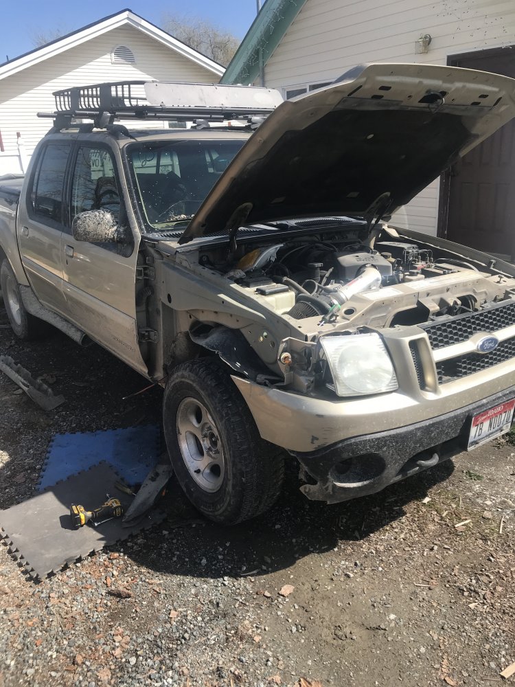

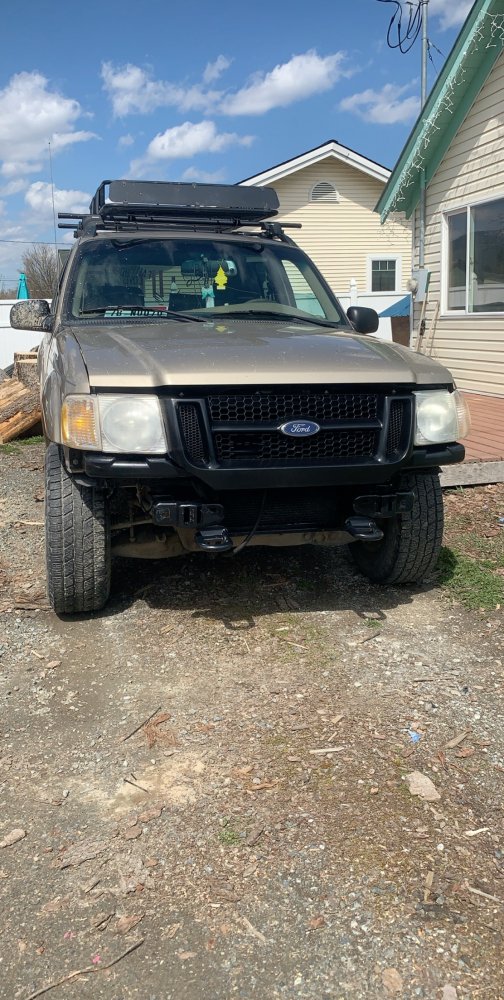

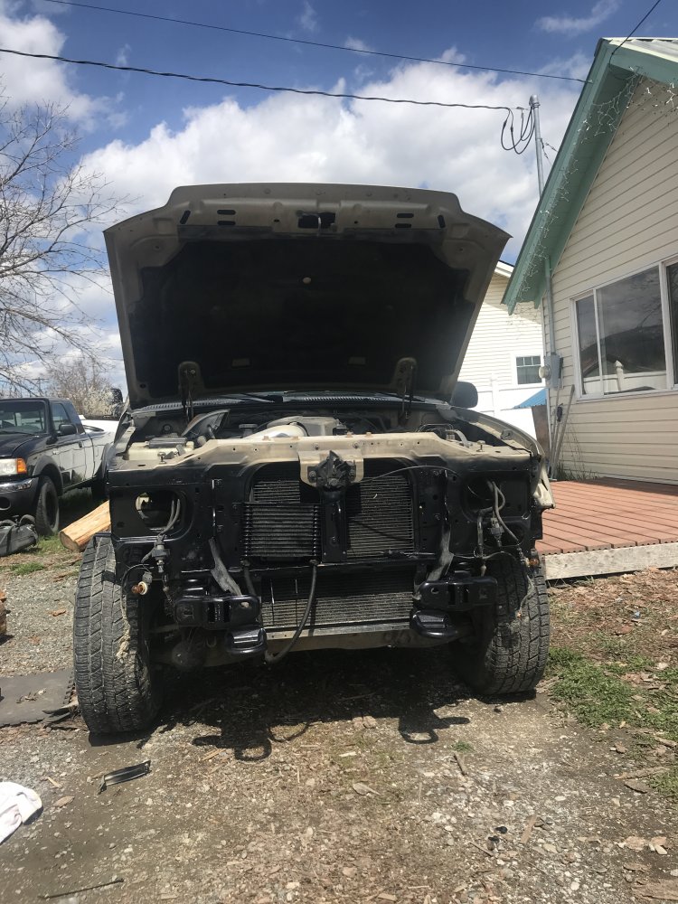

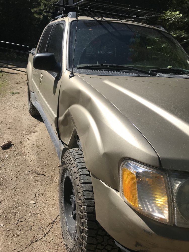

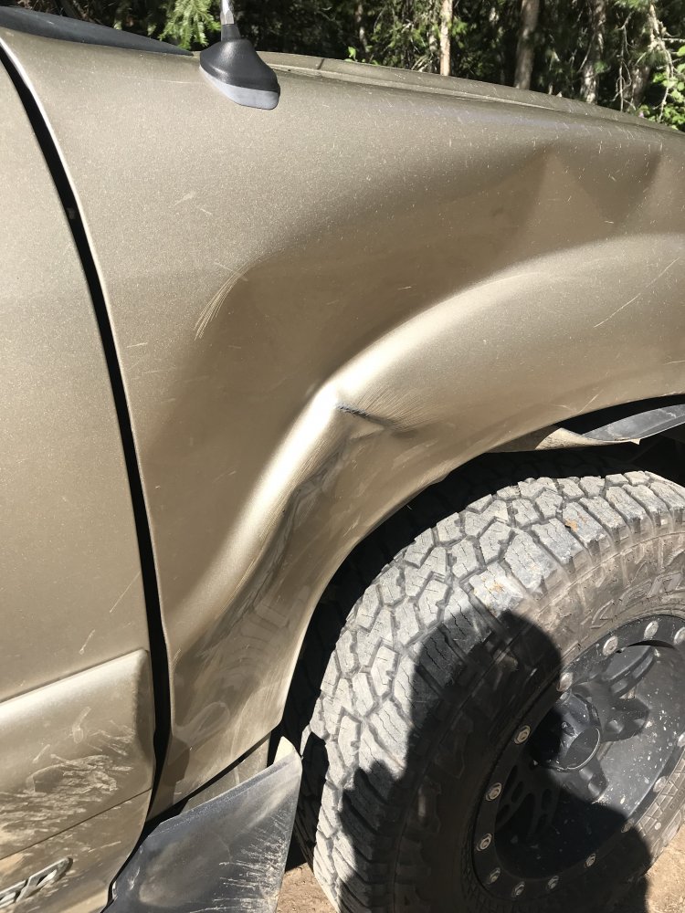

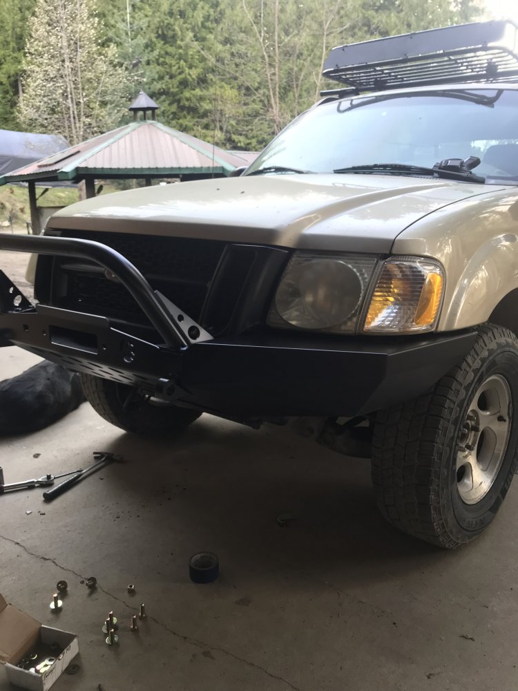

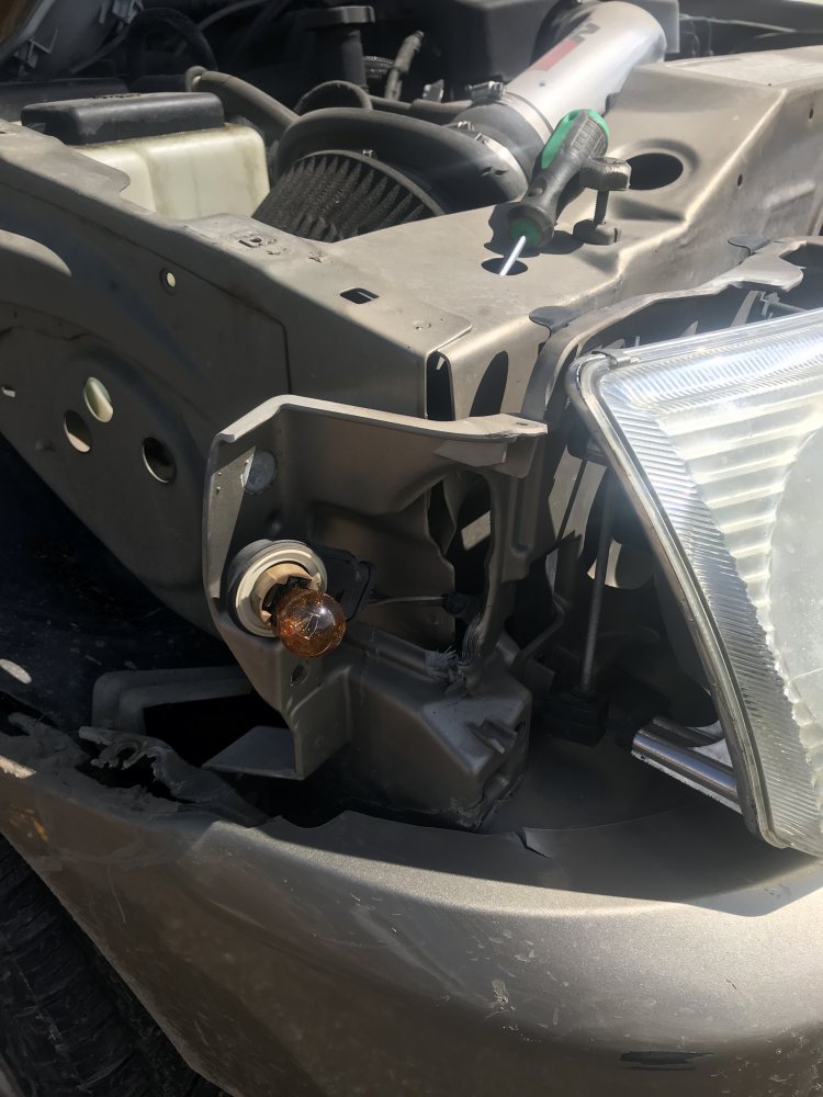

My wife hit a deer last year and I finally found a color matching fender and swapped it out.
The deer broke the header panel and lights on the passenger side, so I took it all off and spray painted (with tractor enamel) everything that was exposed.
Modified the front bumper plastic and made a grille and now we are patiently waiting for our AOR bumper!
Here are some before and after pics!

I guess technically the deer did hit her but the damage actually wasn’t as bad as I thought...
All in all I did upper and lower ball joints, fender, head light, corner light, header panel and an alignment. Could have been so much worse.
Now I have to put her Pro comp wheels back on it with her Toyo A/T’s.... gonna be looking sweeeeeeet!
Final product of my wife’s truck... with a little fabrication of course.
Had to weld on tabs to move it up 2 inches to give it that clean look, and we welded a nice piece of angle iron across the frame rails kind of like the rangers in order to pick up the other 2 bolts and add strength.
