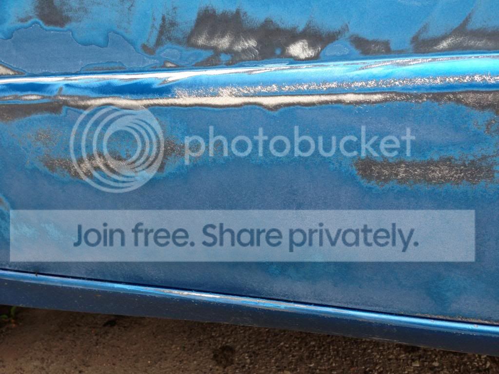

So here is a picture of my truck.
the clearcoat from looking at the picture shows that it is peeling everywhere!!! I would like to know what would be the best way to go about fixing this.

Yeah I'll be repaintin it myself sometime this summer hopefully. I just don't know what the best method of prepping it would be without taking all the paint off.
I would like to be able to take just the clear coat off and scuff the original pain and then repaint it but not sure how to go about that. Whether u should invest in a power sander of some sort or just hand sand it.

I'd scuff the basecoat areas enough to get the oxidation off, then use a DA sander to sand the rest until all the failing areas are gone, and feathered out. If you don't prime the spots where the clear ends, it will most likely wrinkle when sprayed, that's my experience.
There is a huge difference in doing the job right to make it look new, and doing it good enough to make paint stick, and shine.
ya you'll have to start fresh on that, sand it down with 180 grit, prime it, block it with 400 grit, paint it.
I would not use a cheap DA from some place like Harbor Frieght. The nicer a DA, the smoother it operates. If you're only using a DA for 1 job, I'd try and find somebody to borrow one from.
I have a Mac Tools DA, and I think it was $250. I used it for 2 years all the time at work. I did autobody.
Looking back, I should have said to strip the clear, not just in the failed areas. There is no reason to go past the sealer though. The clear is what failed, and the base is oxidized, but the sealer should be fine, and in my opinion does a better job of sticking to the metal than what ever you could lay down.
Just for a second opinion on prep, I'd 180 it down to sealer (trying to break through as little as possible), then 320 to feather out any areas that need it, and remove the 180 scratches. Prime everything, and prep the primer with 180/block, then 320/block, then give a good sanding with 600 wetsand and a block. Everybody has thier preferred steps, that's mine. Metallics can be very sensitive to sanding scratches where as solid colors are a lot more forgiving (a solid white can almost get away with just doing 320, but I don't recomend it) On silvers, I use 800 wetsand not 600, just to make sure no sanding scratchs show through.

So I shouldn't have to take all the clearcoat off, just make sure I feather it well? and sand the oxidized paint. As far as what grits to use I know what I need.

Do I need to sand all of the clear off?
Or do I just need to rough up the surface with sanding and feather the edges?
Ill be posting a pic of my work thus far:
Most of the sanding done here was done by the first sander, which ate through the paint more then I wanted, either way the three tone (bare metal, blue, black paint) is growing on me and im thinking of just clearing it.
This pic shows where I haven't completely sanded down all the clear in the bottom 1/3 of the pic. Should I be worried about leaving this or should I sand this clear completely off before possibly painting it.
