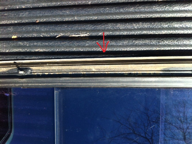

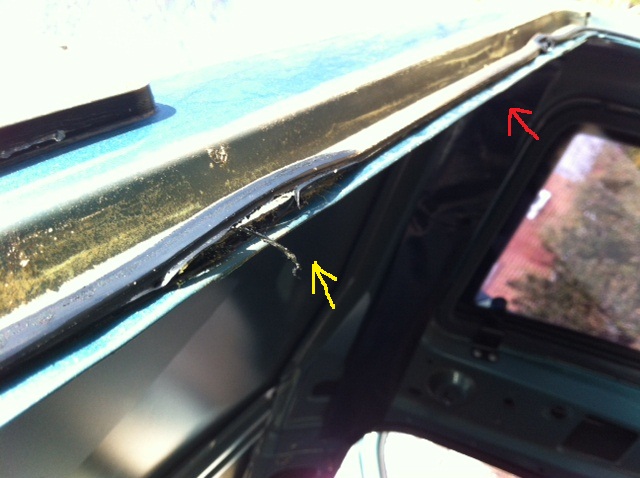

Got the window out today. Remove 8 bolts, push, and it's out -- too easy. In the first pic below, you can easily see where the factory tape failed at the top in two places. Yellow arrow is where the tape came away from the cab. Red arrow is where the tape came away from the window. In the second pic, you can see the stain on the window where the water was coming through the sealer.

Thanks guys. It's a $20 fix that could cost you a lot more if you let it go too long like I did.
