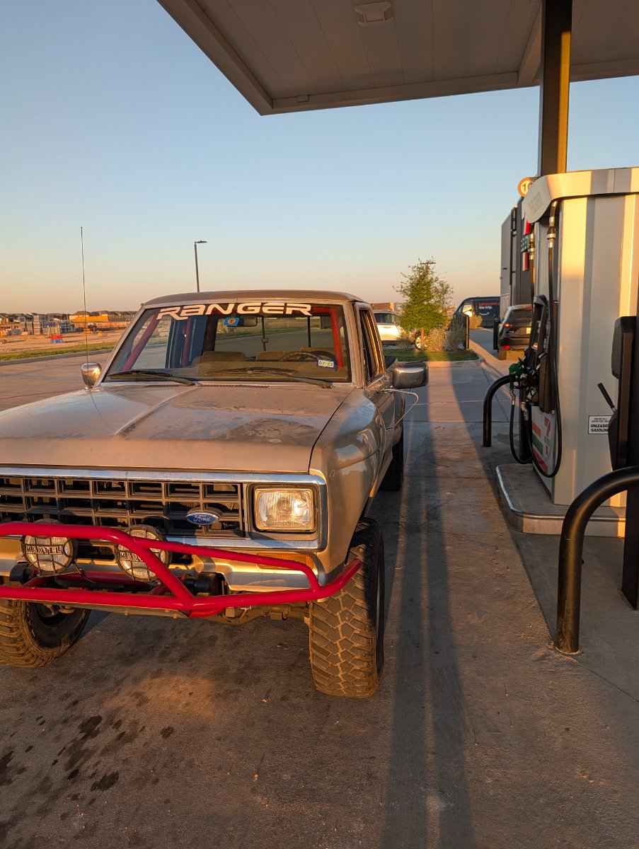

Here a dusty picture of it.
The two Maxtel lights on the front no longer work so I'm visiting my options on upgrades and a good light bar is where I am at.

I'm out here in the DFW area and one thing about those Texas speed limits is, the old 2.9L with the 31s doesn't like to go above 70 much. It has its days.
I was talking with a few of my coworkers yesterday and they had voiced that they would rather see the round style lights stay on the truck as it fits the classic look of it rather than a light bar.
I may just order those Niilights and mount them where the old Maxtel lights were and call it a day.
