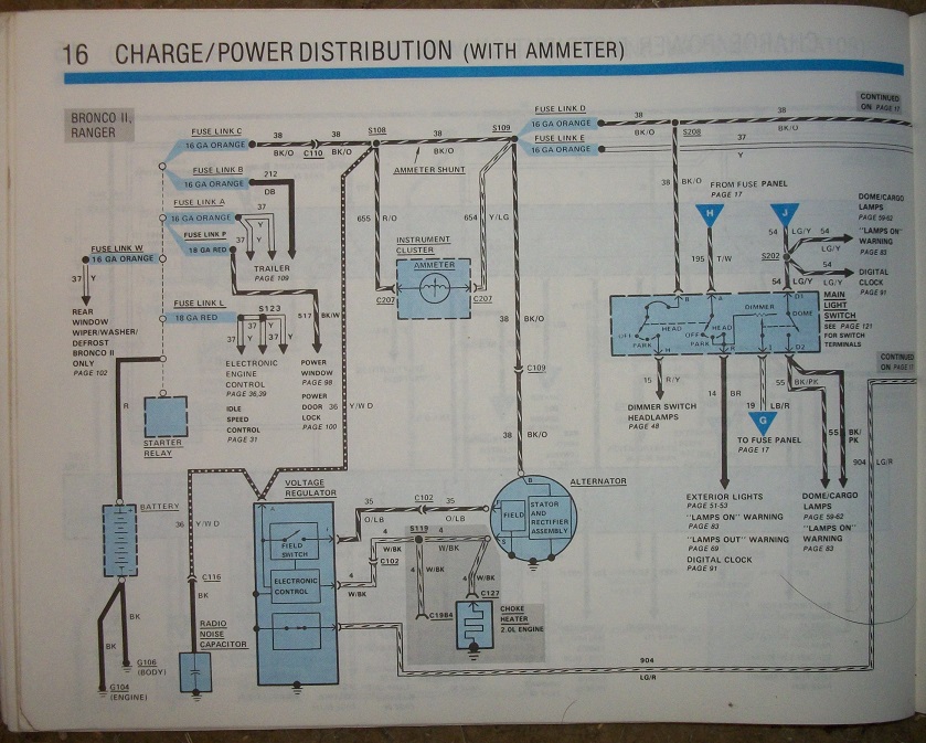

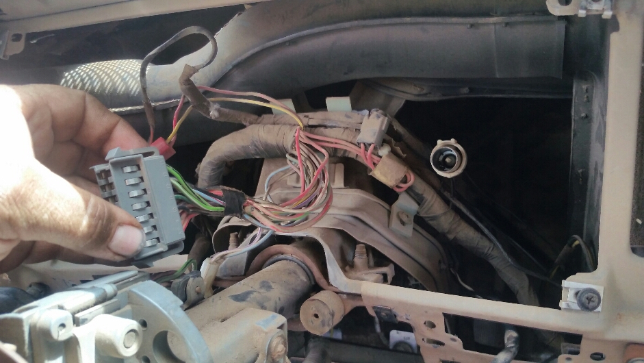

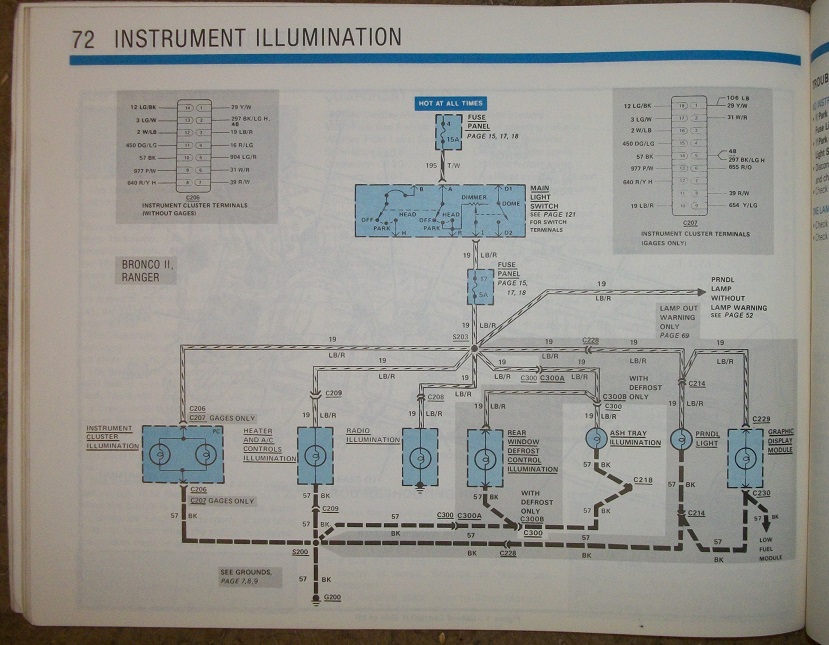

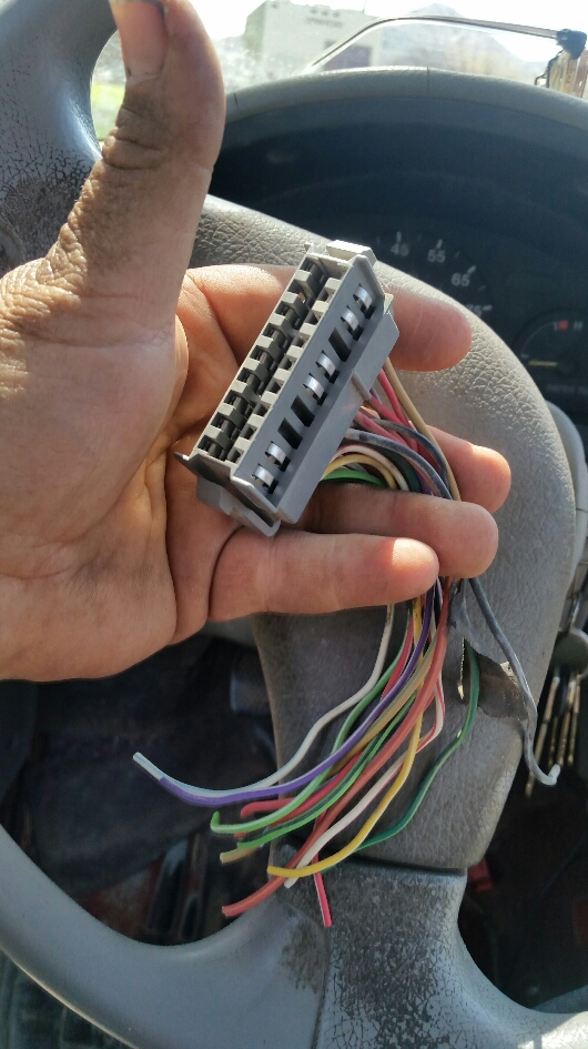

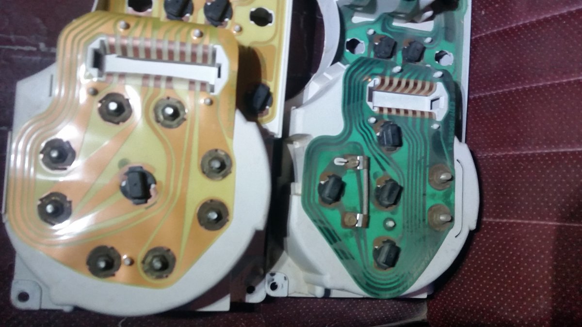

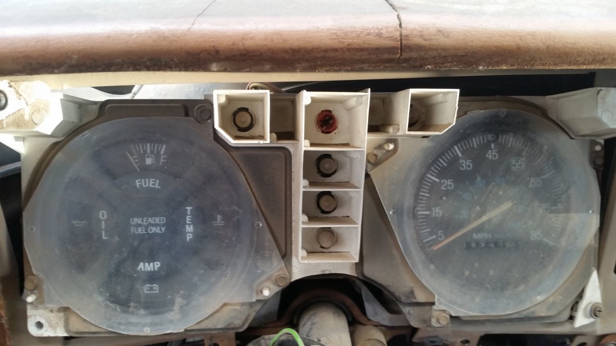

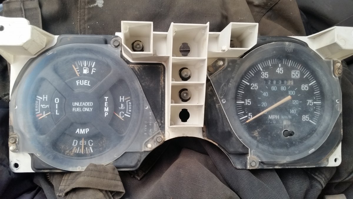

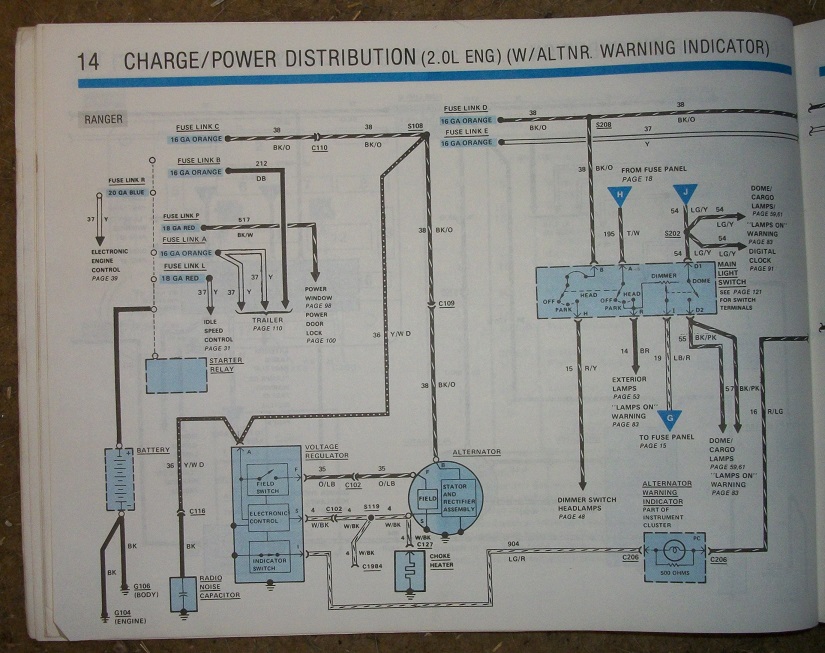

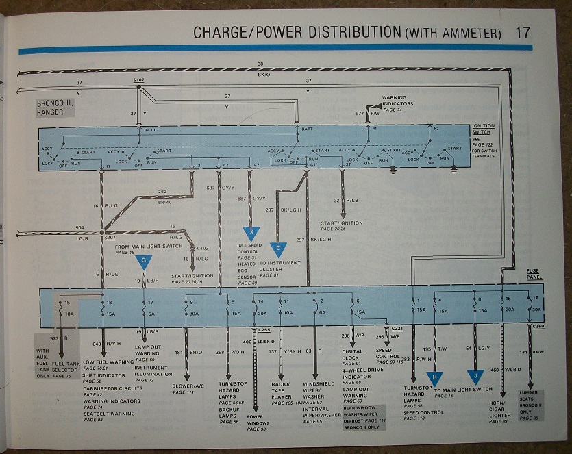

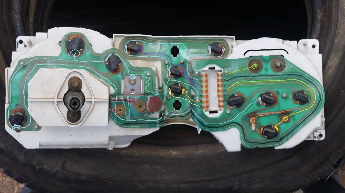

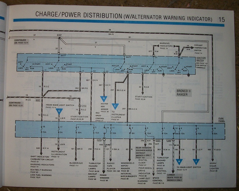

Ok, so my new first gen 1985 ranger has a intrument cluster with just the warning (idiot) lights. When i was in the junk yard today i snagged an instument cluster from a same year ranger that is gauges. It looks to be a direct bolt in. I am wondering what else needs to be done. Can it be as simple as replacing sending units with one for a gauge instead of warning lights? Or will i need to change or modify the wiring harness?
If i swap the custer before i do any other sender/wiring changes will anything get damaged by plugging it in to the harness?
Thanks
Thanks
