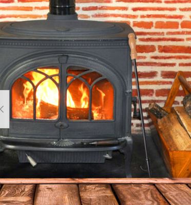

Great picture
Place the wooden handle of the poker against the stove with a fire burning in it.
heat will loosen loctite after a while
"serving suggestion"
I think at this point I’d be inclined to just make my own. We had two sets at our old house, not sure where they ended up after the move but ended up with a cheap set on clearance at Target at one point. The poker is just a length of like maybe 5/16” rod, has a short , sharp 90* bent on the business end and a makeshift handle on the other. Actually kinda prefer it over the traditional hook and spike that sometimes doesn’t let a log roll enough because the spike is in the way, or trying to hook something stuck against the back.
The ones I used to have were probably 1/2" rod (maybe a bit smaller, but not much), they'd curl the top into a little circle, then bend the bottom at a right angle and flatten it out and shape it so it's a bit pointy at the end but not sharp. That's the kind I always had as a kid then had exact same kind later but where it is now who knows, things get "lost" in divorces, heck, the whole papa bear wood stove got "lost". Compared to using a stick, this little one works great, but, I agree it's not ideal - you have stated its shortcomings exactly.
So if you have a forge or way to head up the rod and bend it you are all set. The ones I looked at that were more like what I remember were outrageous price, so, for the price, this is a lot better than nothing, but you're totally right it's not what I'd get in the ideal world. I just don't have but rare need for forge and tools so I never got the stuff, plus then it's taking up shop space all the time so just not worth it.
