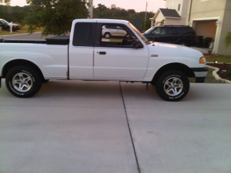

Well the are spacers In and I LOVE it! It took like 3-4 hours for the first one and after that it took only like 1 1\2 for the other side. They went on the top of the coil instead of bottom. Ended up giving 2-2.25" of lift. Ride is a bit stiff, but I believe it's cause I need some longer shocks. I can't wait til I put some 31's on it :icon_bounceblue:

Truck before lift.
Truck after lift.

Here are some better pics :icon_cheers:
you can put stock 4x4 ranger blocks in the rear to level it too, either way it looks good.
