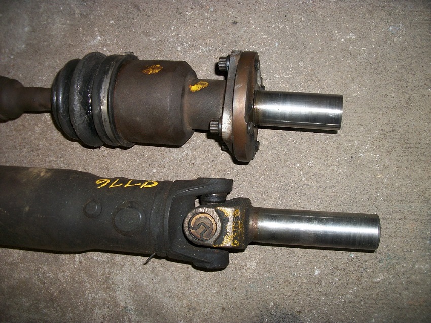

Question: my driveshaft has one u-joint at the rear and what I think is a CV at the front. Is that "single-cardan"? If it is, Haynes manual says 8 to 15 ft.Lbs. ( bolts to differential)???? I'm surprised it's that low. They seemed harder to get off, tho that could've been from age and rust.
No apparently that's the companion flange. AlldataDIY says 70 to 95 for the main bolts. Seems more likely.
Torque spec for '94 2WD driveshaft to axle flange bolts is also 70-95 ft-lb, per the Ford shop manual.
I'm not familiar with Rangers having CVs, especially that late. My Bronco II did, until I converted auto to manual and converted to U-joint. Here's what the difference looks like:
64879
One u-joint is single cardan, two u-joints together is a double cardan, which can be called a constant velocity, or CV, joint. I would think that your 2WD truck should be a single cardan, both ends.
