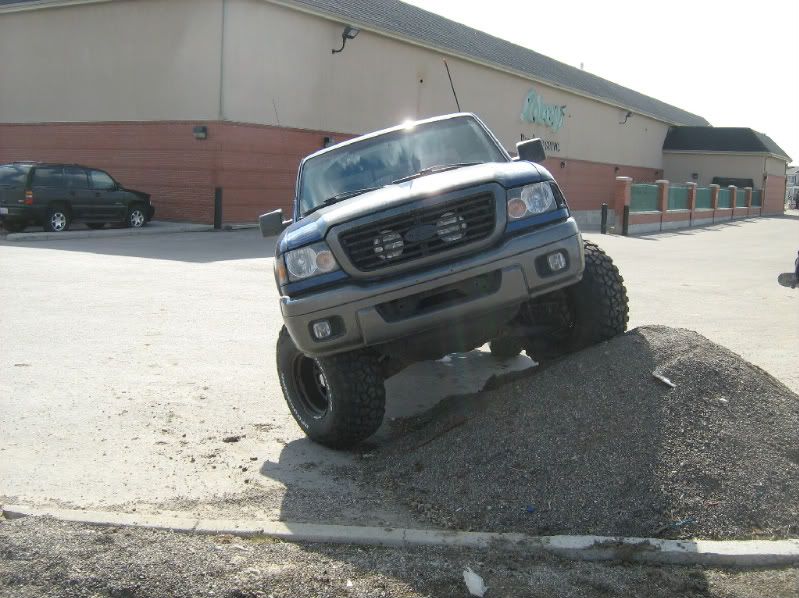

trust me, if you do any flexing, you will see what i'm talking about this is the day i got it all put together, after the lift and the tires...
yeah, i know, poser shot... but i really wanted to flex out and there's nothing near by other than a parking lot with a pile of traction sand from the winter

Hmm. Interesting! What lift do you have? How wide are those? Looks good btw.

the lift is the performance accessories one, for the 98-2000 model, it's cheaper than the 01-05 kit, and is virtually identicle, with only the fuel filler tube being different, and the 98-00 kit not having the ebrake bracket (which i didn't need anyways)
i forget the part numbers pa988 and pa70033 i think? respectively...
tires are 33x12.5x15 bfg km2's on 15x10 us wheel steel rims
