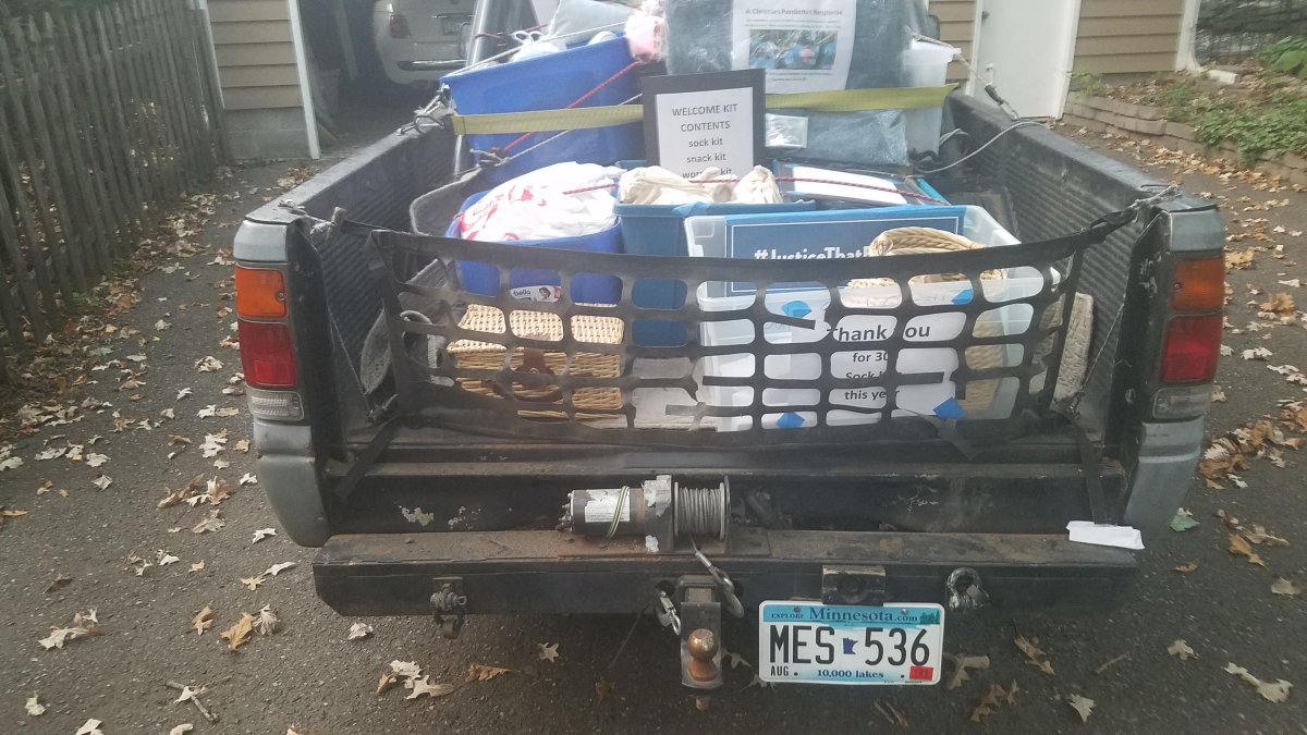

This was an actual Isuzu, 4 cylinders and a 5 speed stick. A friend bought it for me at an auto auction for $1,500. The tailgate had rusted out. I threw it away. I cleaned off the rust as best i could and repainted it with a couple cans of primer. I made the bumper. That winch was very helpful. So was the roll bar actually, very helpful for securing loads. It was from a Jeep,
The whole thing was an eye sore. The frame eventually rusted out. Maybe this explains why I repainted my Ranger both top and bottom.

Ah.. I love the tailgate net! So incredibly '90s lol. I should see If I can find one for my stepside 🤔
