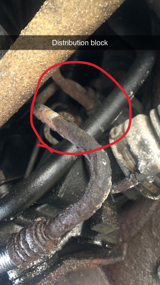

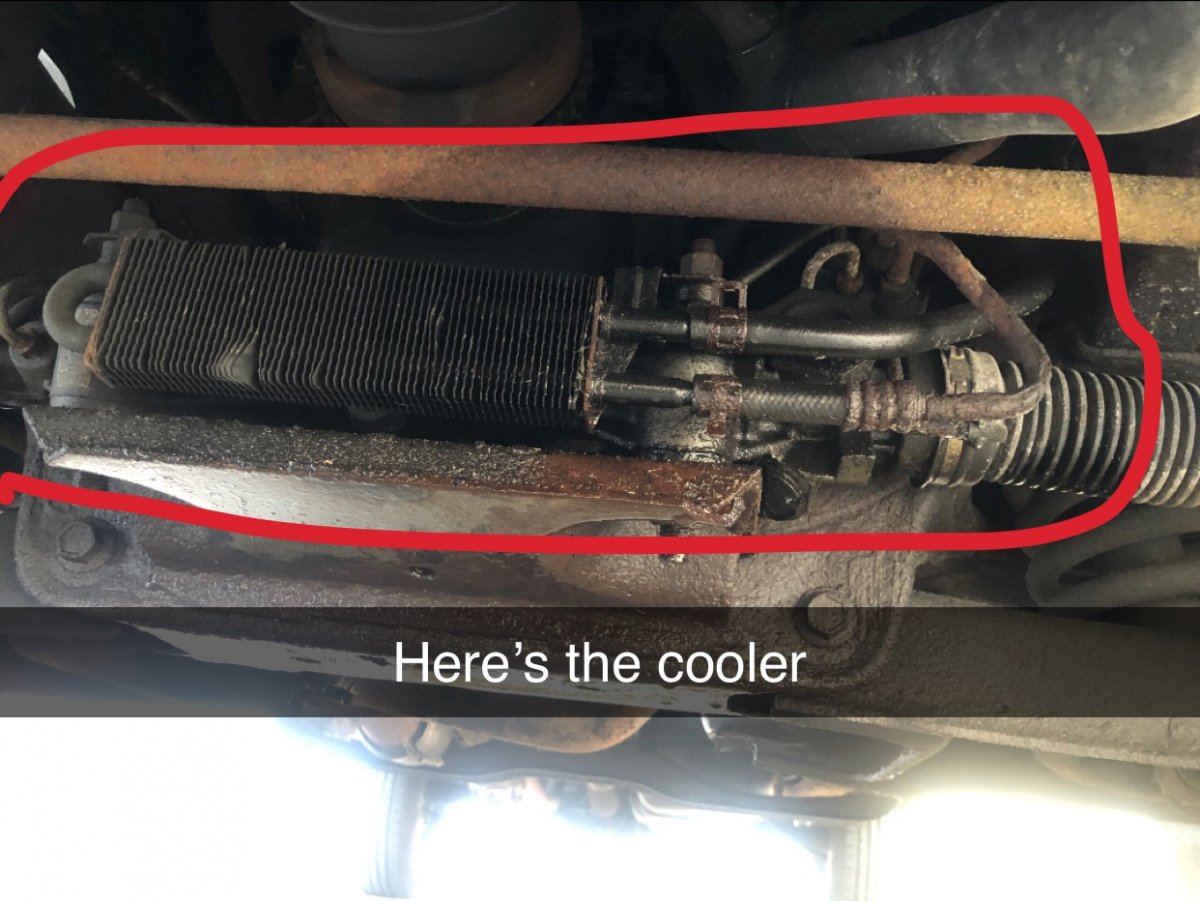

I know this is almost a week old but I figured I’d tell you... my 98 came with one. It leaks like there’s no tomorrow. It looks to have a distribution block, if you will, going to and from the cooler and the pump.

Here’s the cooler and distribution block:
Looks to me like your hoses are leaking, rather than the cooler...wow those are crusty. You could just have new hoses made and use a universal cooler that fits in that spot.
I think that "distribution block" you're looking at is just part of the steering rack, by the way.

also the ‘distribution block’ is on the rack it’s just thats what the cooler hooked up to. I’m guessing that’s the return line coming off of it going into the cooler and then back to the pump.
