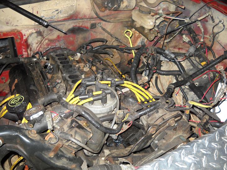

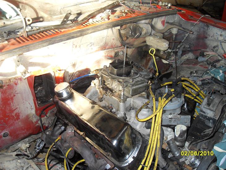

so heres a before and after pic. weiand intake and holley 650 with the new valve covers

You're going to need another distributor. That one's a TFI unit, only advances the spark with a computer's input. It will fire, it just won't advance and retard the spark.
And that's a 600 cfm Holley and you've got it mounted backwards
ah i see. i dont know much about carbs period. before this ive always been more into nissans and subarus. imports in general really. ill have to switch it back around lol. thanks for the tip. i also have the right distributor i just didnt have it handy and wanted a pic of it. thnks for the tip man.
yes. its ok, everyone can laugh at me. but im just learning all this for my self. until a month ago i had never even touched a carb.

:D If you had had a Holley 2x4 intake:icon_thumby:, it would have been mounted correctly. :icon_cheers:
well at least i tried lol
