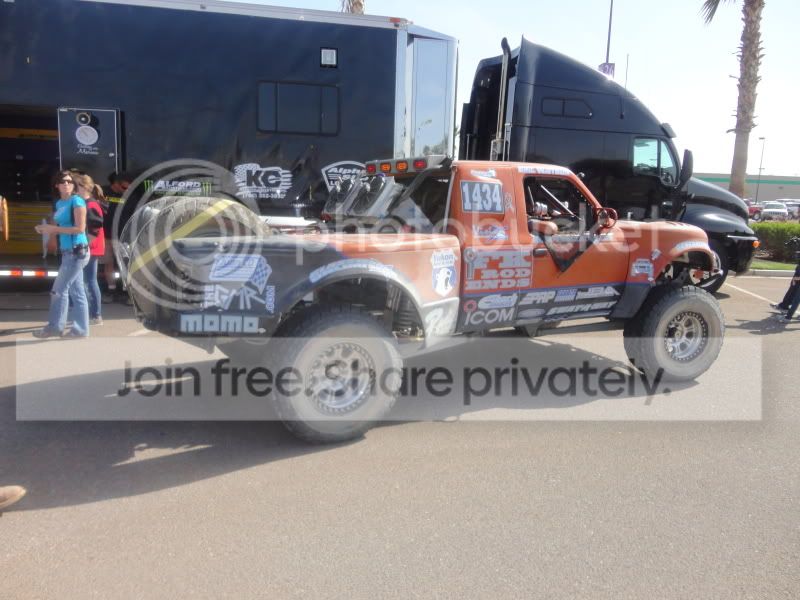

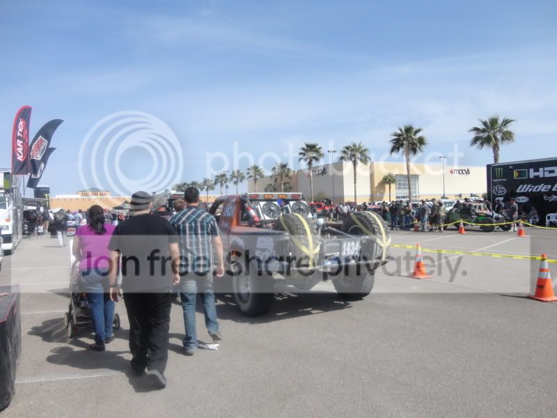

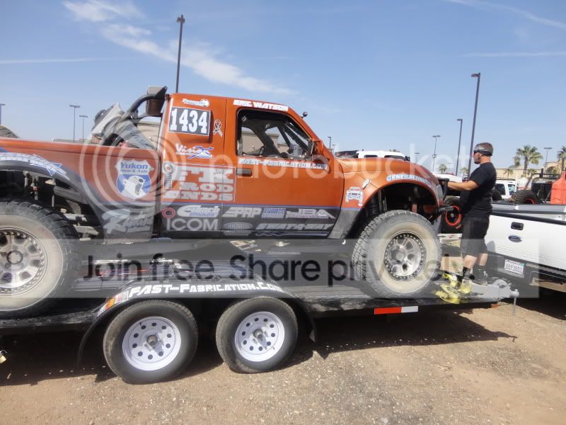

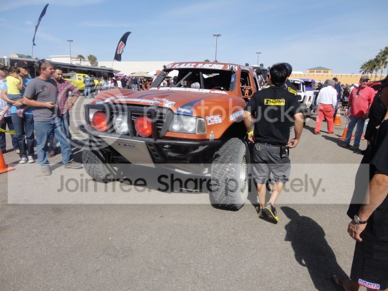

Here are our photos from the Imperial 250. At the end of our first lap we had the flat, which we notice destroyed the rim. After getting the rim dismounted, not only was the rim destroyed but our new grabber with only 40 miles was shredded on the inside. After the second lap we notice we had drastic negative camber, and were down on power by plowing through the sand. On the third lap the transmission went. Tech in El Centro

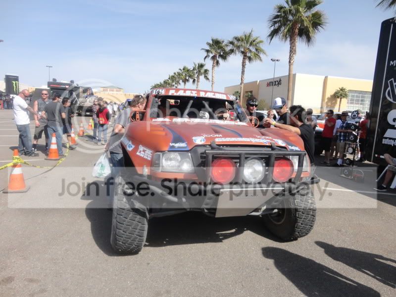

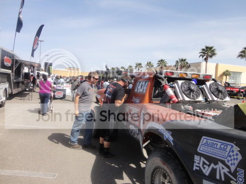

Race day

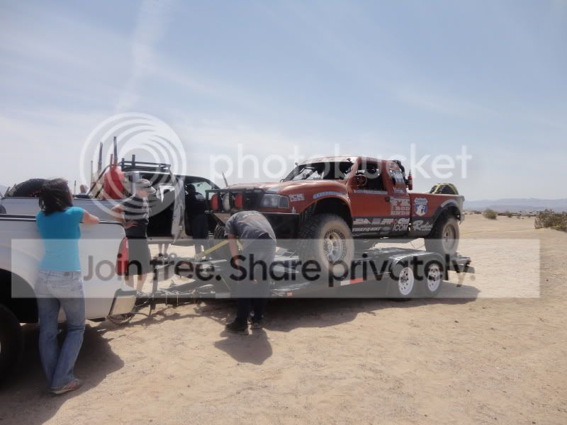

Broken down DNF on 3 of 4 laps, you can see the camber
