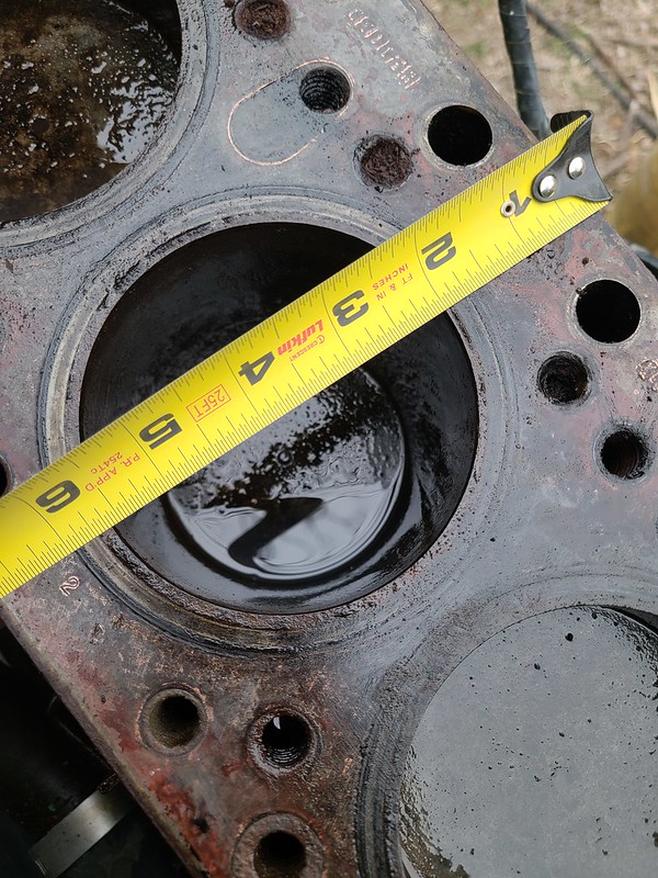

HOWEVER, for giggles I put a tape on the block of the old girl to see if she had ever been rebuilt. And rebuilt she has been.
Farm and Garden
Factory is 3.3125", mine is a hair over 3.5"... which is a lot. I see a Super 77 is 3.5" bore. Researching to see if you can even put S77 sleeves in a 77 block and it looks like you can.
Kinda neither here nor there, dad says whatever it was while it ran great it was no powerhouse. I think he is kinda stunned it has been whooped up...
