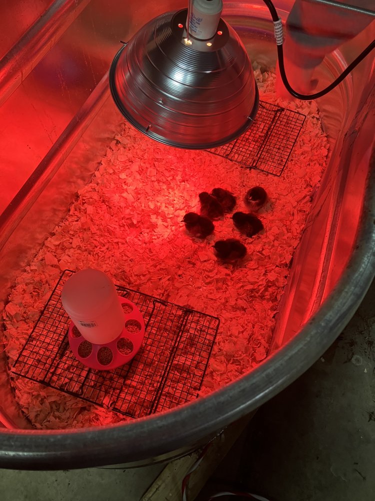

Well today was a busy day. I bought a new 6 x 14 trailer, checked out a consignment auction that happens tomorrow, and made the rounds to 4 different “farm” stores in search of chickens. Rural king had the ones I wanted so I brought 6 home and set up a nusery in the garage. One isnt very active, hope they all make it. The birds were 3.99 each. Wanted some rhode island reds but they were out. the black sex link birds we got are a crossbreed that includes the rhode island. Two of last years birds are the black sex link and are excellent hardy birds. Now to get a new chicken house built, the small coop will go to the new batch of birds once they are ready to leave the garage pen. Last year I bought the same mini water trough that rural king uses for their chicks, works well and much safer than a big cardboard box with a heat lamp inside.

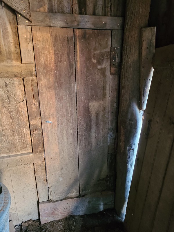

A couple weeks ago I put in a door sill and moved the door up so it is easier to shut. What got them this last time was the ground keeps heaving with the cold/warm cycles and the door catches on the dirt floor. Normally not a big deal, I go chip a little with the spade and get it shut for her. Well that last time we had a big storm coming in, I was busy putting vehicles away and got caught in a weird hail storm with a ton of lightning. I forgot about the chickens and just ran into the house once the vehicles were squared away. So a mink killed all the chickens.
Before, you can see how the door drags.

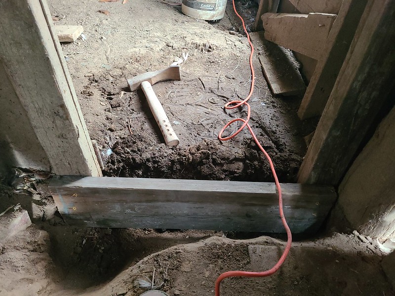

So I dug it out (been waiting for the ground to thaw) and screwed a recycled pressure treated 2x12 to the beams.
Stacked another 2x12 above that.
Then backfilled, cut the hole in the wall out more to move the door up (which was way too short for me) and filled around the door to keep critters out.
Then added a nice latch and auto-returns spring so no matter what the door will at least shut on its own.

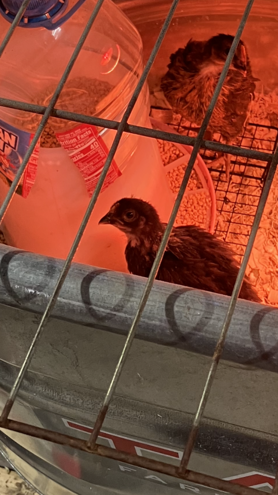

Well today was a busy day. I bought a new 6 x 14 trailer, checked out a consignment auction that happens tomorrow, and made the rounds to 4 different “farm” stores in search of chickens. Rural king had the ones I wanted so I brought 6 home and set up a nusery in the garage. One isnt very active, hope they all make it. The birds were 3.99 each. Wanted some rhode island reds but they were out. the black sex link birds we got are a crossbreed that includes the rhode island. Two of last years birds are the black sex link and are excellent hardy birds. Now to get a new chicken house built, the small coop will go to the new batch of birds once they are ready to leave the garage pen. Last year I bought the same mini water trough that rural king uses for their chicks, works well and much safer than a big cardboard box with a heat lamp inside. View attachment 89255View attachment 89256View attachment 89257

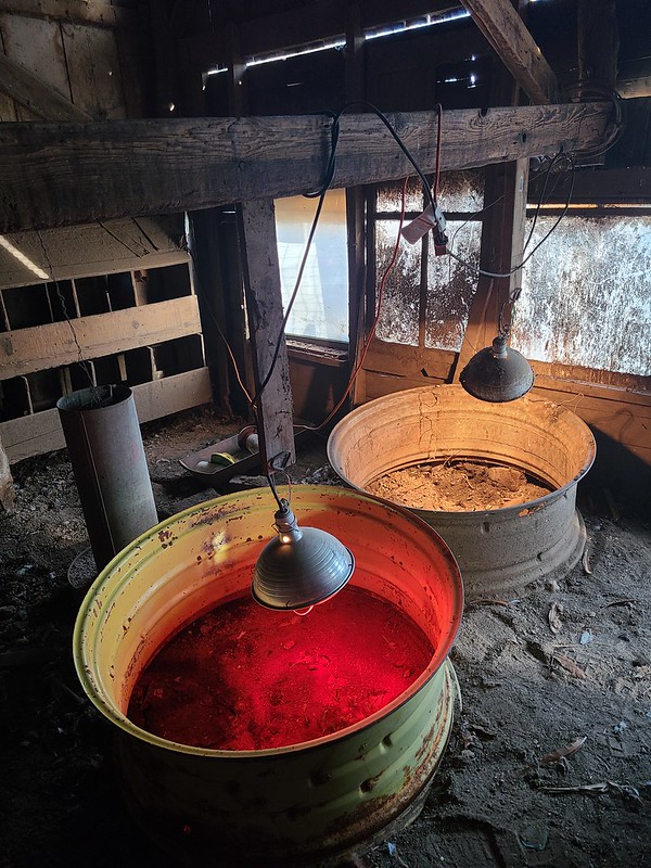

Got all the tractors out of the barn so if needed I can cram vehicles in there for spring/summer/fall storms again.

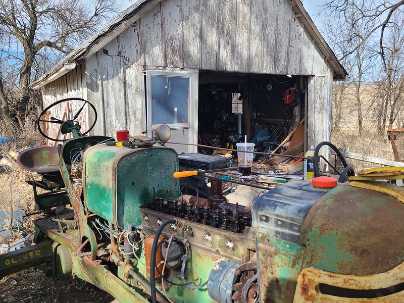

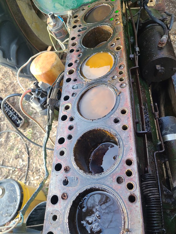

Started sorting in the garage and had an idea, offered to see if dad would want to help me break this Oliver loose. Getting kind of tired of weed eating around the thing. He happened to be driving by and swung in so we got to it.
He made a hose eons ago that connects the hydraulics from one tractor to the spark plug threads of another for to break them loose. Don't get crazy on pressure and generally at worse you blow a head gasket and at that point she is stuck enough who cares.
So since I had my JD B out (A-C ran a crazy high hydraulic pressure so my other two were out) we made it happen... and nothing happened. Switched from #3 to #4 and neato, we have hydraulic oil coming out the exhaust pipe.
So we were done....
Or are we?

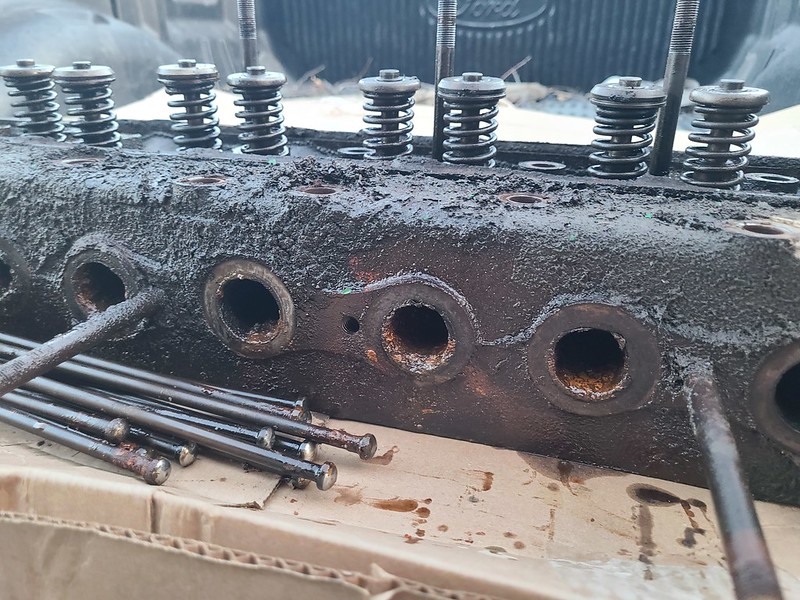

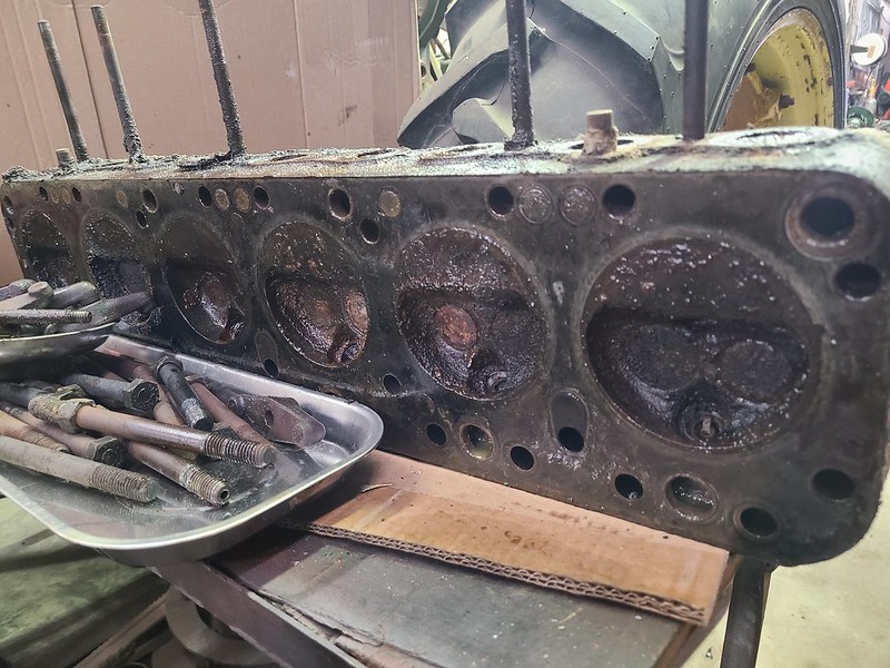

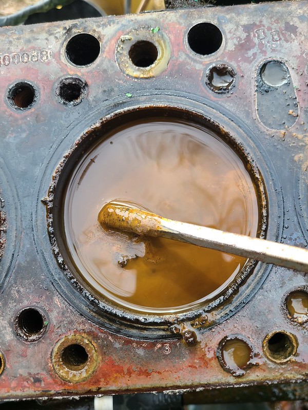

Dad pulled the thermostat housing and I rattled off the manifold and headbolts with the impact.
Bores are scummy but smooth. Hone and go.
Headgasket wasn't blown and nothing seems to be broken from freezing. It did hold coolant like it was supposed to.
Copious amounts of trash in the bores though. Like rust flakes I am guessing from the exhaust manifold. Even if it broke loose it would have probably screwed the valves up more than they already are. Our current theory is the valves are not seating enough to hold much of any pressure. The B didn't pull down at all when we were putting it to it like the hydraulics were deadheading against something, we were almost questioning if it was working right.
So I loads it up and take to my dad's shop so we can touch up the valves and clean up the head.
It is so weird, it looks "oh my god" terrible but for the most part it just wipes off.
So we are staying cautiously optimistic.
