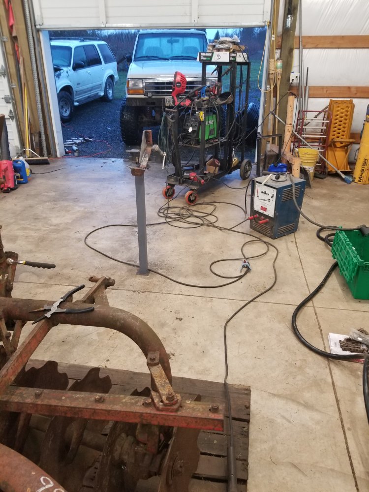

I mowed with the tractor a week ago, then I moved my Massey Ferguson model 25 3 point disc into the shop to get worked on, I got it cheap at auction (I think $250) but it needed work, it was missing two pins on the ball ends at the ends of the gangs and had some bent stuff and just needed general cleanup, all the bearings were dry and rusty so I apparently get to pull all of those apart... So far I've rebuilt the one piece that was missing, replaced 2 of the 3 pins that need replaced and have two of the 8 bearings cleaned up. Still need to straighten the one twisted piece of 3/8" by 3" bar...
It's sure nice working on it in the shop, it's been in the driveway for 2 years hoping I would work on it, it's been in the shop for a week and a half and I'm 1/4 done... Next no rain chance I get I'm going to drag the AC/DC stick welder to the shop from the garage though, that AC only Thunderbolt isn't my favorite, and I'd sure like to use 7018 on some of the next parts... Stick welding on 3/8" plate is better than wire welding so that's why it's out... The first pic is already in disassembly, I did drag it into the shop on the 3 point on the tractor so it's not at bad as it looks :)

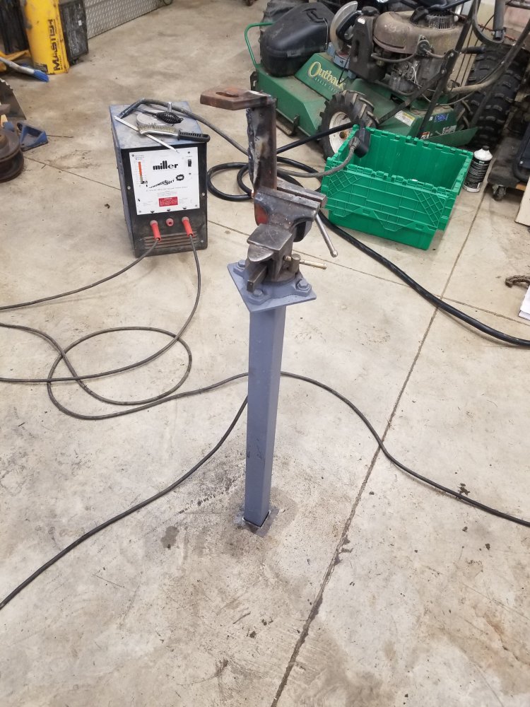

Is that vice on the post removable? Did you set sockets for it in other areas of the shop so you can move it around? Cool idea.
I’ve seen guys mount their vice and other things on square stock, then attached reviver tube around the shop, various benches, so they can move it wherever they are working.
I’ll see if i can dig up some pictures.
Yes, I put 6 receivers in the floor and made caps to fill the holes while not used, couple months ago I made posts to mount the vise and a bench grinder on, they're pretty nice to be able to walk all the way around something...
