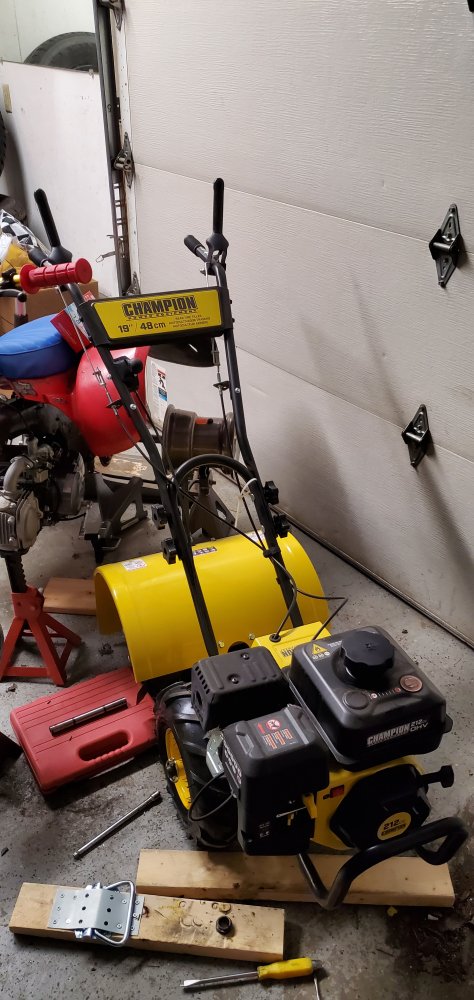

I bought a thing! (Bad picture sorry)
The plan is to make some money on the side getting people tilled for the season.

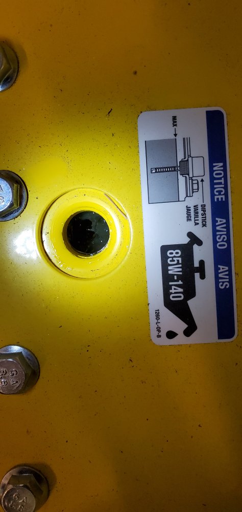

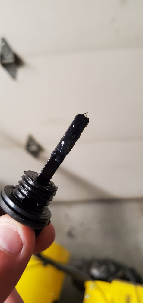

How thick is 85-140? The manual says it comes with the trans full of oil.. but it just looks like grease to me.
I don't remember any gear oil being that thick.
A lot of the time, previous owners will pump the case full of grease if it leaks gear oil. Tillers are notorious for leaking oil around the tine shaft bearings/seals. They get beat pretty hard. I've been through numerous tillers over the years and have seen pretty much everything on them break at one time or another. Especially front tine models..
If it's a brand new store bought unit, and it's pumped full of grease, then I'd be taking it back to where I bought it.

Ya gotta wait til the ambient temperatures get up to "t-shirt weather" for that oil.
Gear oil will flow, even thick 140 wt. That looks like grease. How cold was it at that time?
It was close to t-shirt weather.. for maine anyways. Must of been 50° or so.
Whats the best way to get all this grease out to refill with oil?
Run it for a few minutes to get some heat in it, drain & fill?
Put whatever oil I can in it first, THEN run and drain & refill?
I'd first try running it to warm up what's in there. If it won't flow out of the open drain port on its own, you can try pushing it out with compressed air into the fill (dipstick) hole. Make sure that you set the compressor outlet air regulator to only a couple of PSI, and seal around the blowgun nozzle with a rag.
John Deere cornhead grease is awesome for this. It is low temp so it turns into something resembling oil fairly easily but congeals back to grease so it doesn't run everywhere when you are not using it.
85-140 is only 5 more thicker than 80-90, it should be like your normal old gear oil.
Cool ill try warming it up first. My compressor is pretty much the last thing I need to move over to our new place. Ill hafta wait until its done raining.
