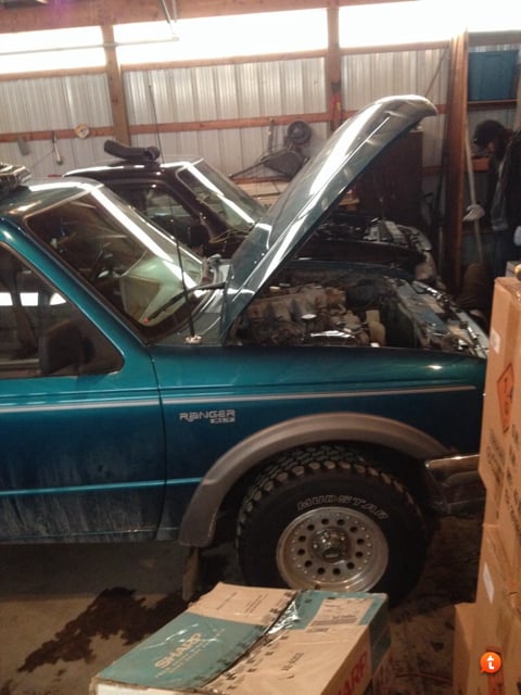

My two new rangers a 2000 4.0 2wd std cab
N a 94 4.0 4x4 man trans :D
There both getting head gaskets right now
