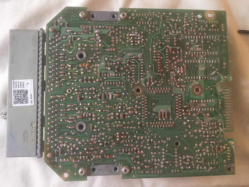

Pins 20, 40, and 60 are all less than one home to ground. I measured pin 52 to ground and it showed open. Then I grounded The yellow wire at the connector, and measured from the computer pin 52. I showed a ground. The wire is good. I plug the solenoid back in and turned on the truck and I have battery voltage at pin 52. Sounds to me like my computer has issues. I noticed a “Reman” sticker on it. I will pull it out and inspect.
Pulled the computer and opened it up. Nothing looks amiss in here. All the caps look good (none swollen or leaking), I don't see anything that looks charred or burnt but it is dusty and there is a little tiny bit of de-lamination with the protective coating in certain places. No burn/Hot smells, either.
66720
66721
I did notice on the computer, near pin 52, there is a mark, like someone else has been in here...

Another thing I am wondering, when I run this part number, it shows it is a Cardone remanufactured ECM for 1986 Ranger with Manual transmission, CA emissions, and part number E6TF-DA, FA, MA, MB, MC. I think my truck DOES NOT have CA emissions and the part number starts with E6PF-MR.
