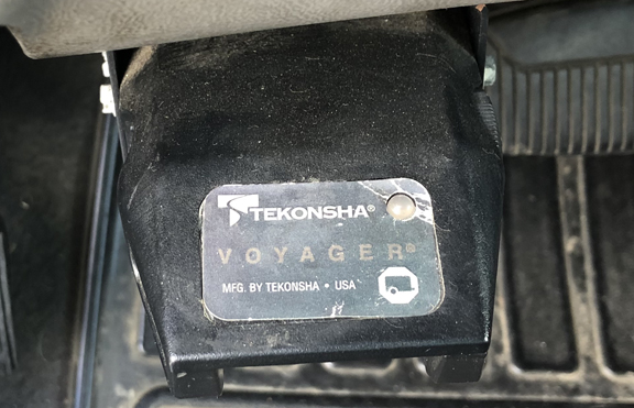

Sweet that does thanks! No part number stamped on the hitch? Any photo of the connector (that black square on the 2nd pic appears to be it, but that's a cover?)? Also, nothing inside of the cab interior that's stock related is there?
Nothing in the cab that I'm aware of. My brother had a trailer brake added when he bought a job site trailer.
