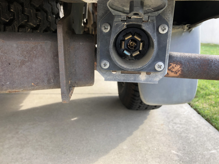

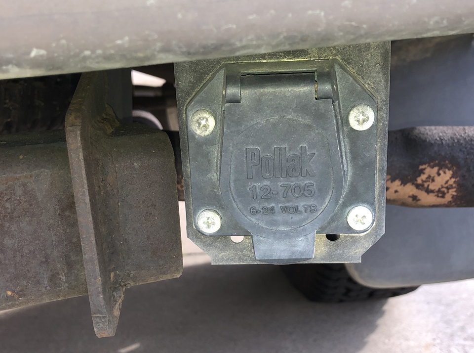

@Josh B do you have pictures of your factory tow hitch with the interior connector? I'm in the market for one and I'd prefer stock if I know what I'm looking for.
What's the interior connector? The only connector I know of is the one that's plugged in between the L & R tail lights and has a pigtail coming off that that goes to the trailer connector.
Is that what you need to see?
Yes, that one.
If you have part numbers that's big plus ++++

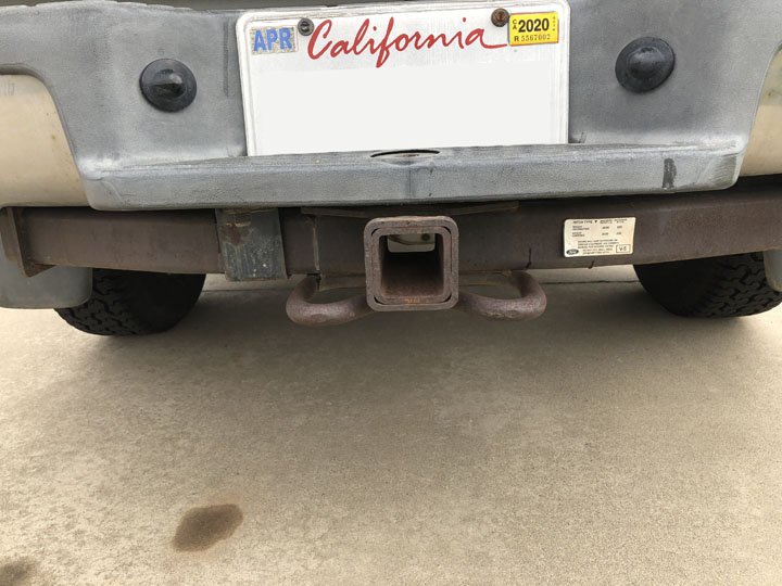

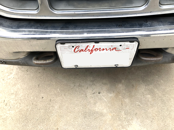

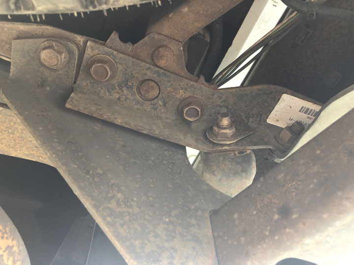

Glad You asked. Yes I do see attached.
It also comes with very beefy recovery points on the front.
.View attachment 35473

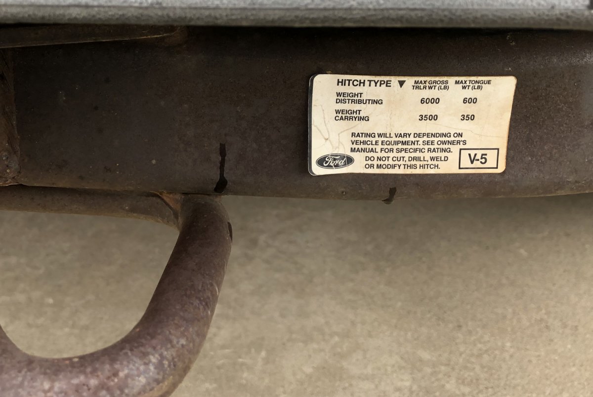

This may, or may not, help. Here is the factory tag attached to the hitch.
Sweet that does thanks! No part number stamped on the hitch? Any photo of the connector (that black square on the 2nd pic appears to be it, but that's a cover?)? Also, nothing inside of the cab interior that's stock related is there?
