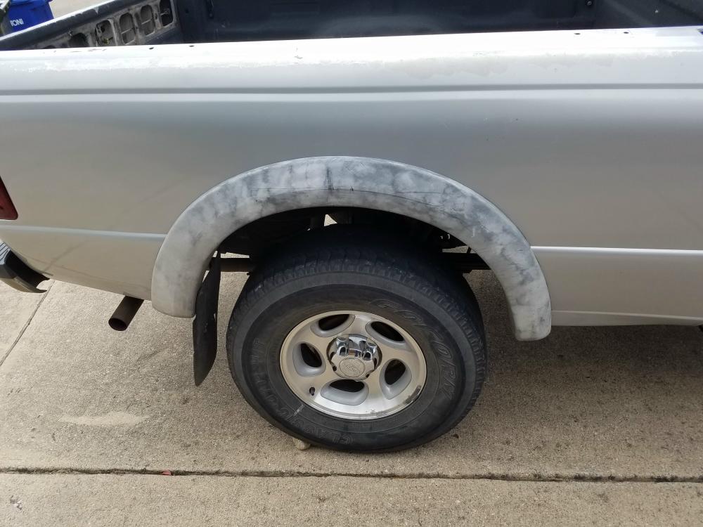

My '99 black ext. cab "Sport" came with the gray flares + mudflaps... they've held up extremely well to intense UV in NV, AZ, and FL, but... are starting to get those cloudy white lines in them... will look even worse when I get ze truck painted... thinking of making them a flat/matte black against the (soon-to-be) shiny black... or maybe... TAN? o_O
Seem to remember a few years back 'round these TRS parts, folks was enamored of some company's "plastic dye", as rattle can paint applied to that factory-molded pebble-grain was coming out not-so-great.
Anyway, fill me in, set me straight... thanks in advance.

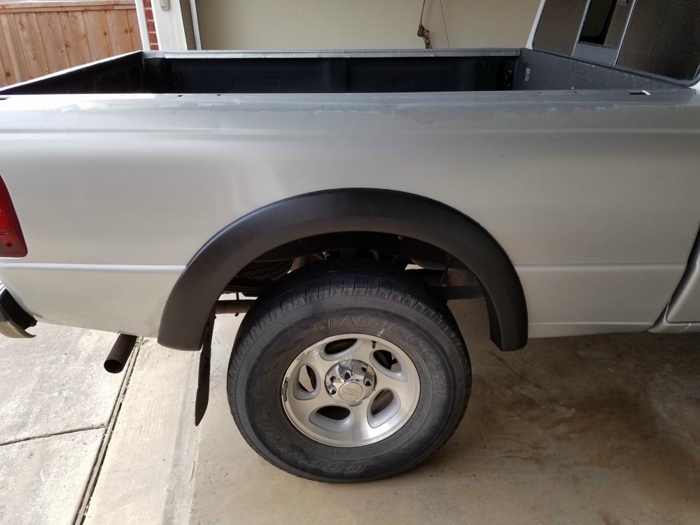

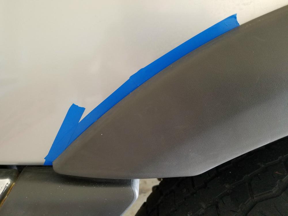

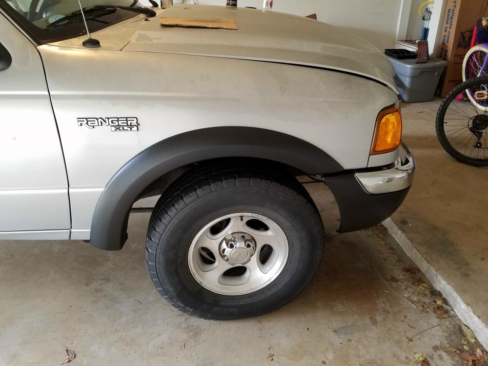

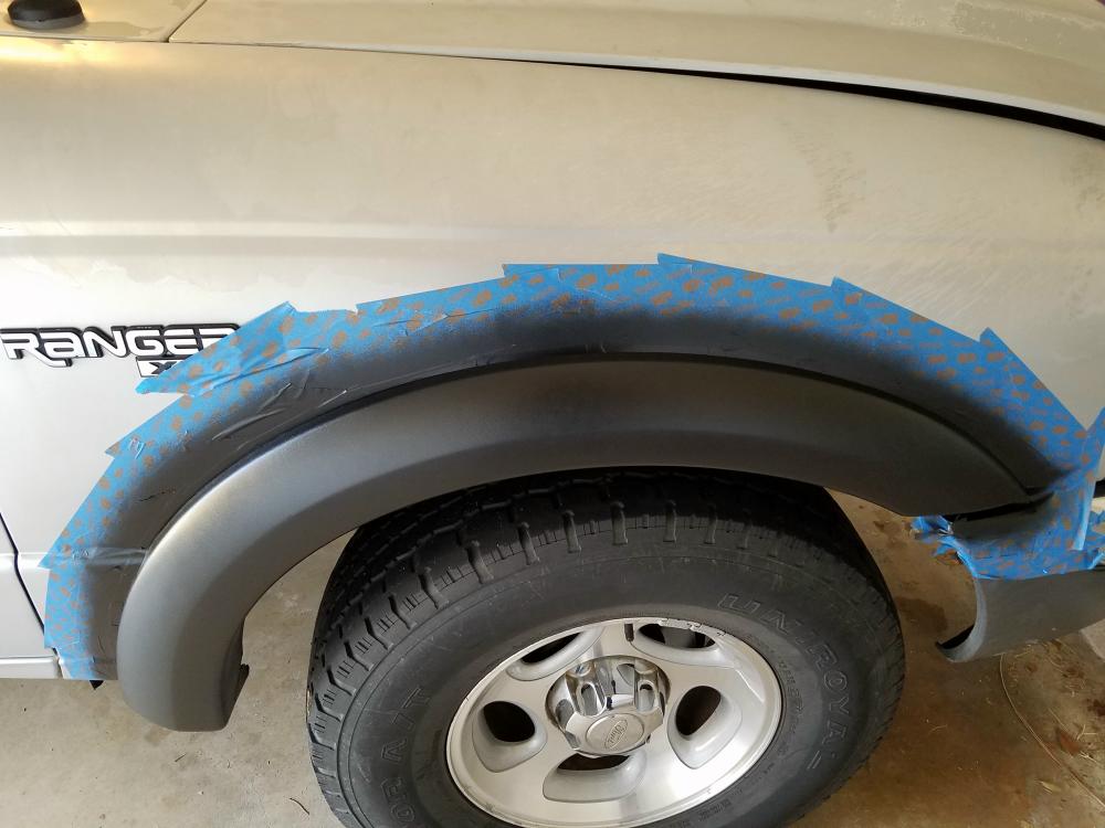

I bought a Ranger that had faded factory fender flares. I masked them off right on the truck and painted them and the plastic bumper cover with satin black Krylon fusion paint. Looked like a new truck when I was done.
