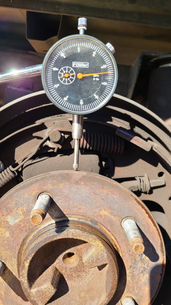

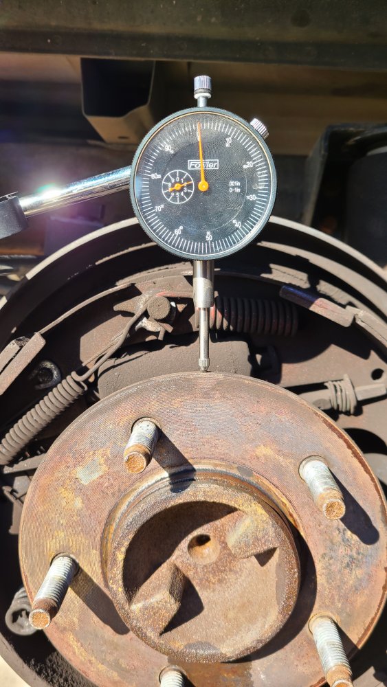

So I just put the rear on Jack stands. When I lift up on a wheel, I get what seems like a lot if movement. Happens on both sides. Took passenger side wheel and drum off and set up dial indicator. I have about 0.023" movement up and down. No indication of leaky seals yet. Is that too much play? Or normal? Seems like a lot to me. I have a lot of long distance driving to do over the next 6 weeks. Don't want to get stranded. What do the experts think?

Only .008" on driver side. I think that answers my question. Passenger side bearing needs replacement. Should probably do both anyway. 155,000 miles on the truck.
I couldn't seem to find that spec in my Ranger Manual... But my guess is it's way too much.

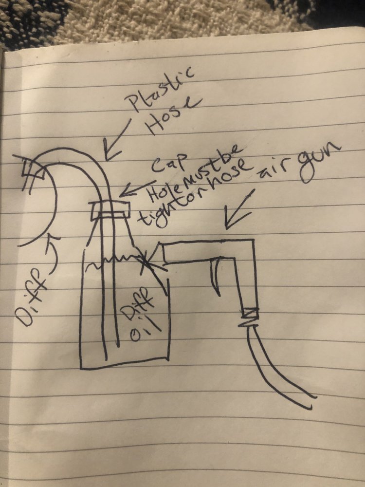

easiest way I found to get the gear oil into the differential. As opposed to trying to pour in in from the bottle and spilling most of it on my head.
The compressed air pushed the oil up the hose and out the bottle into the diff. Set you air regulator to like 5-10psi.
Cool idea. I usually use one of those little hand pumps that screw on the bottle.
