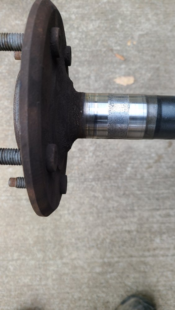

Oh, crap. Well, I ordered repair bearing/seal assemblies that would move the bearing to a different area on the shaft journal. But upon seeing this, I don't think I trust it. The seal has started making a groove just over 0.001" deep. I can feel it. That's right where the new bearing rides. Inoffensive to the junk yard to scavenge a new shaft. Only 21 F150's to choose from in their inventory.

I got some practice doing that job. 4th shaft I pulled looks usable.
that many bad shafts says either a tonnage of miles or oil not quite heavy enough, maybe even not quite enough hardness of the metal- maybe all of the above.
Most had digital odometer. So I didn't know the mileage. The one I bought came from a 97 with 186k miles. That was the oldest I looked at. 2 of the ones I opened, including the one I bought, the oil came out very clean looking as if it had been recently changed.
