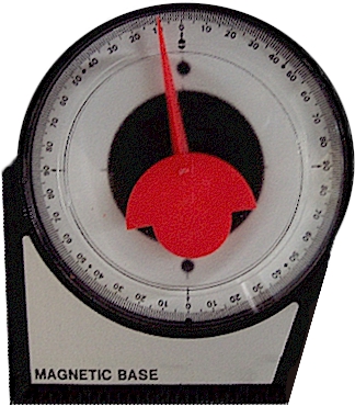

I'd do just a 1" spacer, anythings better than nothing right? Jack the truck up 1.5" on the frame and see how far it puts your aligment outta wack. I used a degree'd level (sextent?) and found out how high I could go before I was past 3.5", which is the biggest aligmnet bushing you can get.

ya, im deffinatly doing the coil spacers. i've been looking at trucks here and on the tech section and i like the easy application and its bassically free becuase i allready have the stuff to do it. where do you recomend to jack it up at on the frame exactly? use two jacks? and how much on average does an alignment cost? i think im going to do it before i get new tires so i can see just how much it does wear them down becuse my tires are pretty much shot now. The tops are just about gone but the sides have about 1/4" left on them. and on average how long does it take to complete this application? I have just about every tool you'll ever need and i am mechanically inclined. what size of washers is it agian? 3" OD and 1 3/8th" ID? how did you use the degree level? i've never used one before.

5. I didn't know really what to call it, but I found a pic of one I'll post below. I held it againt the wheel mount surface before and after, with the wheel off and weight on the truck on a stand under the diff. I used 1/4" plate's and worked my way up until I got the right height with my coils and spacers to give me the proper lift height without having to change alignment bushings.
