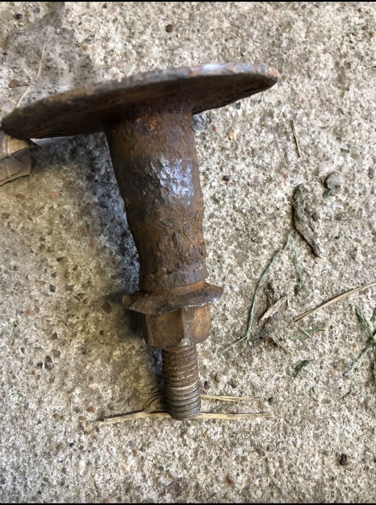

The hardest part was using a 5 lb. hammer and large a drift to beat the lower retainer out of the rear-most mounts. I used my version of the 'extractor' on the mid-mounts and the ones up front just unthreaded.
