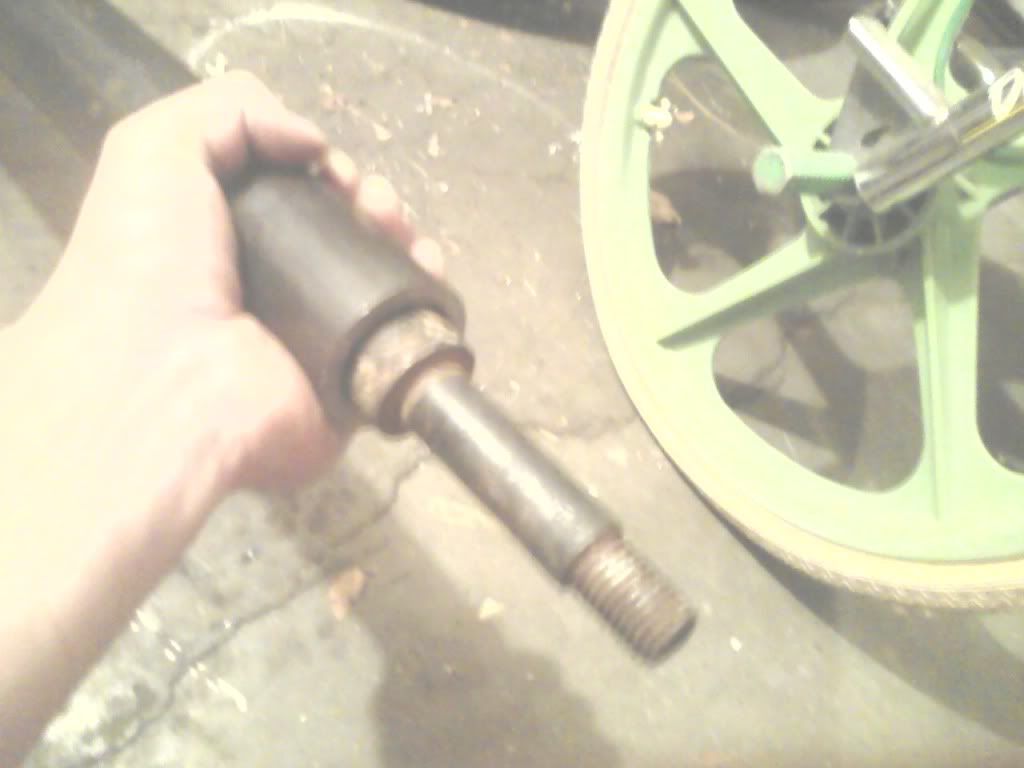

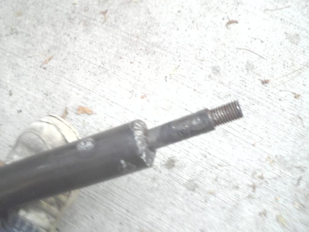

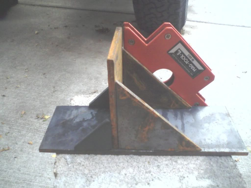

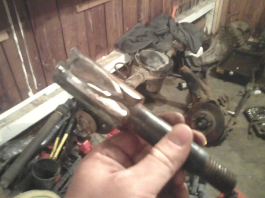

heres a few pics. I think Ill do my own write up on em when theyre done.
basic idea for the bracket 1/4" plate
what I cut off
initial fit
drilled (twice) to get four holes in an X pattern and layed some bead
one down one to go
Looks good!
Looks like you bring one more bead down onto the original stud, as it looks like theres a gap.
Remember, that original sleeve is only welded on in one spot on the stud, so I'd like to see your weld come down and tie with the stud and not just the sleeve..... But thats just me.

I just dont want it (weld bead) to interfere with the way the bushing sits against the end of the stud. Ill take another look at it, if I can get away with another pass ill do it.
I didn't weld the stud itself any further on mine...
I figured if it was good enough for Ford to use it like that on 10,000,000 of these trucks (just guessing), that it should be OK. So far it's been fine (and I've landed them on rocks many dozens of times now, they got plenty of rock rash on the bottoms now :icon_twisted: )
Yeah that makes sense...
I guess it's just that anytime I have chance to beef something up with more weld, I do it! :icon_thumby:
