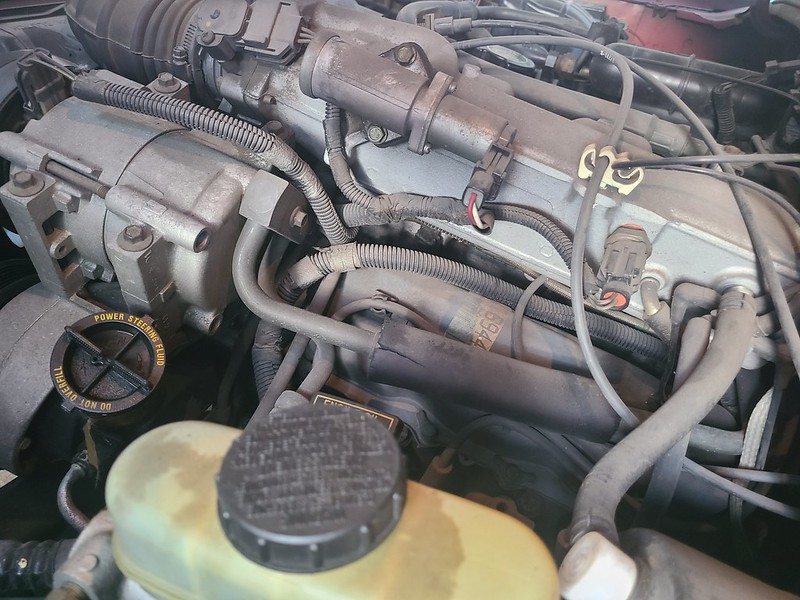

I've got everything together to get my a/c going again. Just trying to determine what radiator will work best for me (another post). I'm using an Explorer compressor, dryer, and related hoses (rock auto). I'm using the stock BII condensor and evaporator. I'm using a stock BII evaporator-to-condensor line. I'm using the Explorer compressor manifold hoses, with the condensor end modified using the stock BII fitting. A local hydraulic shop did the cutting and welding (see pic). The radiator is the issue for me at this time.
Hope this helps!
Mark
61560
Hope this helps!
Mark
Evaporator end fits the older evaporator?
Have you done any test fitting yet?
Explorer a/c dryer is a direct replacement and screw-on to the BII evaporator. One of the compressor manifold lines goes to the condensor (modified) while the other goes to the Explorer dryer (direct fit). The stock BII line goes from the lower evaporator connection to the condensor (direct fit).
I have done test fitting and all things "appear" to work well together.
Once I get my radiator issue resolved I'll post everything I did with pics.

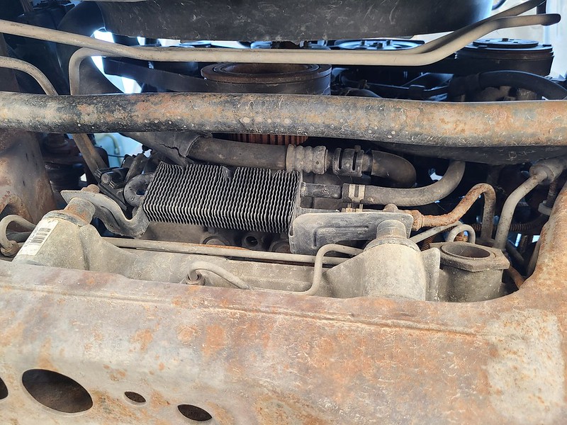

Well I actually hit the JY and looked at various systems looking for inspiration.

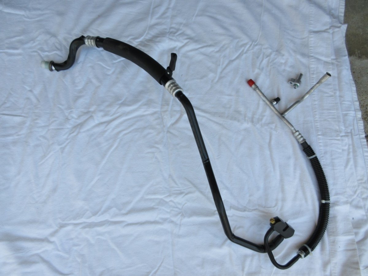

The Explorer "hose" isn't as much hose as I thought it was. It seems most of it is rigid, not sure if it is steel or what but I couldn't cut it with a knife.
It has a big dogleg in the hose off the drier to drop it down. Relative to the body even with the bodylift I think my engine sits a lot higher, guestimating I think the dogleg would put the hose about even with the bottom of my alternator.
I am also not sure how it will fit with my old vacuum advance distributor.
The '98 4.0 with the big hose @Shran mentioned has a ton of potential. It goes down under the engine and back up on the passenger side. Compressor mounts similar to the 5.0. Not sure why they didn't use the same hoses really. Anyway that would be a clean option to keep the crossover hose out of sight and it seemed to have a lot of "hose" to it for wiggle room.

You should also check out the hoses for a '94 Crown Victoria - they apparently have the FS10 compressor and the manifold block on the back of it can be purchased as a separate piece with little short female quick connect fittings on it. I betcha you could use that and easily find some hoses that would be long enough or have them custom made... a LOT easier than trying to find the one piece 90-94 4.0 V6 style mess we have been talking about.

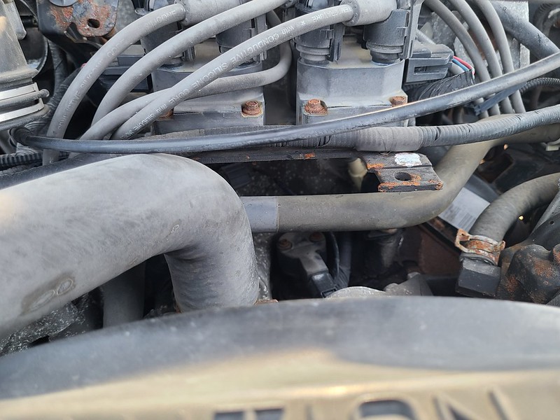

My FIL came home last night so I could check out his '91 4.0 Ranger, it turned out be an earlier one with the around the back hoses.
I think I could get the hoses to reach but with all the hardlines it will be hard to twist the manifold enough to line up with anything.
1. The F-150 setup I think would work, I might have to shorten the big hose but a splice is easy. Still have to deal with the condenser end though.
2. Just run a FS6 compressor (if it will mount up to my bracket) from a 2nd gen 2.9 with separate hoses. Condenser hose will drop in, suction hose might need extended (or it might not if I reclock the big bent elbow coming off the drier) How it will play with my intake though... I don't think it would work. Could still do a totally custom hose.

Seriously check out that 94 Crown Vic hose setup. Of everything I have looked at yet, that looks the most promising for making custom hoses and using a compressor that will bolt up to your bracket.
