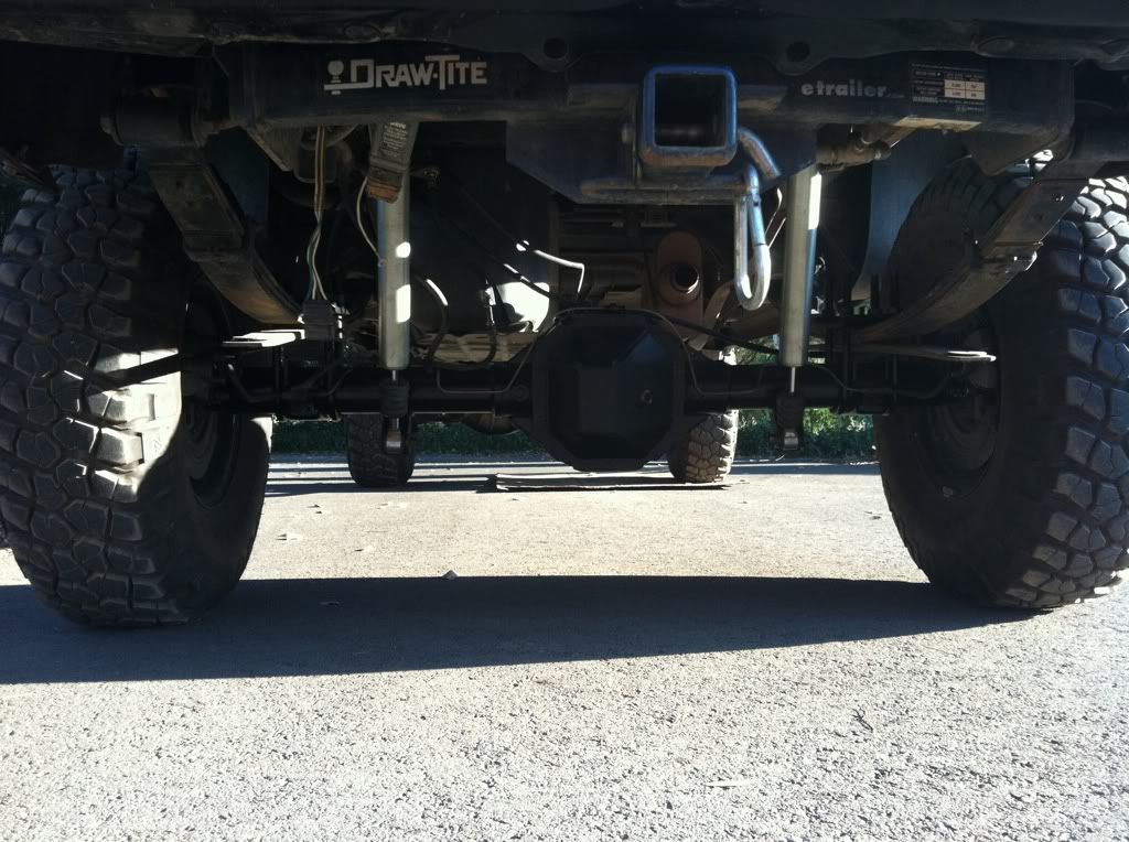

I cut off the sway bar mounts (not needed on my application), welded on custom spring perches with about 3/4" of lift built in, and made shock mounts out of some plate metal I got from the recycle yard near me ($.50/lb)

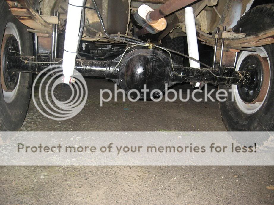

I ditched my rear sway bar years ago, and found no noticeable difference once it was gone.

I used RuffStuff spring plates, u-bolts and diff cover. Beefy stuff!
For shock mounts I used some generic ones like this:
Later I fixed the pinion angle with some 2.5 degree shims. :icon_thumby:

scotts90ranger and legoms013 thanks for post pics of your setups. If I end up running without a sway bar the pics will be a good guide for me. My truck is a workhorse daily driver that has to meet alot of needs so I prefer to have a sway bar on it, but it good to know that it is possible to run without one. Still looking for someone with the explorer sway bar with aftermarket weld on shock tabs and aftermarket spring plates in a spring over axle configuration?

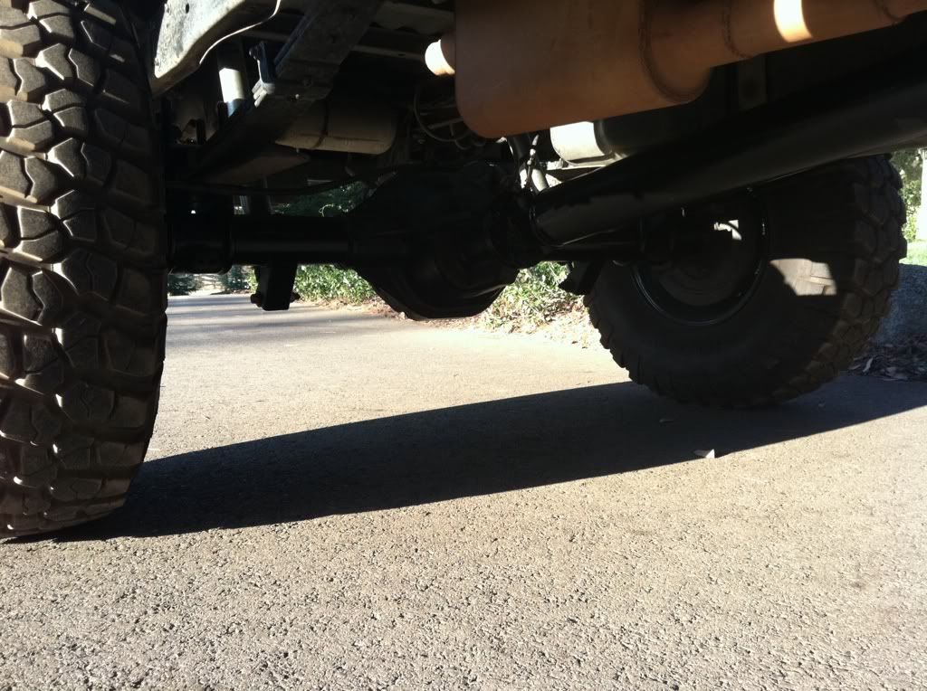

Honestly my truck has had a VERY VARIED past, stock 4x2 grandpa mobile with 3.08 gears and 24" tires, 3.73 gears with 28" tires, stock 4x4 with 4.10 gears and 31" tires then as shown above with explorer axles, 5.13's and 35" tires. The truck didn't come with a rear sway bar and never really noticed, I don't even think it had a front sway bar back when it was 4x2... it had a front bar when I changed to the 4x4 chassis but I took one of the end links off one day and didn't notice a difference so I took it off. My explorer has both front and rear and it drives like my truck. The front bar really does all the work, the back bars on the rangers and explorers are too small to make a huge difference. Looking at my explorer it looks to be about 1/2" thick...

I welded the perches on at 6 degrees, supposedly the stock angle for Rangers. But I am at 6" of lift so I still needed some correction.
I think I forget to mention before that I used RuffStuffSpecialties weld on perches.
These ones IIRC:
