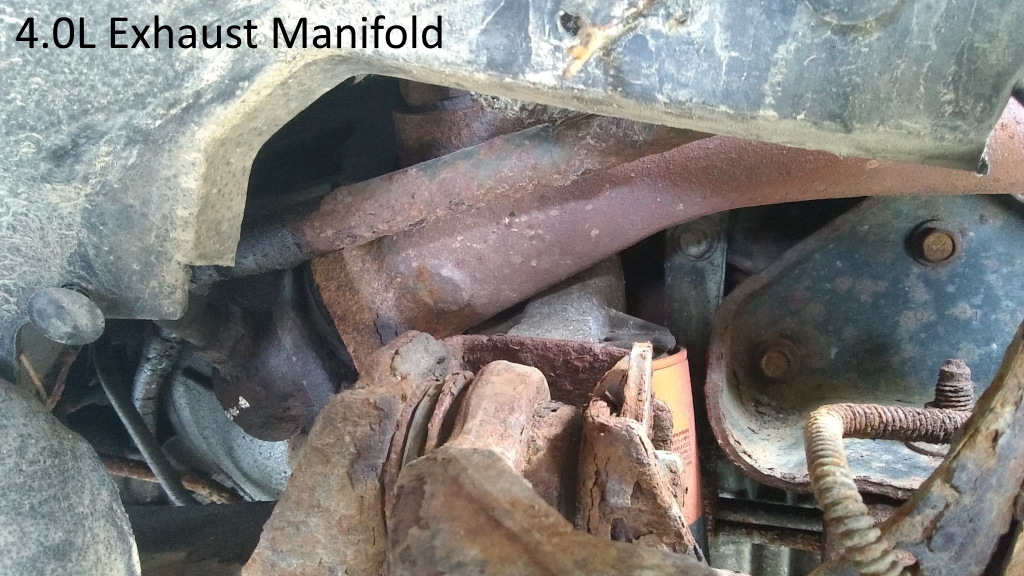

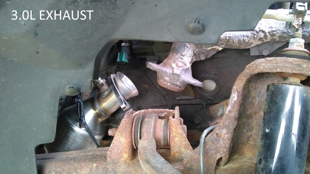

I was wondering if anyone knows if the stock passenger side exhaust manifold from a 2002 4.0L will bolt onto a 2000 3.0L?
It's a long story, but the short of it is, I've got a Y/crossover-pipe/catalytic converter that seems to be for a 4.0L motor, but the Ranger I've got is a 3.0L. These are advertised fitting 3.0L or the 4.0L all over Amazon and E-Bay, but apparently, not....
The existing 3.0L right side exhaust dumps almost straight down ultimately, and the 4.0 is more sloping. In the attached pic, you can see the new x-over pipe, and why I think the 4.0L manifold MAY work, if it bolts onto the head.
Thanks in advance.

...but, the exhaust manifolds are plainly different between the two. The one on my 3.0L dumps down earlier and more vertically than the 4.0 manifolds, as seen in the pictures above.
Every manifold being sold, new and used, for 3.0L looks to be just like the one on my Ranger. Some I see for the earlier Rangers w/2.9L look similar to what I need, similar to the 4.0 pic above.
Did the manifold change in 2001? The callout for what I have seems to be 97(98?)-2000. Is the a difference in manifolds for Gas vs FlexFuel, or EPA vs CA emissions? Is mine a 1/2 year model with some changes cut in before the end of the last model year before changes?? I could not find ANY source for a 2001-up RIGHT-side 3.0L manifold to even look at the pictures on line.
