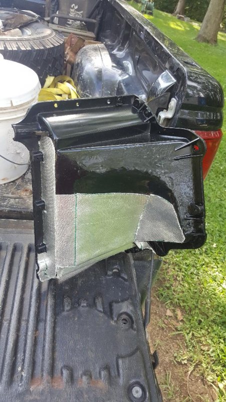

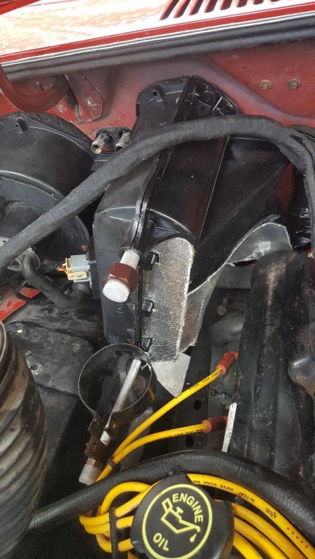

The stuff I used is still expensive, but it has worked well for me for quite a while now. It's not nearly as thick as the OEM insulation. but it's also not as tempting for mice to chew on. The layers I put on my heat-only plenum when I did my V8 swap is still stuck on the plenum quite well. I'm just adding A/C now so I had to modify another plenum.
Heat barrier
It's woven fiberglass sheet, with adhesive and a foil covering..
