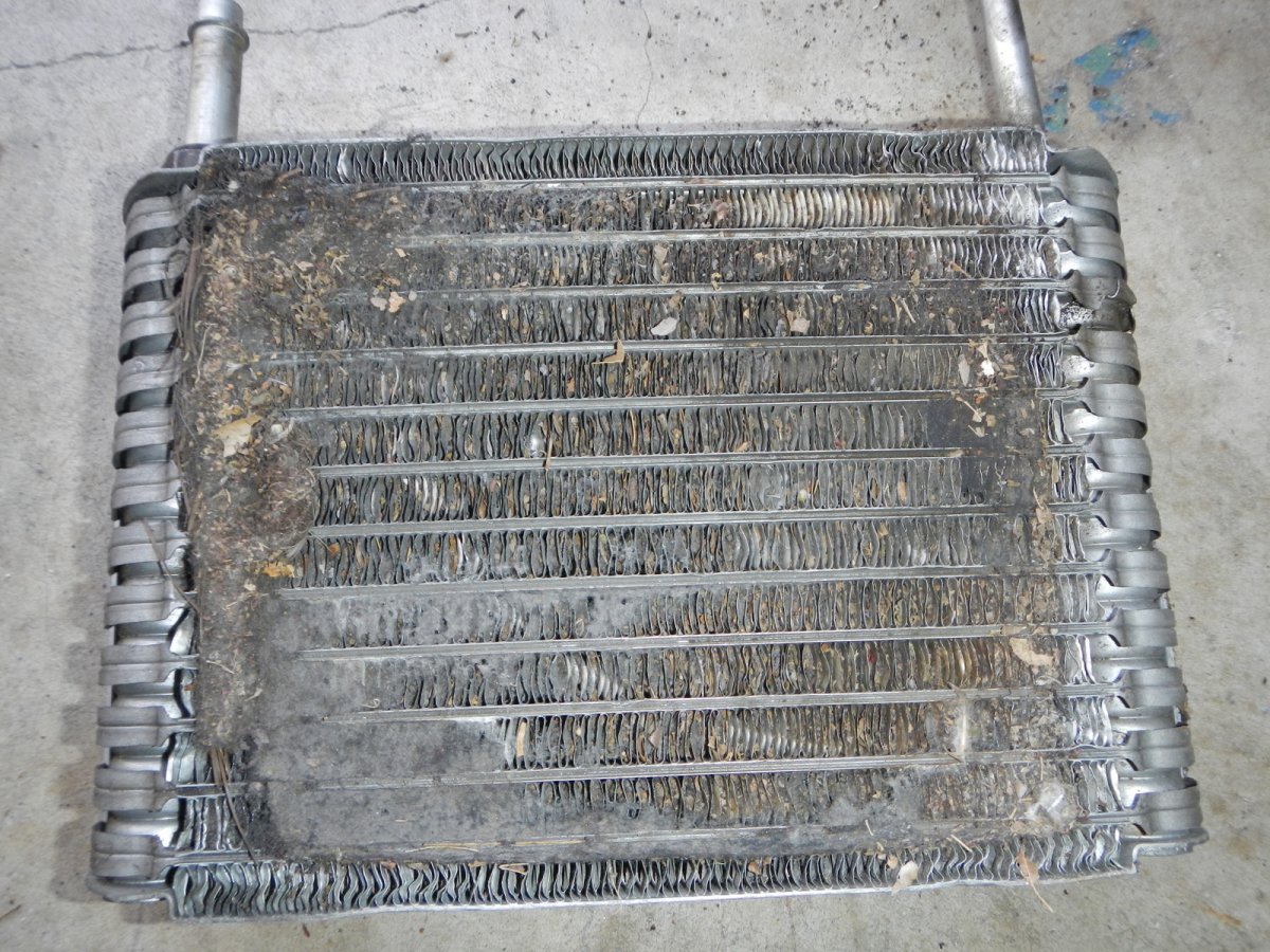

Ya think I might get some better airflow out of the new one???
Holy shite, I had no idea that one was so NASTY!!!!

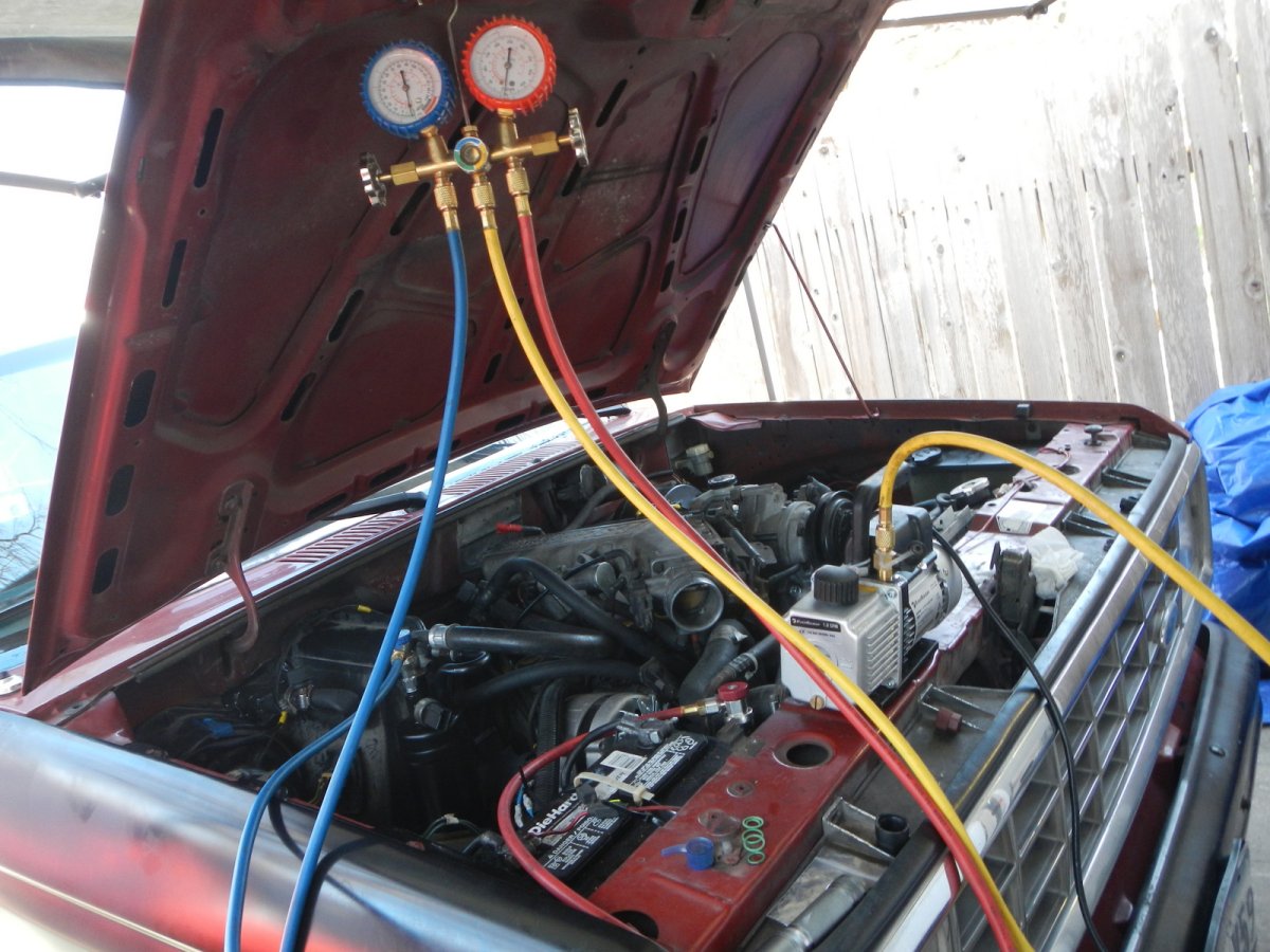

OK..... all plumbed up! Suck, baby, SUCK!!!
Ran vac an hour and a half-ish, added a can of PAG 46 charge, then the kool juice, then she got to working fill and then....... BOOOOOM!!!
MASSIVELY better airflow and fabulously chilly air!! WINNING!!!
From looks of it, you have made several mice families homeless. Shame on you! :)
Yeah, but I also agree about new parts for old vehicles. That evap will be sent to Carlisle Auto Air here for a refurb. They rock! I also saved the copper heater core, as the new aluminum one seems mighty flimsy.
