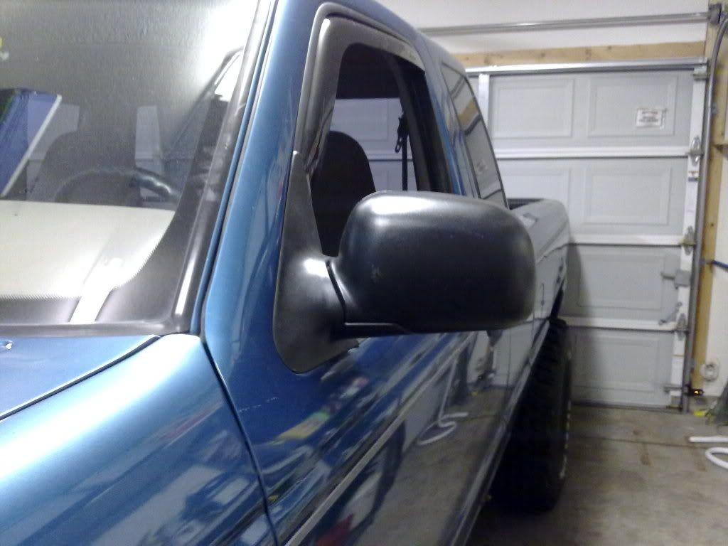

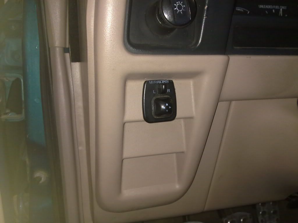

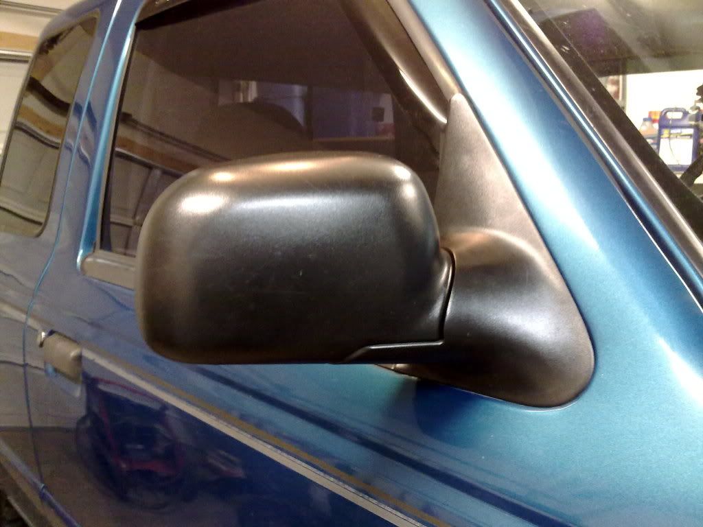

Worked on it some today. Got the power mirrors on and working. Thanks legoms013, they look nice.
