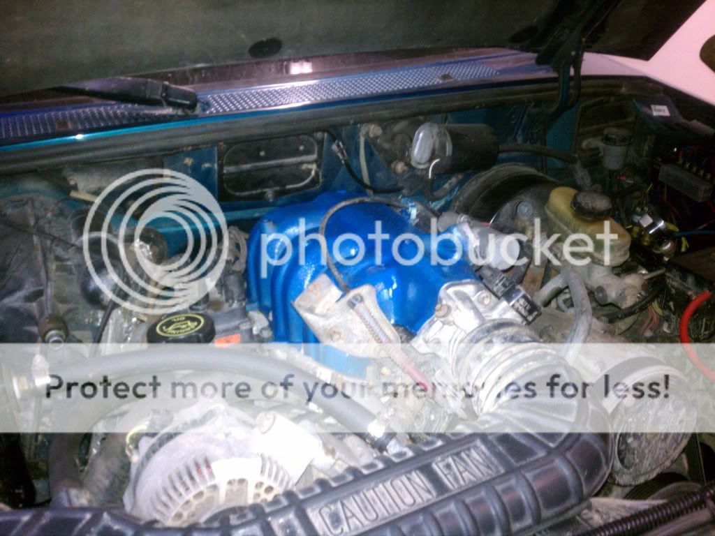

Started to change the valve cover gaskets. What a pain. Too much stuff on top of the motor to move.

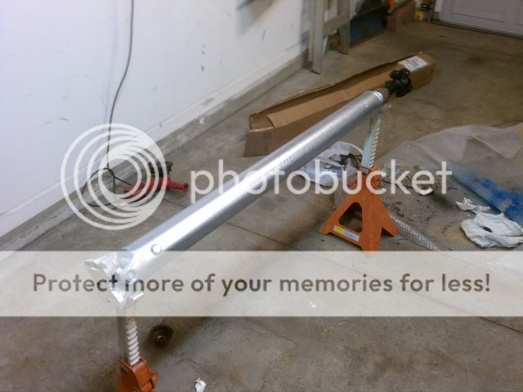

UPS just dropped this off.
Escorts 2nd SAS
Sent from my HTC EVO using Tapatalk
That driveline has rubbed on the skid plate at some point in its life. I suspect it came from a lifted Ranger :icon_twisted:
That's looks like a spot where a factory sticker was. It came from a sport trac.

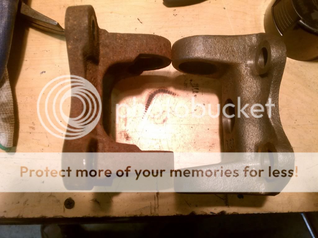

Driveshaft has new u-joints and fresh paint. The valve cover gaskets are done. A fairly productive day.
I have no clue how to change ujoints myself so I have to bring stuff like to shops but need to see how to do it for my ujoint axles for my D30.
Cool thing is with the sport trac driveshaft is it has 1330 u-joints. So I upgraded from the 1310 in the aluminum one to 1330. Cool!

Since I had the engine apart to change the valve cover gaskets I decided to paint the intake with some old leftover paint.
Escorts 2nd SAS
Escorts 2nd SAS
