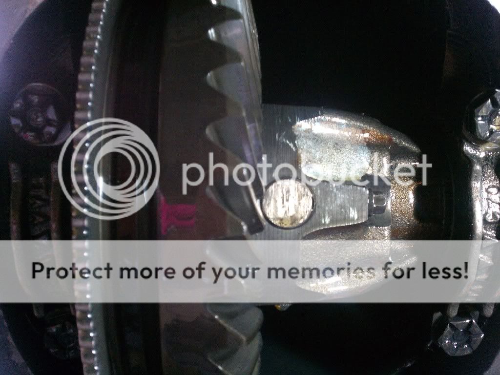

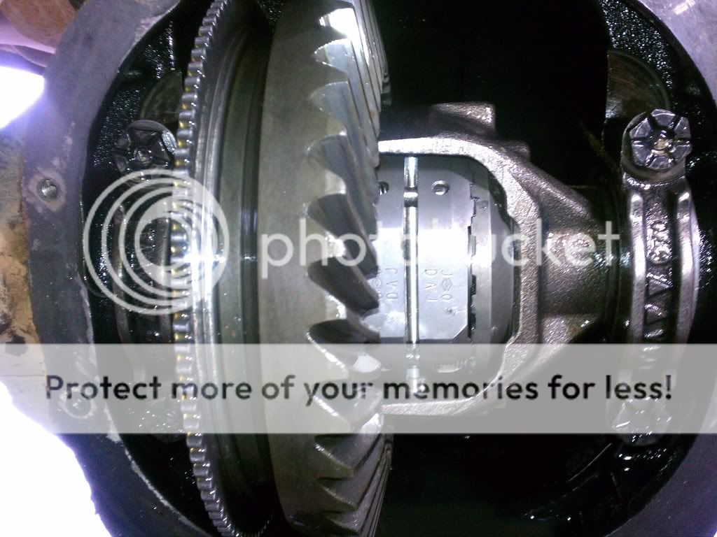

I waited a few days for a cross pin that I ordered...and, it already had one. I've done so many gear changes that I forgot what I had in mine. So anyway I don't need this cross pin. Lol
And if you notice the pic above, the shaft will clear the ring gear without any grinding. Thanks to Motive's performance series the ring gear is not as thick as other 4.56's. Makes it nice.
Sent from my HTC EVO using Tapatalk
it was very minimal grinding to make my cross pin fit in... no biggie IMO.
but looks good! i love my 4.56's! and a locker is always nice!
