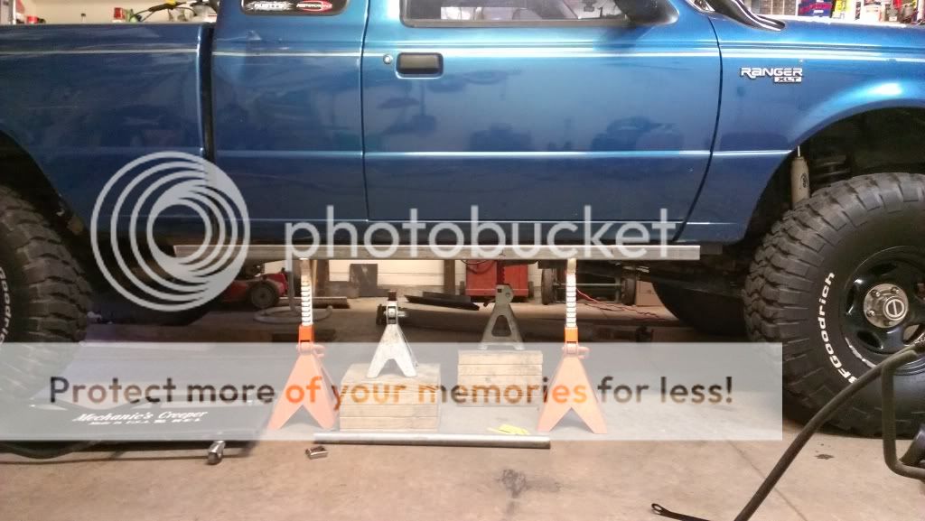

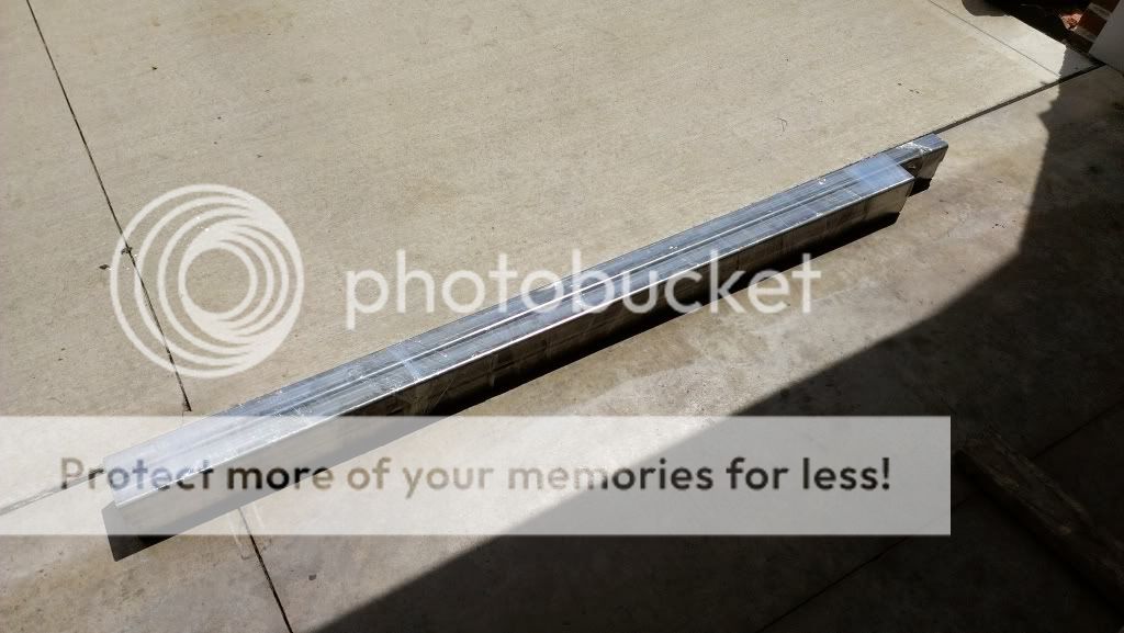

Picked up some 2x2x1/8 square tube and some 4x3/16 plate.

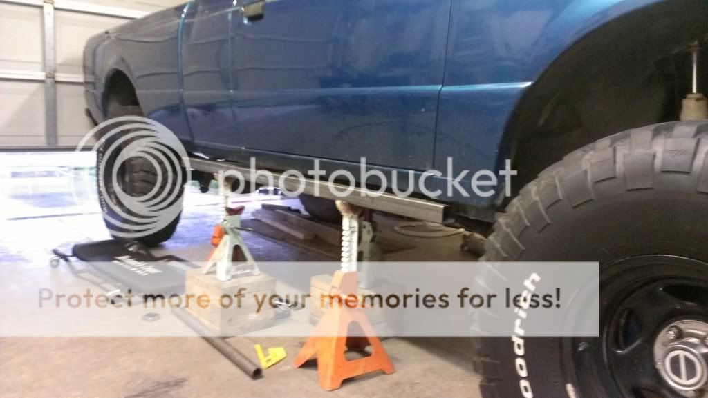

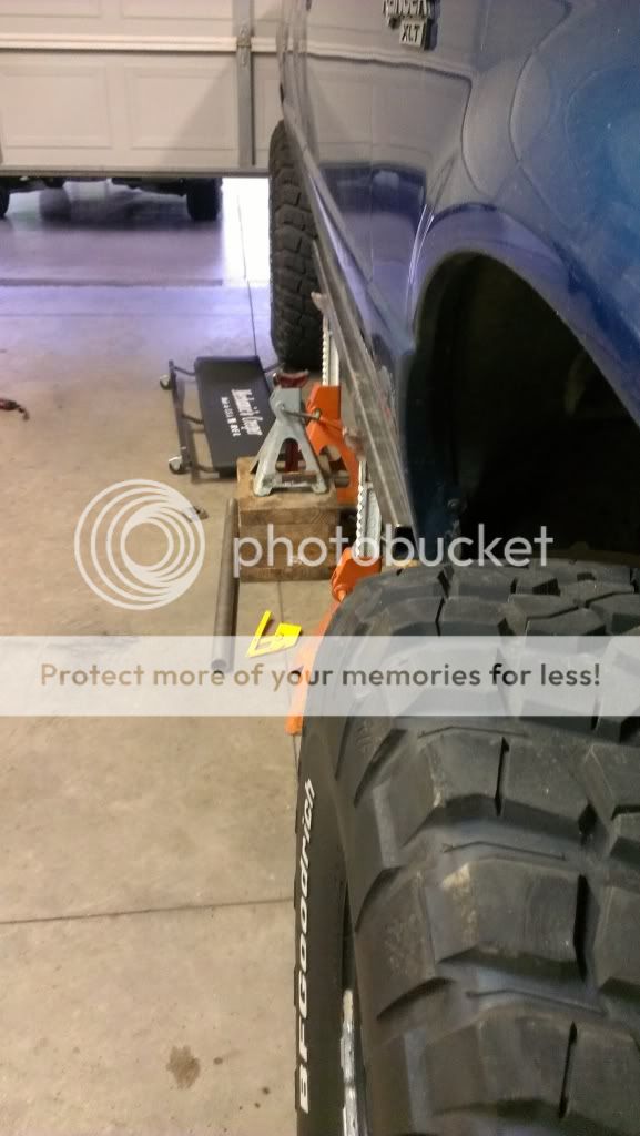

Here is how I laid them out. 3/4" below the rocker panels, and it will be 1/2 above the bottom side of the frame rails. And then I want to add some 1.5x.120 CREW tubing to the outside, to make a step...sort of.
The tube will be spaced 3" from the main slider. This is just a scrap piece for mockup.

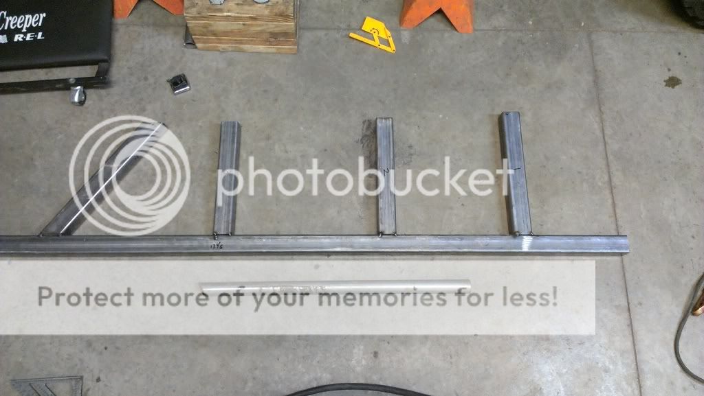

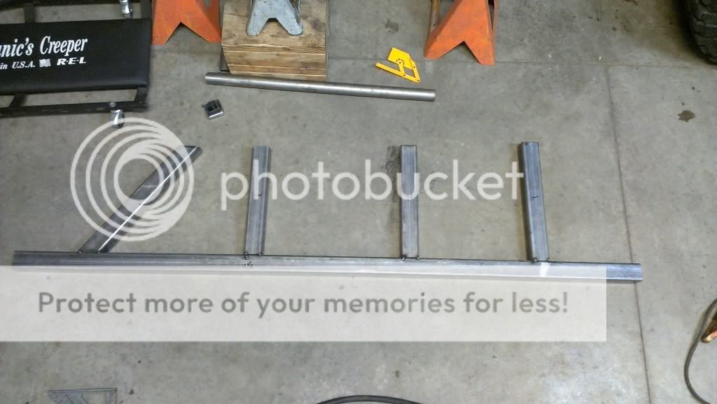

I made some L shaped brackets that will be bolted to the frame. I will finish the passenger side tomorrow after I get some fasteners and the tubing.
