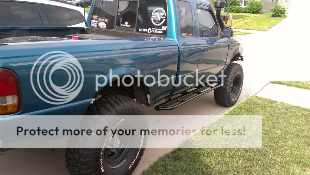

Started the day by getting some more materials for the sliders(toob and fasteners). Welded some of the pass side slider, went to pick up my son from school. Then stopped at my parents to wire the lights for the trailer I built him. Then when I went to leave there, the starter took a crap. Been having problems with the positive wire going to the starter. It works loose every couple months. Came home, finished welding the pass side slider, took starter out to tighten up the solenoid. Then started on making the driver side.
I am really considering welding the driver side to the frame.

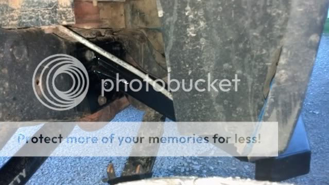

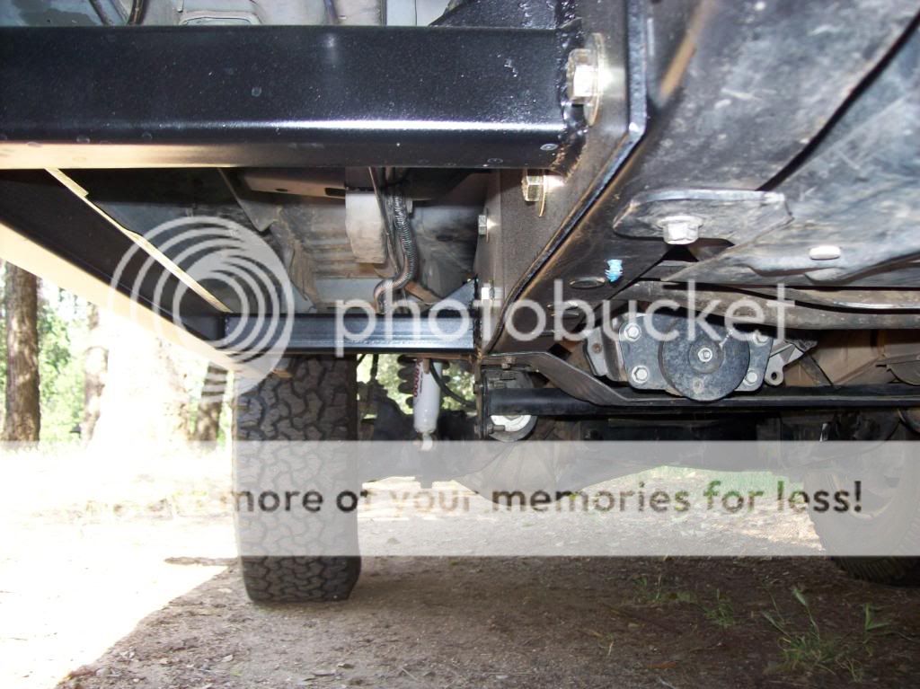

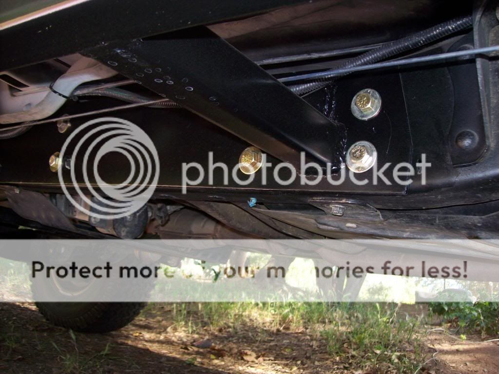

I bolted my drivers side. Just have to weld a long pc of flat bar to one of the nuts to get it in there. Welding is risky with the heat

The other issue you may run into is the location of your rear mounts. If you ever decide to go 64" rear springs your mounts will need to move for the hanger to be relocated I imagine.
With the springs I have I was able to run my rear slider mount at an angle over the spring. The bolts are excusable by just loosening the tank straps.

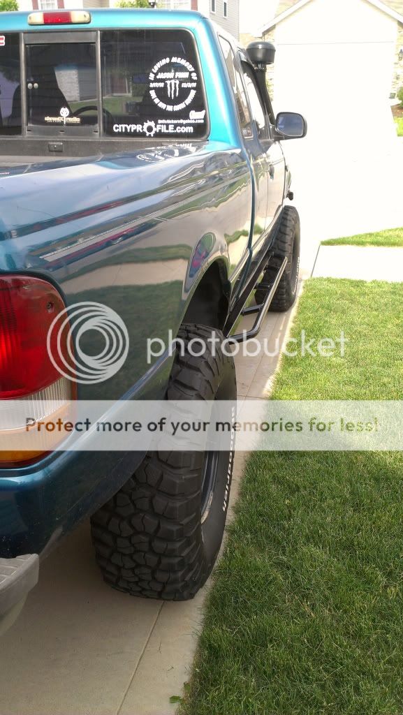

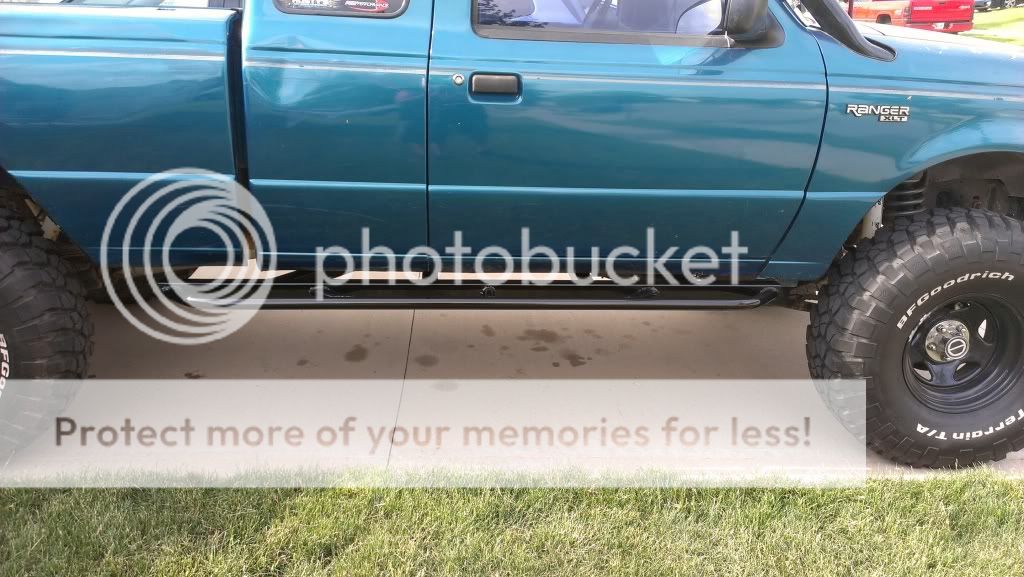

Here is the pass side, but you get the idea.
Sent from my DROID RAZR using Tapatalk 2

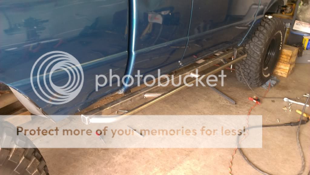

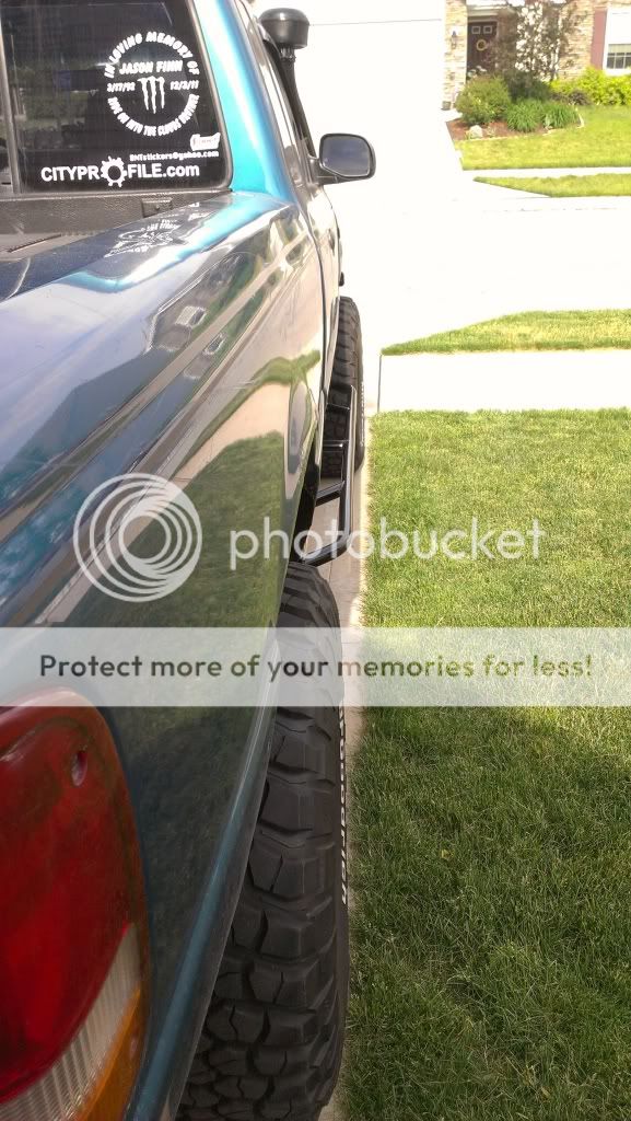

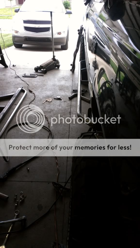

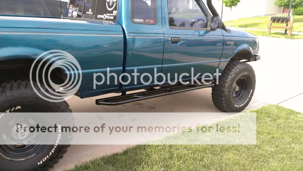

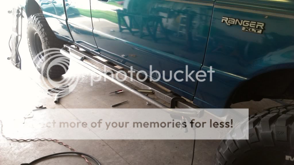

Passenger side is done, and the driver side is all welded together but needs mounted to the frame.
Ready to bend some toob
:icon_welder:
Dont have any pics of how I mounted it to the frame yet, will post them up later.
Hope to have the driver side welded to the frame tomorrow morning before I go into work at noon, or tomorrow night after work.
Stay tuned

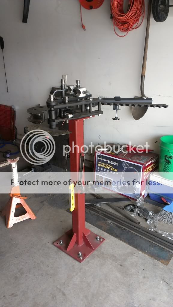

they look good man. i need to invest in one of those benders, my harbor freight POS sucks
